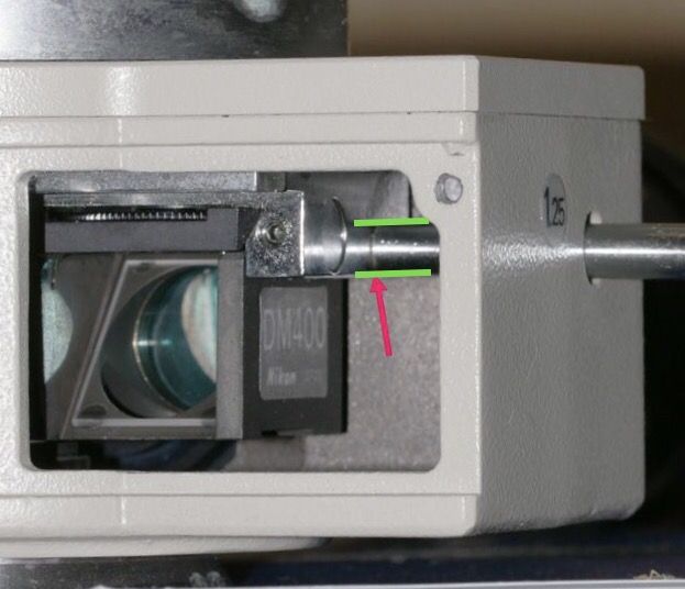

      Another vote for the drill and tapped brass rod with a long grub screw to provide the thread. That way when it is broken you only have to replace the screw in 5 minutes. You could drill and tap the body and put a little line of spare screws in there.
      Good idea abouthe sleeve by MG.
      #392892
      Chris R 1
        @chrisr1
        Not sure where you mean a sleeve.
        There's no space between the surface which has a circular depression in it, and the inside of the end which has the 1.25 sticker on it. Maybe 1mm – enough for a washer is about all. Maybe there was a washer or washer pair once, but there isn't much thread…
        On looking closer

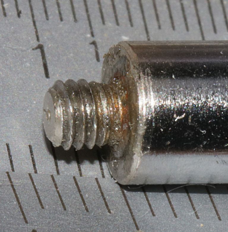

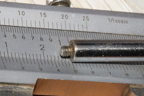

        Tell you what, I've had an idea – why don't I drill and tap and cut off an HT screw and…..nerd
        By the way if you think that threaded bit looks bent, you're right, it is.

          A thin tube fixed onto the actuating rod and a sliding fit on the stub on the cube … it only needs to bridge the gap.
          Your pictures demonstrate my point nicely.

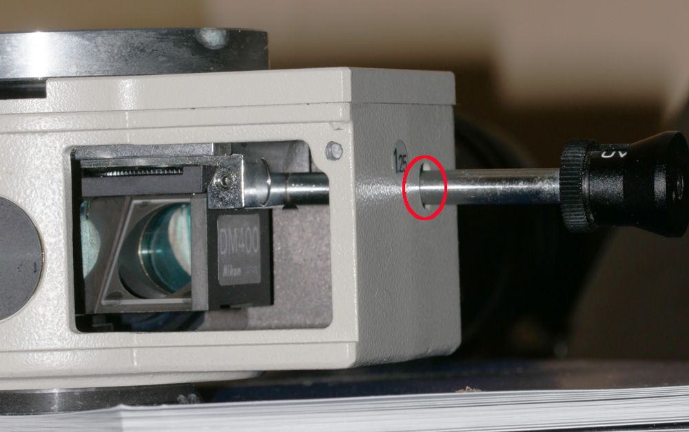

              Looking at the photo, I'd try fitting a brass bush to the hole in the case (ringed in red below). The rod would be a loose sliding fit through the bush. The thread probably breaks because the operator moves the rod sideways whilst turning the knob. Fitting a bush would minimise any sideways forces reaching the screw-end of the rod.

                  Making a bush for the 6 mm rod would help reduce the bending moment. I wouldn’t bother though, I would turn down a larger rod to a sliding fit in the hole then drill and tap the end 3 mm. A 3 mm high tensile grub screw or bolt loctited in would be better than a turned thread.

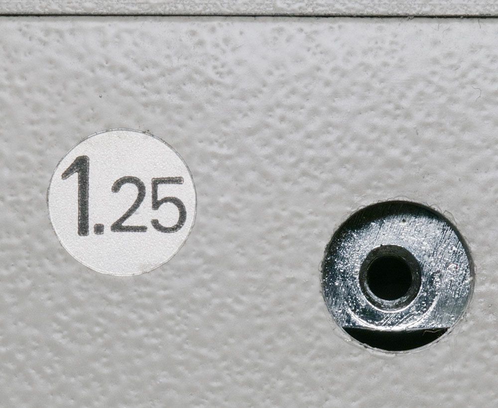

                    Errm, the m3 ole in the cube holder isn't concentric with the ole in the red circle. (The cube holder runs along a dovetail track – which needs some light grease, where can I get something suitable? Not silicone – it wanders everywhere,)

                        The clearance hole is in the casting … How sure are you that it's coaxial with the pushrod ?

                                Ole is 8.1mm ish
                                When the rod is screwed in, hard up to its shoulder, it doesn't run true with its position in the hole, as you slide the cube.
                                Rod is steel, btw.

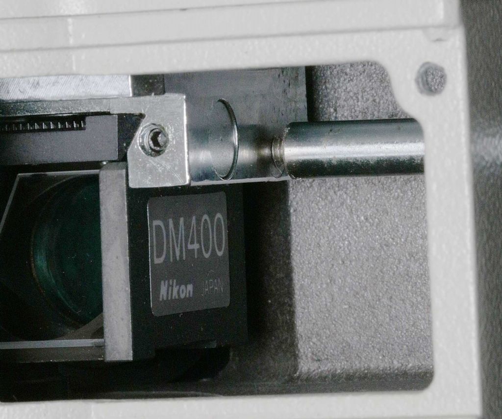

                                  I see why it looked like there was stub – it was a reflection. Here it is unscrewed a bit.

                                    As I understand this it's an alignment problem rather than the rod being weak. If so, maybe the solution isn't to make the thread stronger, but to make the rod a bit bendy. I'd try drilling/tapping my favourite grubscrew into the end of a bit of nylon and see if that lasted better.

                                        As Nikon aren't noted for bad design, perhaps this is an assembly defect?
                                        Could it be that the rod breaks because it isn't being screwed firmly flat against the prism? Perhaps the thread is too long and bottoms out preventing full insertion? Or the rod's shoulders are rounded such that the end can't sit flat? Or a washer is missing?
                                        If the rod isn't screwed hard in, any bending stress will concentrate on the thin part which is further weakened by having a thread cut into it. In a tight assembly of the same parts I think the bending stress would be taken by the thick rod instead. Perhaps it's essential the rod is torqued in hard so as to pull the whole assembly firmly together with no tendency to rock?
                                        I wonder if the design is analogous to the way rivets work. The strength of a riveted joint depends more on the friction between the two plates as pulled together by tight rivets than it does on the side shear strength of the rivets alone. Red hot rivets make especially strong joints because of the enormous force generated as the metal shrinks during cooling.

                                          Posted by Chris R 1 on 25/01/2019 12:39:09:
                                          Thanks, Chris … That makes it clear yes
                                          Simon Williams makes an excellent point … definitely worth a try.
                                          A quick&dirty 'proof of concept' would be to fit a 3mm screw into a short length of nylon tube.

                                                I don't think there's a manufacturing defect, it works the way it's designed to.
                                                There may be a washer – or perhaps one flat oand one spring washer – missing, but there's precious little thread to put them on as you can see from the close-up.
                                                IF the shiny part into which the rod is screwed happens to be parallel to the outside of the box (there's no reason why it should be, with any precision) then I guess I could recentre the hole in the box, drill and tap it maybe 10mm and make a bush, for each rod (there's one each side).
                                                But if that shiny surface is angled then the rod wouldn't stay in the centre of any hole, so things would bend inside when the rod is pulled/pushed. Can't have that.
                                                My foot of 303 has arrived so I'll go that way for now. A slight annoyance is that the rod is not quite straight. Perhaps silver steel would have been ground, I don't know?

                                                      Roll it along a flat surface with a bright light behind to find where the bend is, then nip it in a vice with the bend at the edge and treat it to some light abuse with a soft faced hammer. You can get it pretty good if you're patient. Did the same with my motorbike front forks once, although we used a flypress and vee blocks
