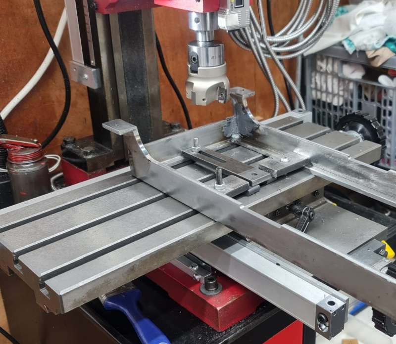

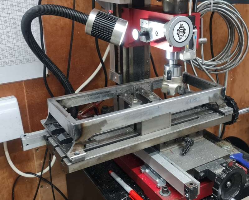

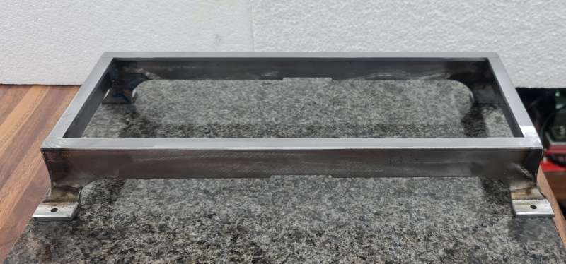

        To provide an update on my (very slow) progress on this part of the clock. I took the advice to find a local welder who MIG welded the parts for me. My wife’s reaction to my  plan to buy a MiG welder or large propane torch was the  most convincing argument!!
        The frame is finally “finished”, there is a fair amount of cosmetics to do, but its square, level and all in one piece.
        Finished frame
        The frame overall is very tight to deal with on my little mill. However with judicious clamping I was (almost) able to machine the top face in one go
        Machining Top Face
        The feet were however too far apart for the travel  and throat of the mill, so they had to be dealt with in pairs.
        Machining Feet
