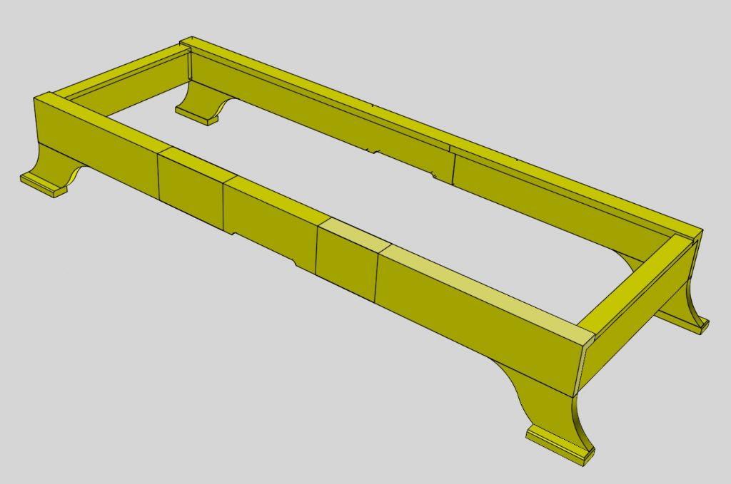

      I am going to need to silver solder some pieces of 30mm x 30mm x 5mm mild steel angle to create a frame for my clock project but have (as yet) no silver soldering equipment or experience.
      Can anyone with experience suggest what size (Kw) nozzle or torch output I am likely to need to be successful. Is the (probably 900w) MAP type torch from Toolstation going to be sufficient. I suspect I don't need a big (7Kw) Sievert, but what sort of size in between would experienced users recommend?

                                          Thanks again, I will have a rethink. I have never tried to fabricate parts on this scale before. The thing I am trying to make looks like this (ignore the vertical lines on the faces the are artifacts of the way it was constructed in the modelling tool – three separate trains). It's about 350mm long and 140mm wide. The sides are 30mm deep, and I plan to cut one side of the 30 x 30 x 5 angle down to 12 mm for the top faces.
                                          The real thing is one single lump of cast iron about 5ft by 2ft and 3/4" thick but creating a pattern and getting it cast is a big step too far in my learning. I visualised shaping the four main sides and silver soldering the corners, the feet can be made out of the same angle and attached in the same way.
                                          The discussion of welding in the thread has helped. Any weld fillets could (would?) be inside the frame and hence invisible.
                                          So, thanks again the help around here is terrific. I will investigate the possibility of getting it welded.

                                                I may have missed the point here (not difficult nowadays) but would it not be easier to construct this from steel stock angle? I see that 32 x 32 x 6mm is available as a stock size and as the OP is intending to reduce one side anyway, it would not be that onerous to reduce 2 sides and I really don't think the additional 1mm thickness would show that much on what is really just a decorative feature. Just a thought.

                                                  30 x 30 x 5 is a stock metric size so no need to trim the vertical leg to 30mm just the horizontal one as it's not a stock unequal angle

                                                    Posted by Peter Cook 6 on 22/10/2022 11:55:00:
