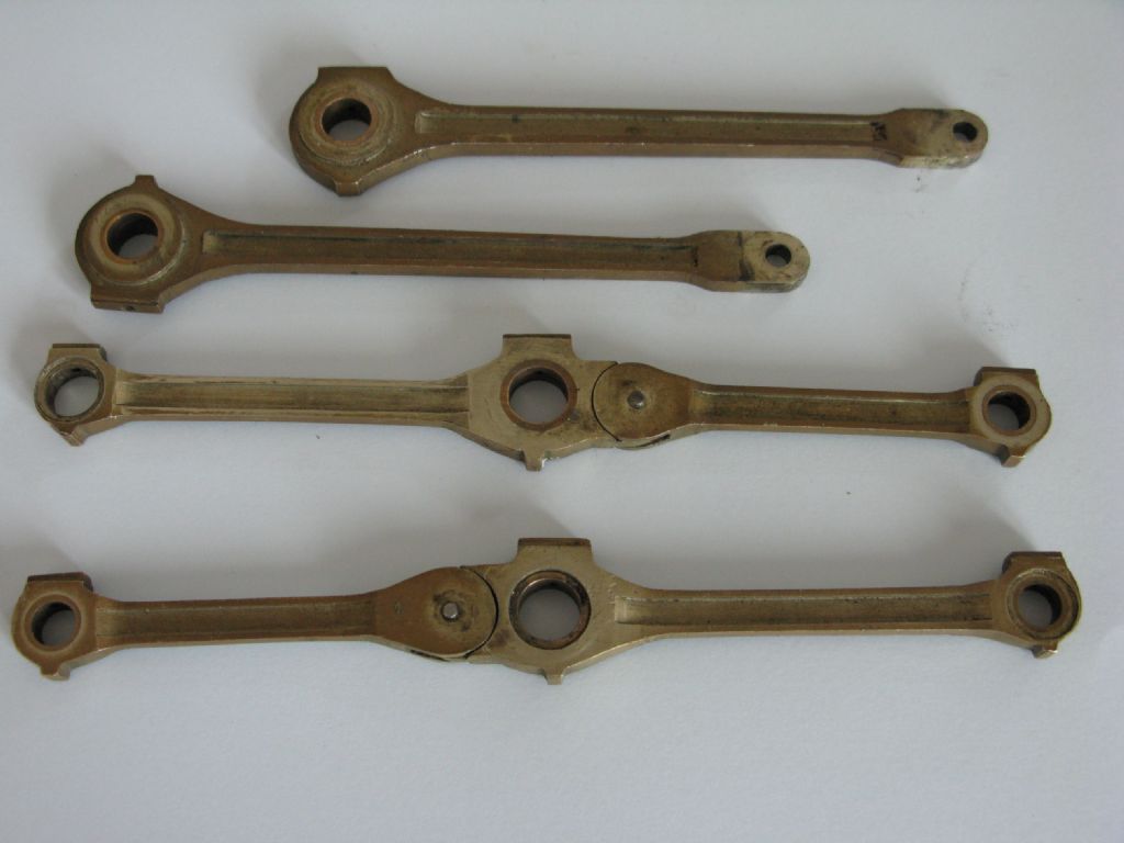

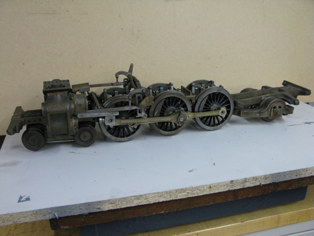

      President washingtonI have had a part finished 2 1/2" gauge Baltimore and Ohio pacific locomotive chassis for some time awaiting it's turn for some TLC. This was a design of the late 20's by Mr H.J.Coventry, with castings supplied in the UK by George Kennion, there are many casting used in it's construction, even the main loco frames are cast gunmetal.The original work was carried out very nicely, but as so often happens the parts fell into less careful hands, and in attempting to make the coupling rods fit with the wheel quartering all over the place, our hapless mechanic has filed out one of the coupling rod bosses which has then cracked, presumably as he tried to force the wheels round.
      The coupling and connecting rods are unusual in that they were supplied as German silver castings, something I had seen in old copies of M.E but never seen before in the flesh. I'd like to preserve this feature, as I feel they are of their time and with some careful filing they could be made to look quite reasonable . I plan to silver solder a bush into the bore of the butchered rod, then bore out to the correct size and the correct axle spacing.
      Reason for the post is, has anyone any experience of silver soldering old cast German (or Nickel) silver. I'm quite experienced at silver soldering, but have no knowledge of 80 ish year old cast German silver. I have silver soldered Nickel silver fabrications but never castings. I know their is a wealth of experience out there, so any tips or pointers would be most gratefully receivedPresident Rods
      I have hopefully attached a couple of pictures of the rods and one of the chassis in as found condition, the cracked boss is the left hand one on the second set up.. Incidentally the loco came with an unconnected Basset Lowke tender, which has just been positively identified as being the original to Henry Greenly's Challenger locomotive from the battle of the boilers. Happily it's off to be reunited with Challenger after nearly 80 years apart.

                  Thanks Keith and Michael, I managed to get out in the workshop this morning and make a bush to silver solder in, I'm pleased to say it all went very well, I took Keith's advice and did not try to complete the job quickly, or heat too fiercely.
                  I used some thin wire silver solder I keep for steam fittings, It's not cadmium free but it does flow very nicely. I cleaned everything carefully and pickled it before I started and used standard easy flow flux. I did attempt a picture but it didn't really show anything up worth looking at, if I get close enough to show the joint it just gets blurry! Must get a decent camera!
                  One bonus is the nickel silver is about the same colour as silver solder so the crack repair is almost invisible.
