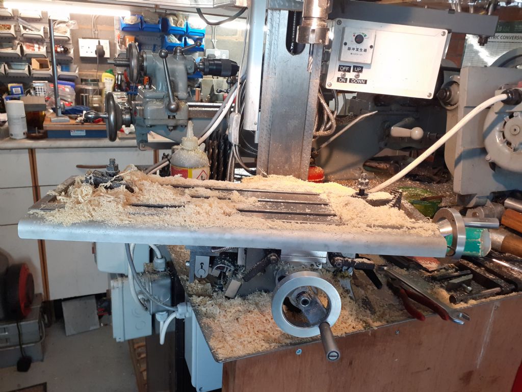

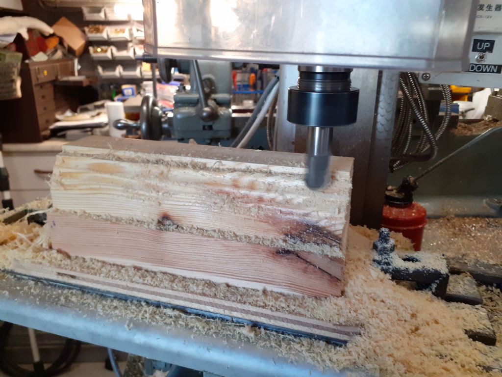

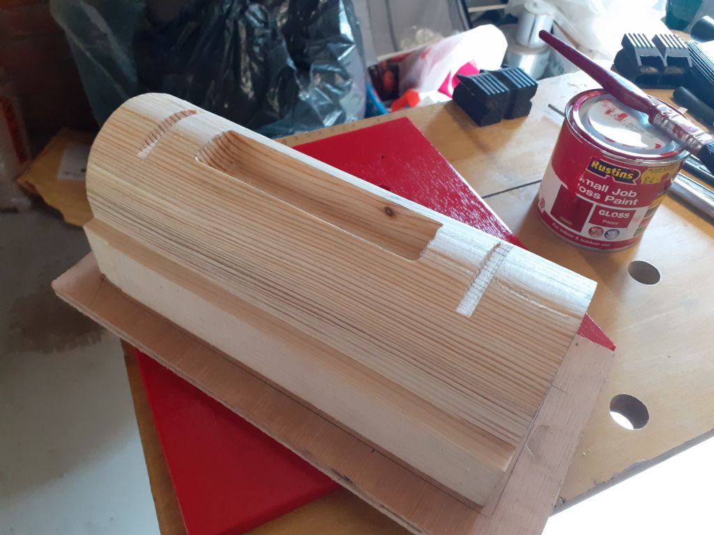

        I made a jig pattern to bend and hold the heat shield brass plate. I made it in wood so I can clamp the brass plate, when it gets here, and bend it round and drill and flange for brackets.
        I drew the radius on the end and used a ball nosed cutter to shape the curve small step by small step then rip off small cusps with sand paper. The groove in the centre is to clear the centre bushes and the brass will be bent down to fit the boiler. It did make a bit of a mess which took about an hour to clean up.

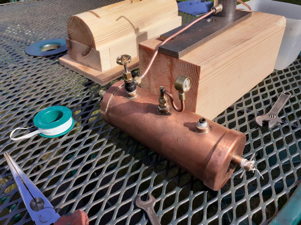

          Decided to pressure test the boiler. As I didn't have a pressure pump I had to make something and with a piece of 1 1/2 mild steel drilled and reamed a 1/2 bore and cut a 3mm o ring groove to make a seal for a dowell for a plunger. Then I drilled a cross hole 4mm though and tapped them 8mm about 10mm deep. I then made two non return valves from a piece of brass two 5mm balls and a couple of springs one suck and seal, one pressure and seal, just make sure the spring is on the right side. I Soldered a couple of pipes into the non return valves one with a connection to boiler and a suction pipe to pick up water.
          When I conected the pump to the boiler which I had pre filled with water the pump worked great and found a couple of leaks one on the level plug which needed a new washer as the copper one I made didn't seal but a bit of PTFE fixed that for now and the seal on the fitting which holds the pressure gauge had a slight leak at pressure a bit of solid locktited thread seal fixed that.
          The boiler was ok in itself and holds pressure up to 60 PSI that is as far as the gauge goes. I replaced the grub screw with the safety valve and tested it and it released at about 20 PSI I hope that is enough to run the little wobbler.

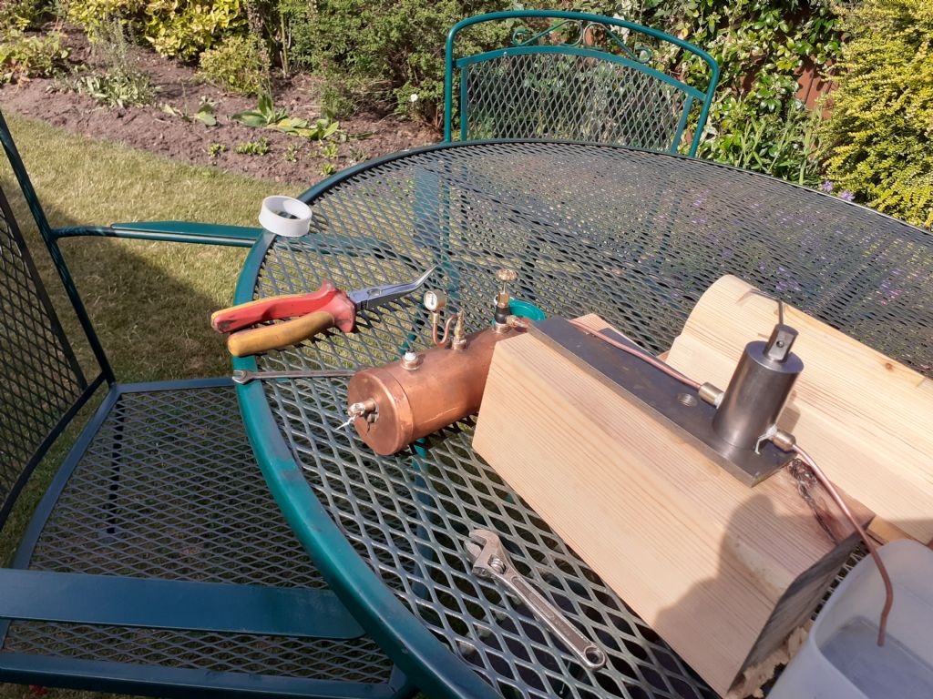

            I couldn't wait to try out boiler evan though I was still waiting for the brass plate for top cover.
