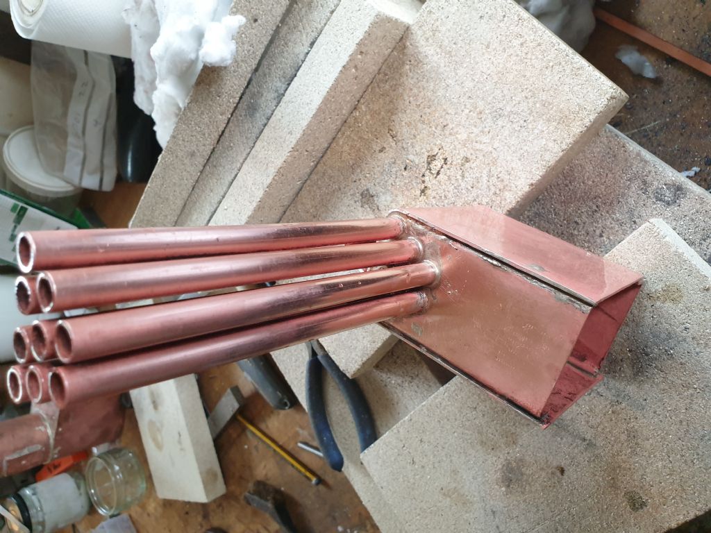

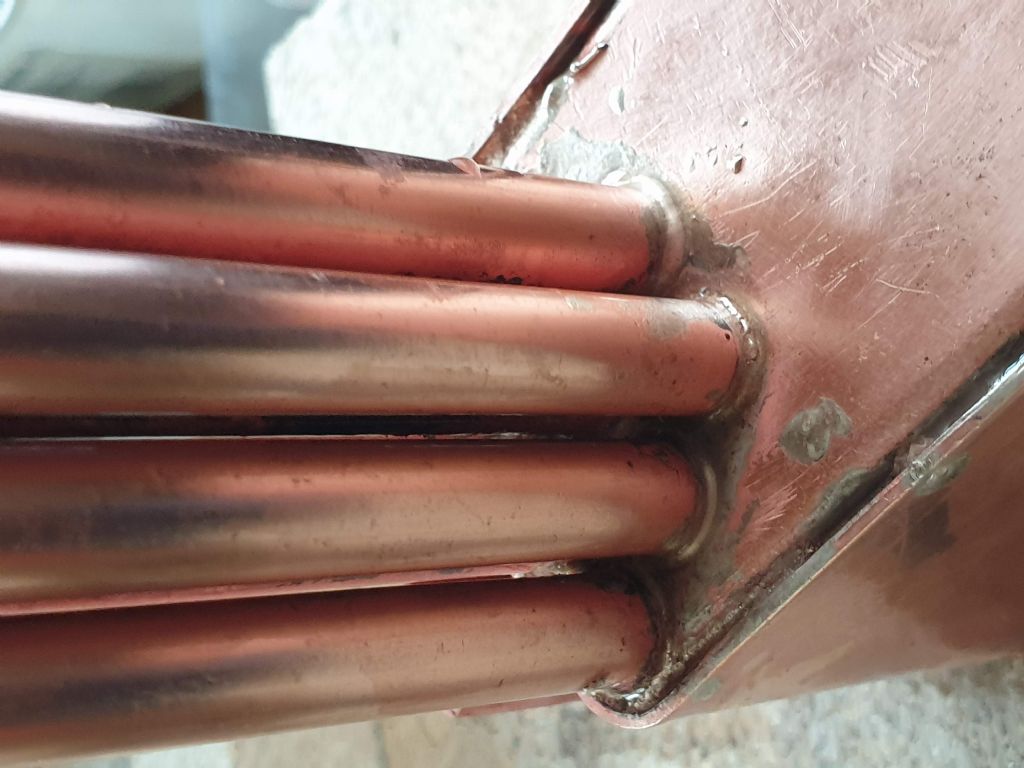

                      A little more progress, this time with the addition of the firebox crown stays and some boiler tubes. It was a bit fiddly aligning the boiler tubes.

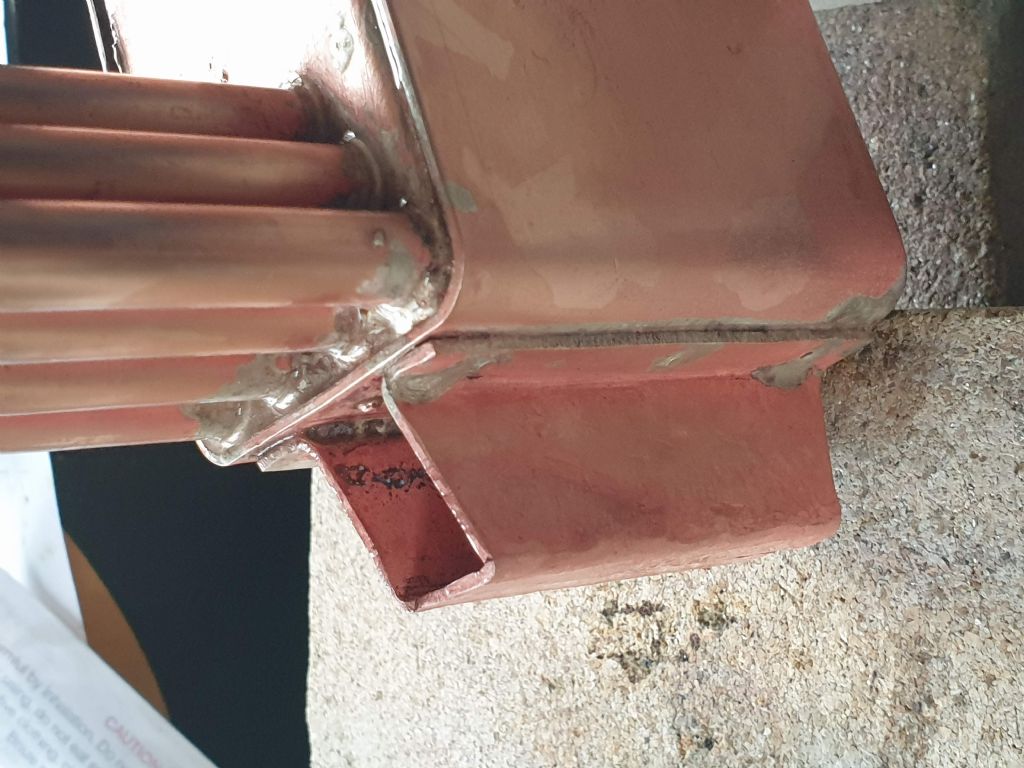

                        Looks good Mark! well done. May need a bit more silver solder on the firebox wrapper as seen in middle picture, looks like a small void. May not be an issue but just mentioning it as I noticed it. Could be the wrapper to flange gap was a bit too wide just there.

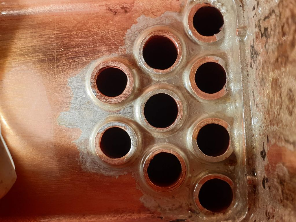

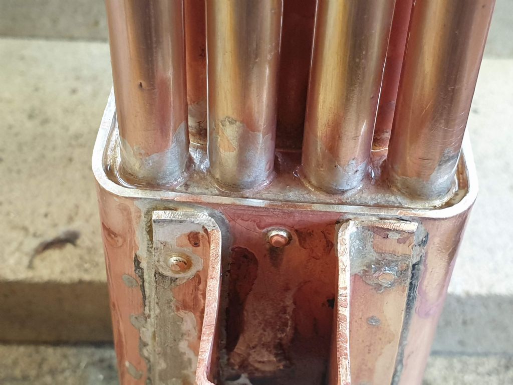

                          Mark, well done but some words of caution from someone who does this for a living.The solder hasnt flowed correctly on some of the tube joints, possibley burned out flux or more likely just not enough heat, also the top rivet looks like it hasnt been soldered (might just be the light). Before proceeding with the build I strongly advise you to re-flux the tubes and re-heat until it all flows smoothly. If you have even the slightest problem in this area it is near impossible to correct once fully assembled and soldered and then the whole boiler is scrap. Any lumpy bits of solder indicate potential problems. Picture two shows two perfect joints and two not perfect joints, they all need to look like the smooth ones or they are likely to leak.
                          To answer Bob, you cannot easily compare the process of arc welding to soldering. One relies on a filler metal finding its way into a gap by capiliary action (dont get me started on gaps!) and the other deposits liquid metal onto the surface, gap or no gap. In reality a boiler constructed entirely without any flanging and competently silver soldered would be just as strong as a similatly welded boiler. Flanging originated in the days when boilers were riveted together and then cailked with soft solder plus its difficult to hold a boiler together without any flanging but it has been tried and done by the Australian federation whilst they were investigating this very notion. All their joints passed.

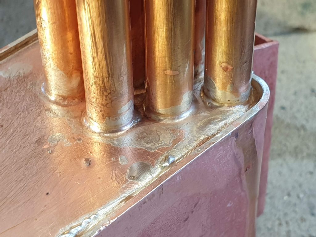

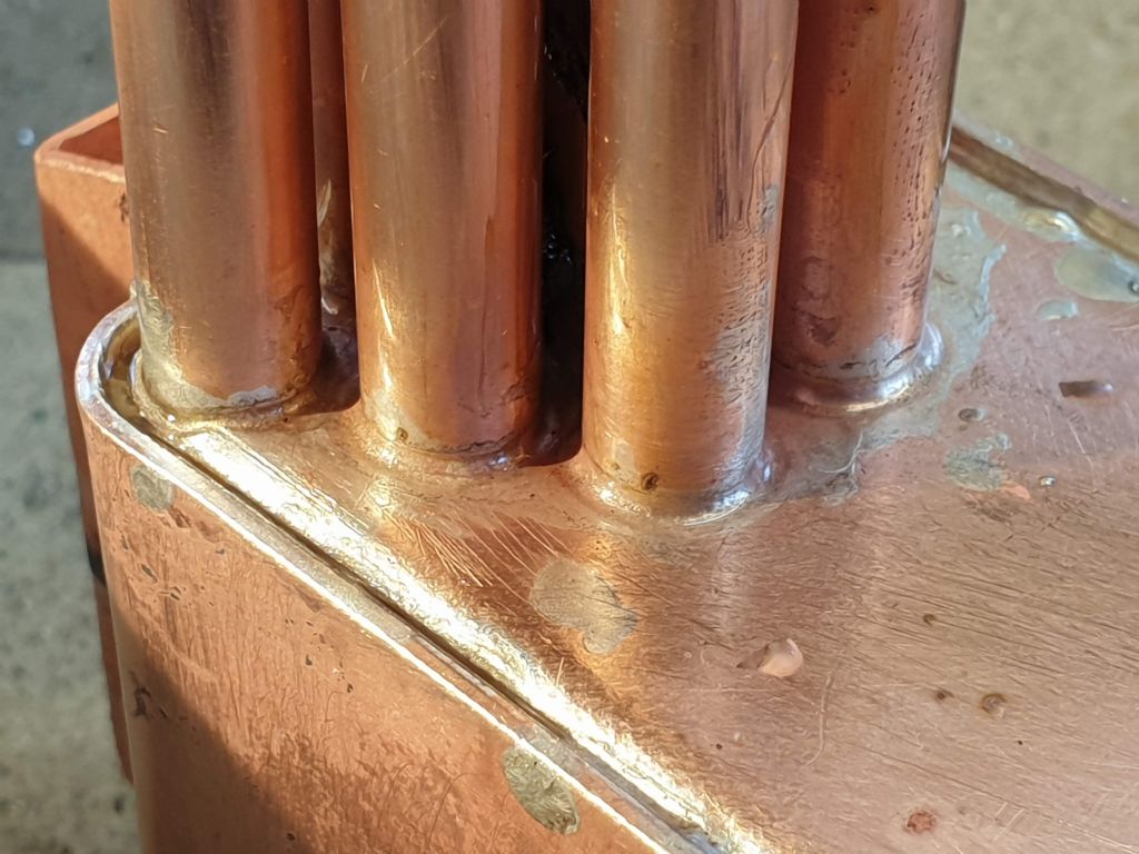

                            I've reinspected the tubes and decided that a refluxing and reheat wouldn't harm. I agree this part would be a challenge to rectify later on. It's going back to the boiler inspector on Wednesday so it will be closely examined then.
                            Reheating again has improved the look of the joints and minor lumpy solder turned unto a puddle. I've also photographed it from the inside which I think looks okay now.

                              Now thats a massive improvment, well done indeed. I almost deleted my words as I thought they would be taken the wrong way but im glad they werent…..the way the solder has run on the inside is a sure indicator that it was at the correct temperature and all should be good.

                                Very nice. I was thinking the same as fizzy but he was braver! I couldn't come up with the right words to post a suggestion! That looks to have flowed very well, your inspector should be very happy with that.
