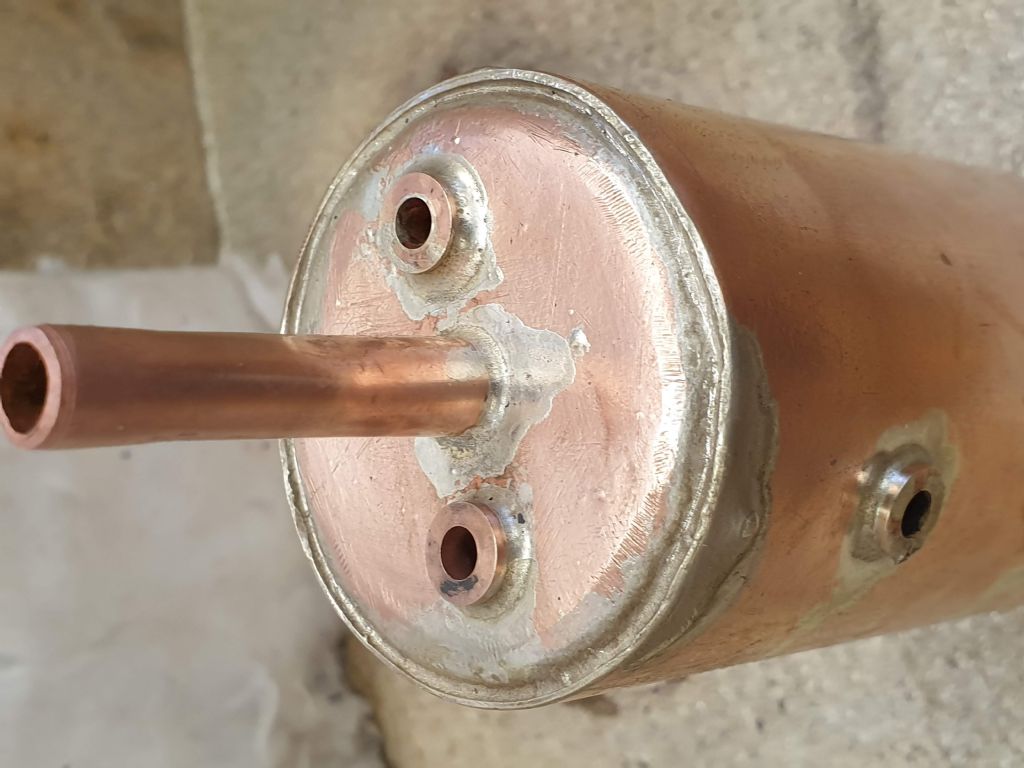

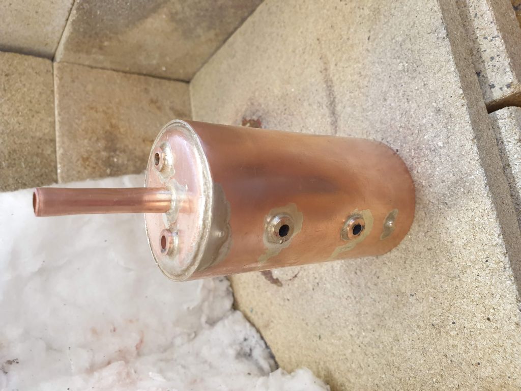

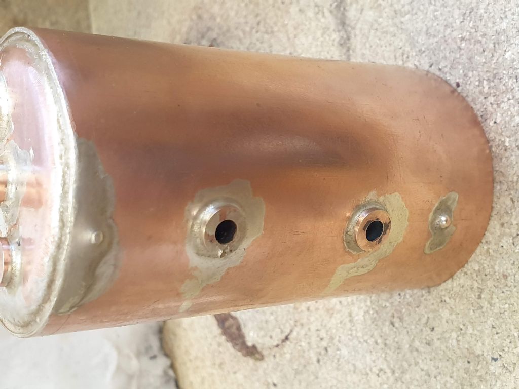

                  I received a delivery from Cup Alloys today. 38% and 55% silver solder.
                  Given my previous hopeless results with 25% I decided to practice by making one of the simple boilers in Stan Bray's book on Simple Model Steam engines. It's a very simple boiler with end plates and a single chimney in the centre.
                  To practice a multi stage soldering operation I soldered the end plates with 38% and the chimney and boiler fittings with 55% afterwards. I was using Tenacity 5 Flux. The operation simply worked – it was very easy!
                  I appreciate I applied too much solder in places, but the flow into the joints was just as I wanted.

                    Your soldering on the small boiler looks good Mark. Smart to get some practice with that, and now you have a nice boiler for powering small model engines. That extra solder can be removed, it is not a big deal. Much better to have a bit extra than not enough. Good luck with the Minnie boiler! Clean things up often while soldering, don't skimp on adding flux if things are not flowing as you want.

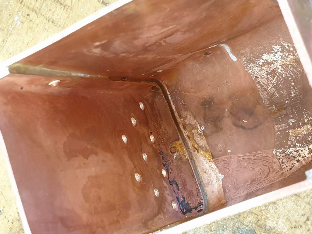

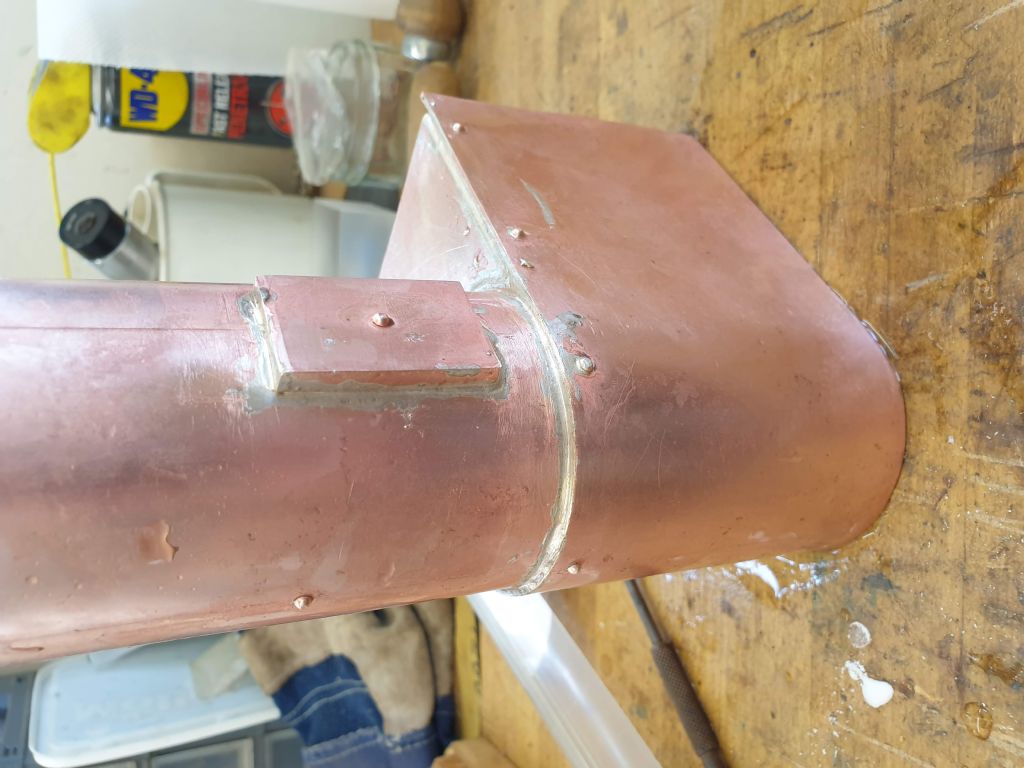

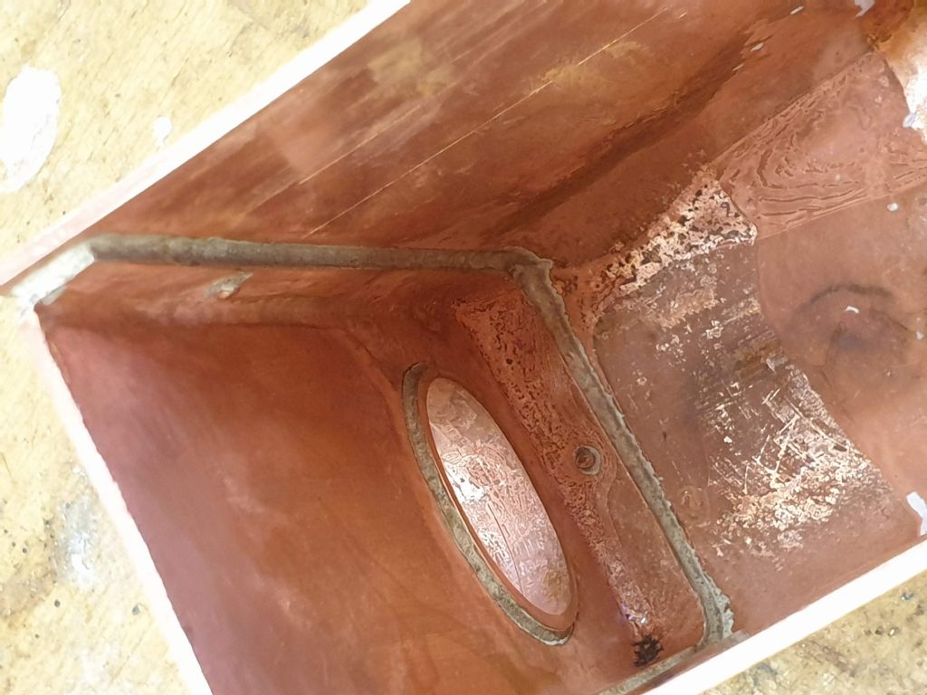

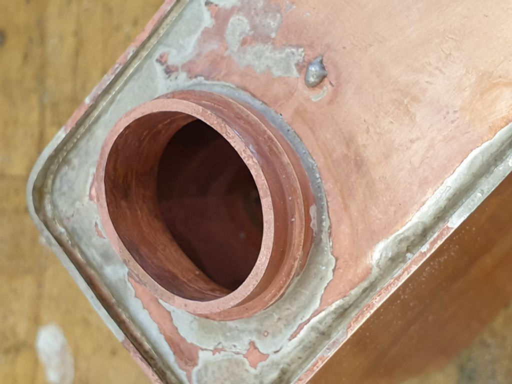

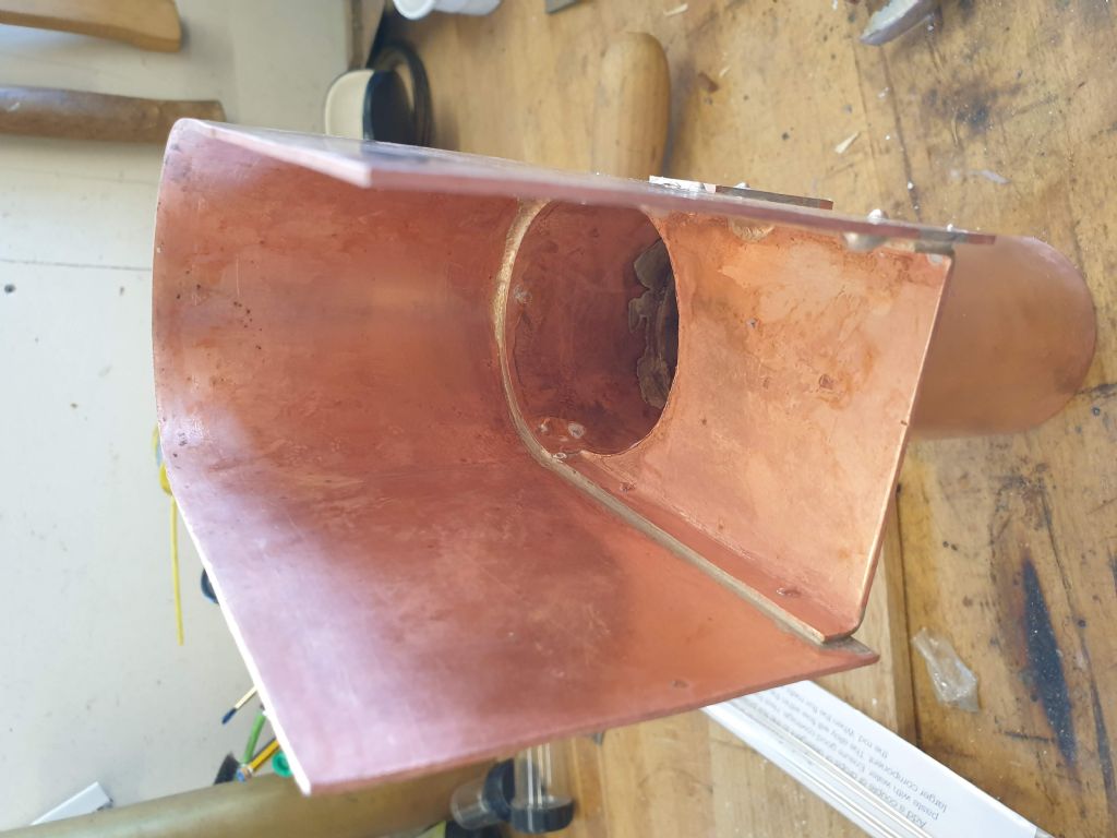

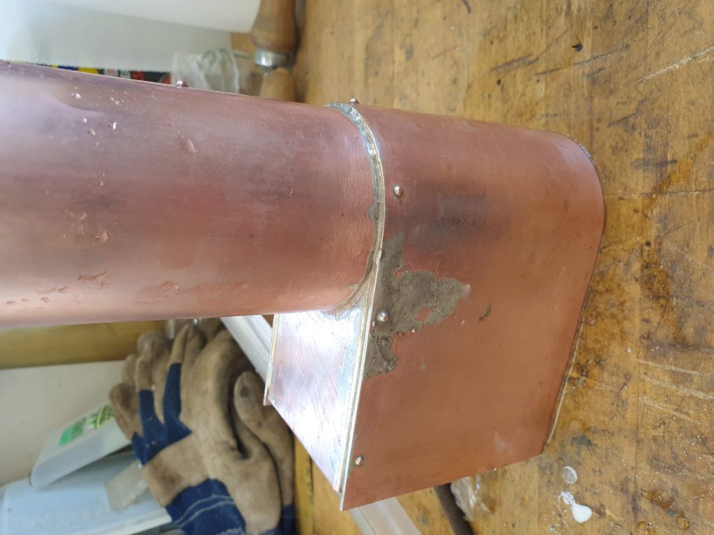

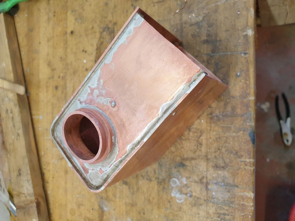

                      I have taken the plunge and starting silver soldering my Minnie 1' boiler.
                      Pictures tell the story which I'm pleased with although its not perfect. Starting with the barrel, wrapper and throat plate:
                      And them moving onto the first stages of the fire box:
                      To me it feels okay so far, but I'm open to comments.
                      I'm not a member of a ME club but aware of getting this inspected properly with the view to getting a boiler certificate. I live in East Lothian where there doesn't appear to be a club but I believe my nearest club is Esk Valley MES . I'm going to hold fire an any further construction until I've heard back from them and what they want to see.

                        That's excellent news Mark and the silver soldering looks really good so you should have no problems with the rest of the build.
                        I agree that you are best to stop now until you can get a boiler inspector to view it but I would not expect you to have any problems with the boiler inspection.
                        There appears to be an Edinburgh Society of Model Engineers, is that more local to you?

                          I hate to criticize something that I have never done, but working my way towards.
                          I actually came across this thread trying to find one I started about boiler soldering.
                          The boiler joint between throat plate and barrel is just a line contact, 1.6mm or so? I really don't think this is good enough, particularly on a traction engine with all the driving stresses pulling that joint apart.
                          I have been working my way through a huge pile of MEs I have just been given. I see that Martin Evans on the Jubilee boiler does talk about using a thick throat plate without flanges, 5mm or 3/16" in that case. There are also a couple of articles by Martin Evans about boilers and strength in the early 60's. Issues 3107 and 3119
                          These are, of course, my opinions, and without ever having soldered up a boiler so with no practical experience. But, I am not going to start soldering any boiler until I know why you get weeps, I think poor fitting between flange and shell so solder can't flow.

                            Bob, the throatplate joint looks to be using a flanged throatplate to the barrel so there will be 1/4" to 5/16" of overlap.

                              It's just a butt joint on the Minnie drawings as mark has done and hundreds of other builders before him

                                I can confirm that the joint between the lower part of the boiler and the throat plate is a butt joint, and this is the design by L C Mason, who feels like a respected model engineer and I hope plenty of approved boilers are made to his design.
                                I do however welcome and respect thoughts on the construction.
