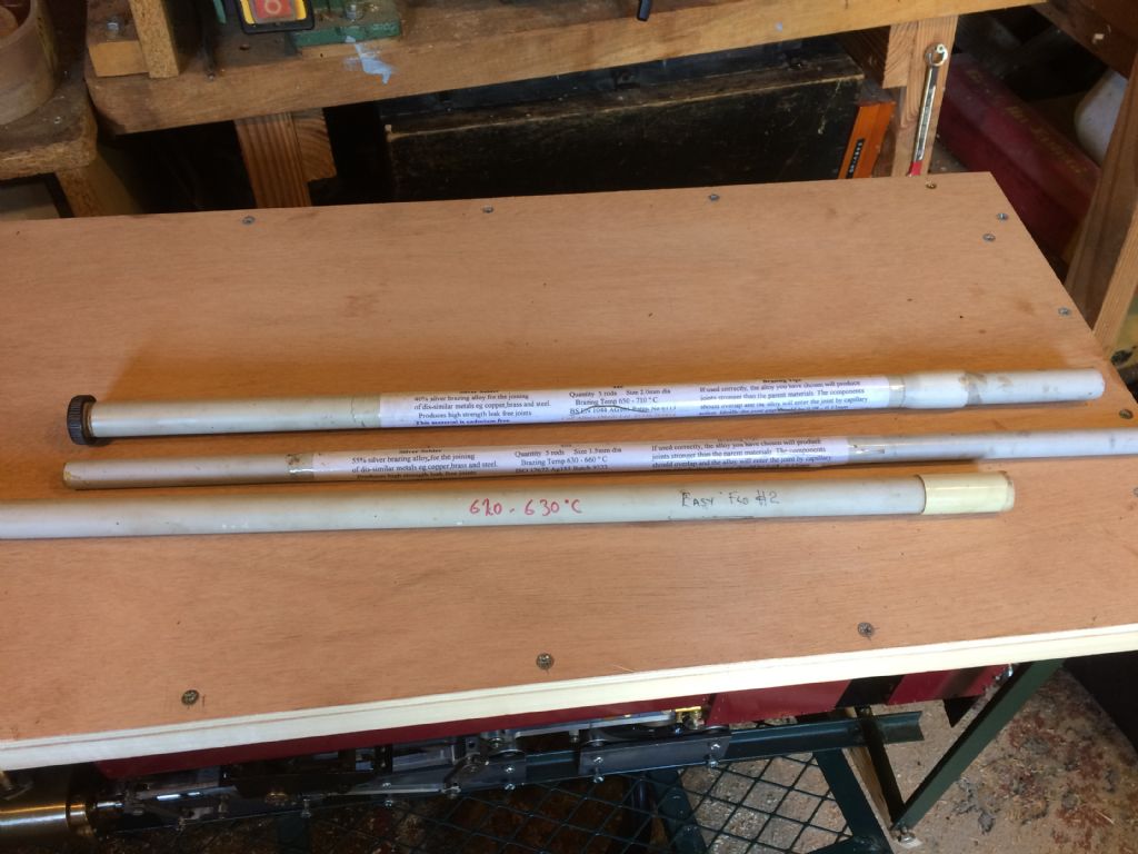

      Handy storage for sticks of silver solder. Cut some plastic rigid tube (Electrical conduit etc). Glue a cork in one end of the tube and and shape a removable cork for the other end. Affix the suppliers label to the tube showing temperature range etc. Have a tube for each different type.

          I do the same with the larger size conduit for my MT reamers, test bars etc.
          Also works for avoiding chips on larger carbide milling cutters
          I use ex- port or whisky corks for the open ends open Morse tapers on lathe, milling machine, rotary table etc.

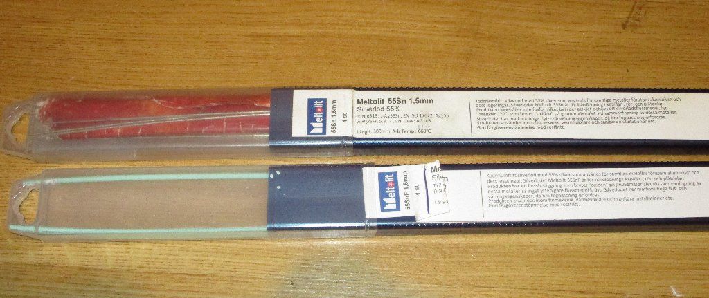

            Good idea, I don't store my silver solder that way as they comes in boxes like this:
            Thor

              I use the conduit system but use a glued conduit end cap at one end for greater security. It is a pain if an unglued end cap ( or cork ) pops off and the whole lot ends up on the floor.
              As conduits are available in a wide range of sizes ( for electricity, telecommunications, water and drainage ) and can be cut to any desired length they can be used to store a wide range of materials.
              Also, if you glue a cap to each end and then cut the tube in half lengthways they can also be used for open storage (in a suitable rack ) for smaller material such as threaded rod and small section tubing. I have seen this idea described before but I am not quite sure when and where.

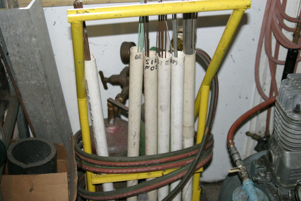

                  I use a similar idea for storage of my gas welding rods, except I have used 1" PVC plumbing pipe with a cap glued on one end, All labled with the type of rod.
