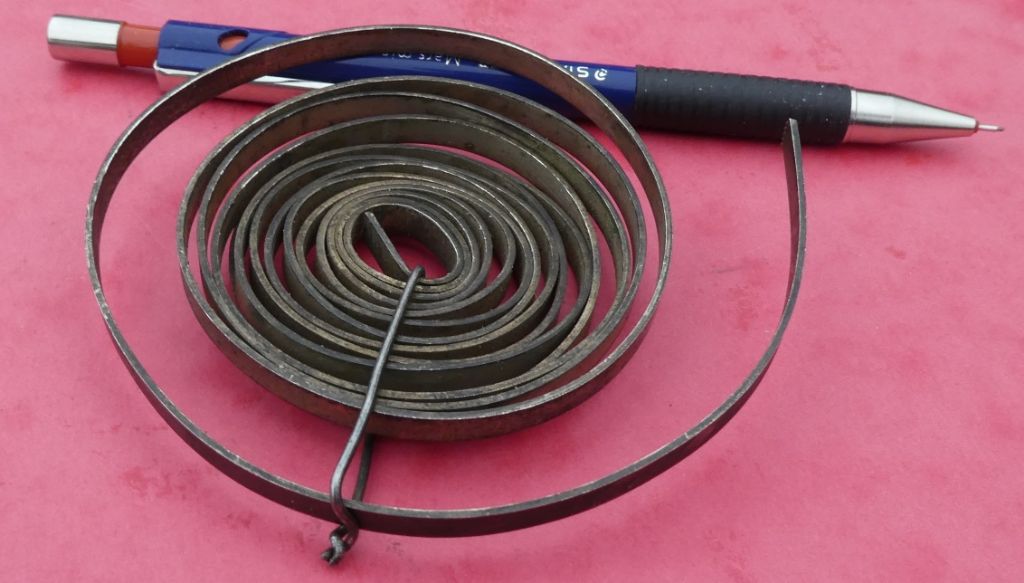

      I was just going through yesterday’s car boot purchases when I found this age blackened coil in amongst an old box (3 quid) containing equally aged brass, copper and PB. Cross section is 5mm wide and 1mm thick and about three ounces total weight. I snipped of a small piece and a brief squirt of my cooks blow torch confirmed my hopes – its silver solder.
      I obviously have no idea what the melting point is but it seems to melt as readily as my known stock of Silver-flo 55 but I can only do the rough comparison particularly as my Silver-flo is only 1mm diameter.
      Without suitable equipment I am unable to more accurately check the melting point. Can anyone come up with a cunning plan?

          Don't know how you might do it, but I would snip off a tiny piece and pop it in our kiln. Could even compare it with the other sample.
          I remember someone who once picked up a new palladium/gold crucible, thinking it was platinum and subjected it to 'loss on ignition' temperature of over 1000 Celsius. That was an expensive mistake!
          Take it to your local college is one option, if you don't have a kiln, and ask for help?

              Hmmm.. a cunning plan? I know my daughter gets the jewelry she makes hallmarked… it can't cost much to get stuff assayed which would at least let you know % silver?? Then really all you need is a guide to whether this is low , med or high melt point if convinced it's likely solder from the assay result. Diameter of your other solder shouldn't have a bearing on comparisons so long as both are side by side on a good fluxed conductor such as copper??

                  This is far from infallible, but the harder grades of silver solder strip are usually the wider ones: **LINK**

                      Hi Rik, i know this as i use Sterling and Britannia silver almost every day in my work. Although i use proper silver soldersmiley which melts between 667 centigrade and 800 centigrade. (usually between 55 -75% silver content)
                      How do you know who put the silver in the same box as brass etc… as it was bought at a boot salewink
                      I was going to suggest putting a small piece next to a similar size piece of aluminium and seeing which melts first..
                      The higher silver content solder usually is stiffer than the lower melting point ones.

                            The stiffness of a piece of silver solder is no reflection on its'composition.
                            A rod directly extrudes to size is softer than one produced by spin-straightening a hard drawn wire!
                            1) Cut a small piece of your strip to a similar size to that you can make from your 1.0mm 55% cadmium free rod.
                            2) Place both pieces on a small sheet/strip of copper and apply flux paste.
                            3) Heat the two pieces eveny from underneath.
                            4) Observe when the two samples melt.
                            My bet is that the unknown material will melt just earlier than the known. It may even spread a little further!
                            My bet is that you have a 42%silver alloy with cadmium. 5 x 1 strip was commonly supplied to shipyards and the automotive industries. One way you could put down metal slowly. Turn it through 90 degrees and you had a thick rod and could put a lot down quickly

                                      Keith – CuP —– I followed your instructions but the Easi-flo 55 melted FIRST. Just to make sure I tried it a second time and still got the same result.
                                      I have now unwound the coil of old solder in the pic and measured the length. If anyone is interested in guessing the length please have a go.
