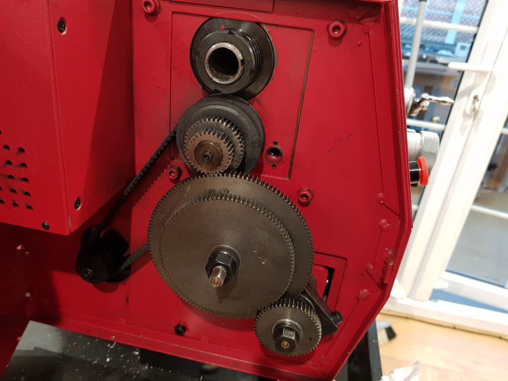

      I need to cut a 20TPI left hand thread with my Sieg SC4 lathe.
      I have the appropriate gears in place and moved "A" to the left so that the lead screw goes in reverse.
      However I am unable to get the AB gears to mesh as the gear to the right of the picture is in the way.
      **LINK**
      Can this be removed, if so how please, or am I missing something!
      This is my first attempt at changing gears and cutting a thread. Maybe not ideal to have to be a left hand one but it has to be.
      Help much appreciated
      Richard

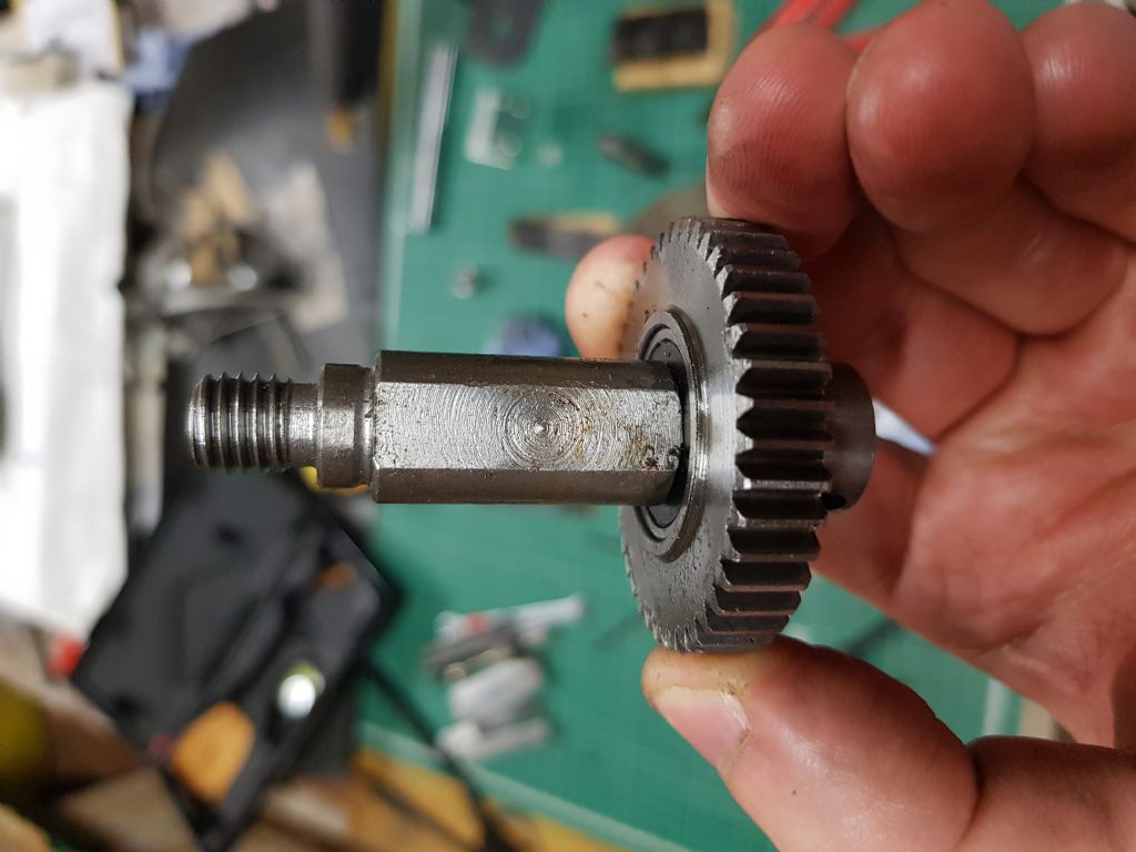

          There should be (at least there is on mine) two flats on the stud so you can unscrew the whole thing. From memory you need a 13mm spanner.

            As well as being able to loosen the studs so they can be slid along the banjo you can also loosen the banjo where it clamps around the lead screw boss which will help with getting the gears to mesh you can see the cap head screw for this far right of picture

              Andrew, that picture is very helpful and almost answers the question. There are 2 small allen screws top and bottom on mine, which I assume lock it in place, presumably these have to come out 1st ?
              thanks for your advise
              Richard

                You don't need to touch those. I think all they do is hold in the threaded block that the above shaft screws into. You can see the back of it if you take the top cover off. Anyway, it's a bit fiddly depending on how long your spanner is because the lead screw can get in the way but the whole assembly simply unscrews.

                        Interesting that Sieg have apparently formed the flat in the first photo in a lathe.
                        #569352
                        Bazyle
                          @bazyle
                          Posted by ega on 31/10/2021 17:06:20:
                          I imagine it is a cnc lathe with powered tooling coming in at the side.
