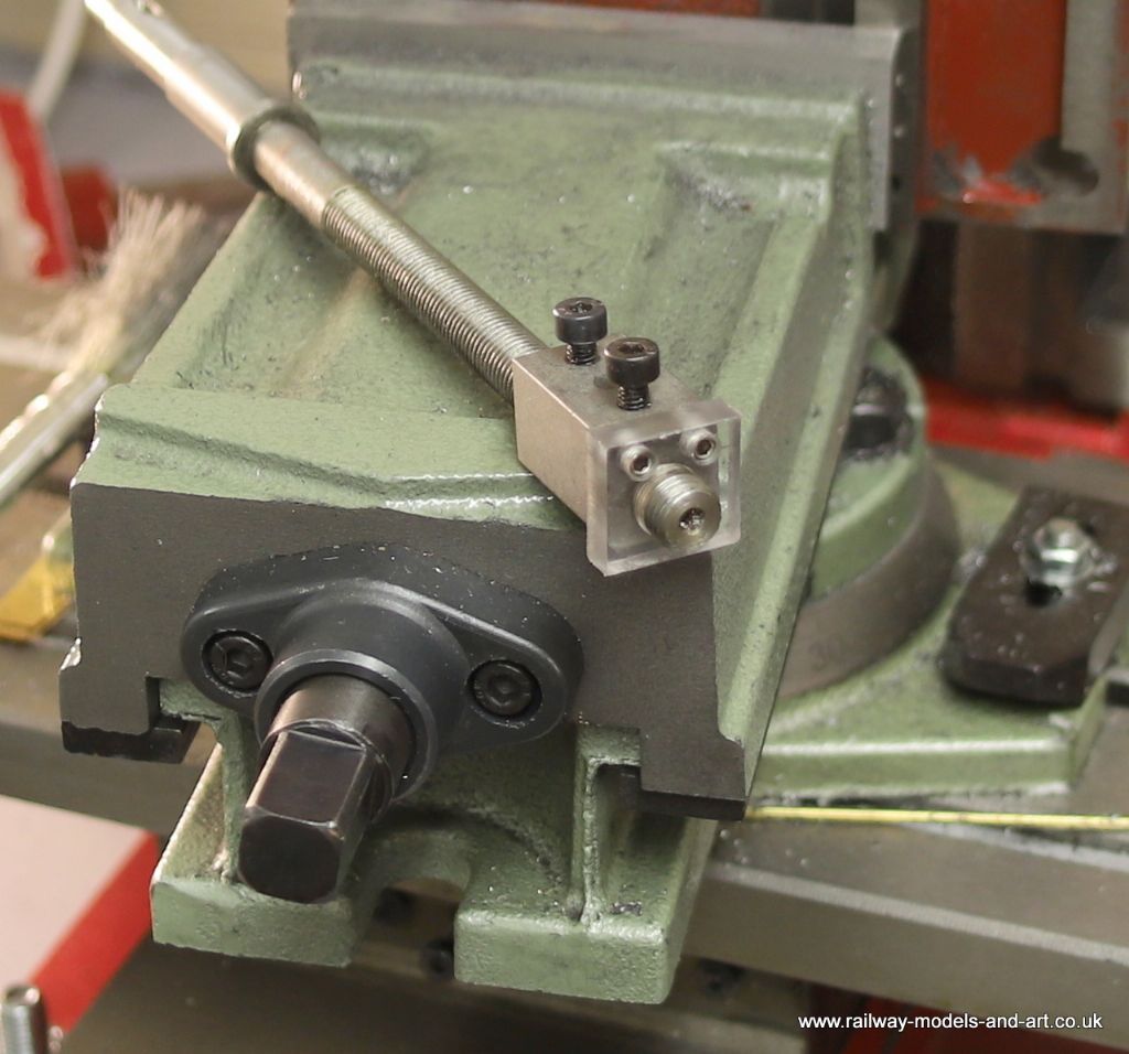

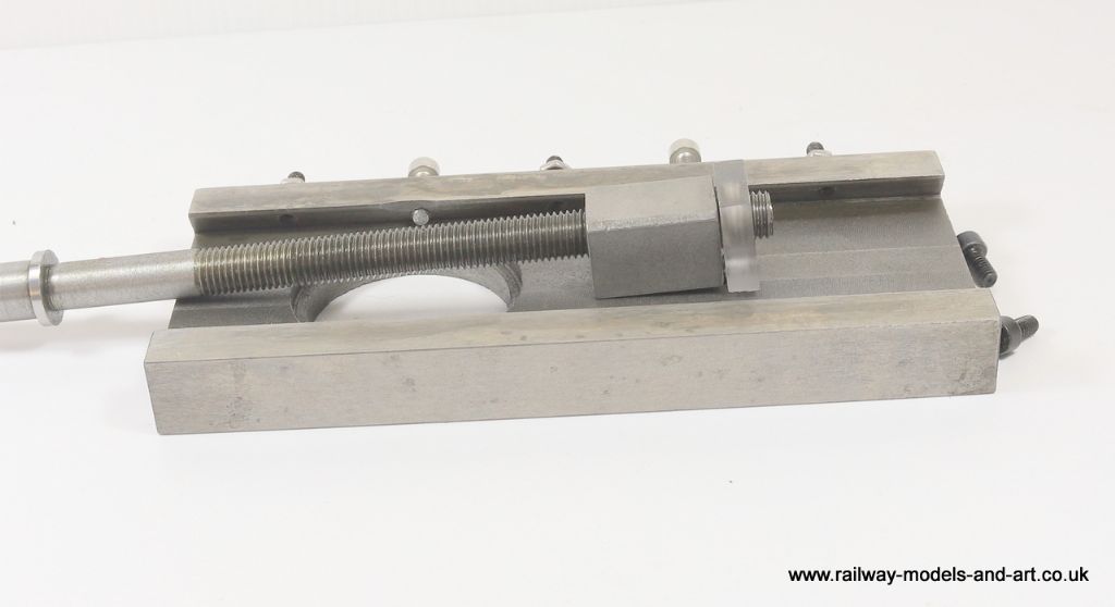

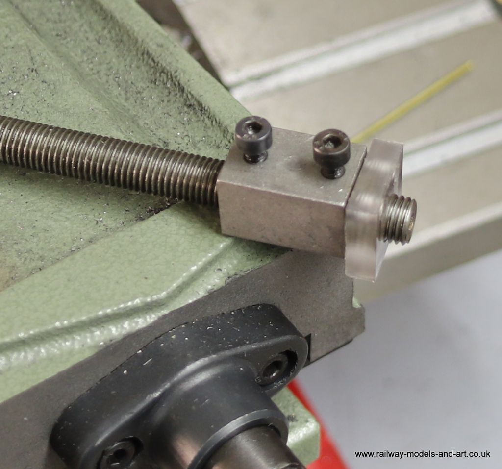

                                    Just to conclude this thread, the leadscrew thread was ultimately 3/8 20tpi a set of taps was ordered from RDG and I now have a prototype of the anti backlash nut/block.
                                    I have tried and failed miserably to add a couple of photos
                                    Anti backlash nut
                                    Edited By Robin Pulham on 09/01/2022 20:27:03

                                          It's my intention to do away with the use of the centre grub screw on the feed nut and replace it with shims. I will leave the grub screw in situ to keep the swarf out.
                                          I have a thread running on the Gauge O Guild outlining what I am doing in the way of improvements to the SC3.
                                          If there is interest I will start a thread here?

                                                Robin, On my mill if my memory serves me right, it had a nut with a slit one end, two screws on the open part of the slit pushing it open to remove play, how does your device push away from the fixed nut?
                                                #579470

                                                  Robin Pulham
                                                    @robinpulham96156
                                                    Posted by Pete. on 09/01/2022 21:15:59:
                                                    Hi Pete,
                                                    It has two grub screws above the main thread.
                                                    Regards Rob
                                                    #579475
                                                    Pete.
                                                      @pete-2
                                                      Looks a very similar design to the factory one on my Mill, interesting choice of material what is it?
                                                      I did see a video on YT not long back where someone had built an anti backlash mechanism, the builder had used springs to remove the backlash, there were mostly comments praising his genius, I was relieved to see a couple stating all he had done was spring load the backlash.
