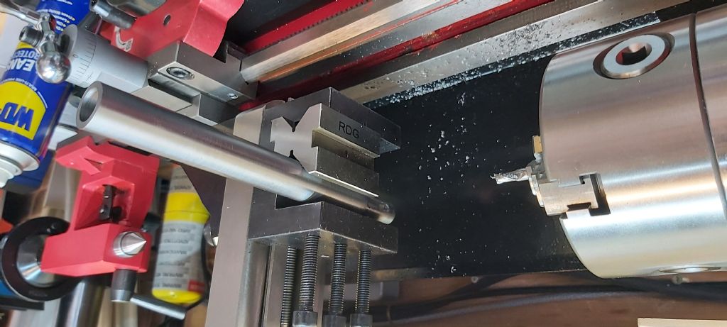

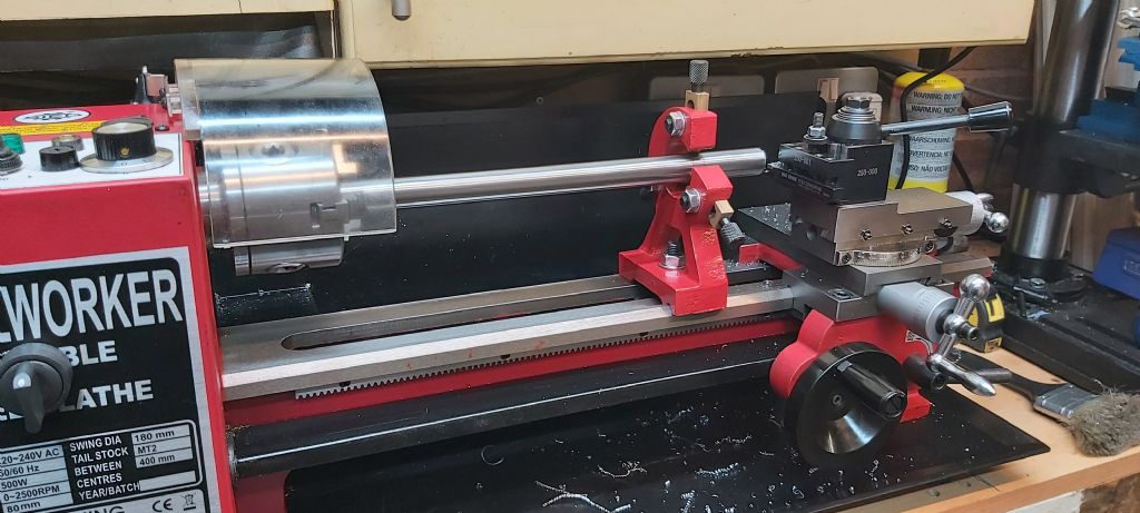

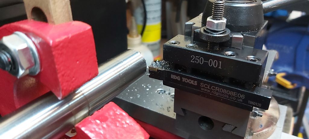

The motor shaft extension was a little to short so remade with plenty to spare! Fun and games at distance. As it turned out i had slightly lost my centres at this point but not to worry.
I think i had probably only excentuated the run out of the chuck but for a first attempt it went well enough.

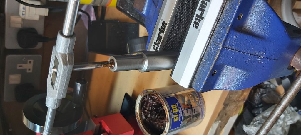

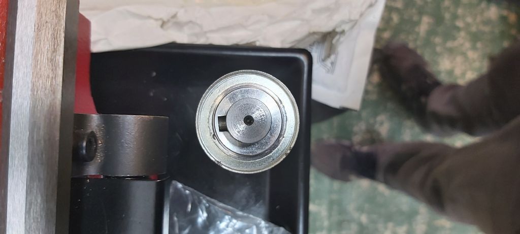

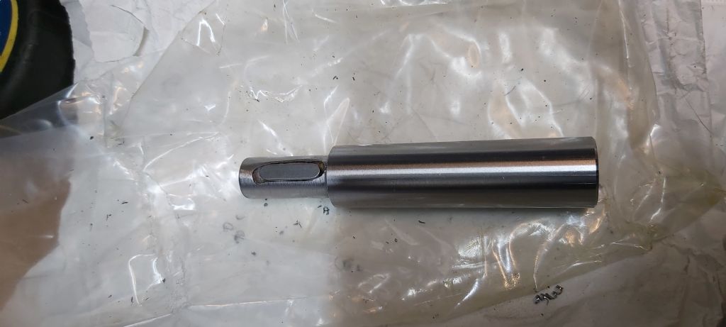

Tapped the pulley end of the extension as i have another piece which goes over this and then through the machine side bearing.

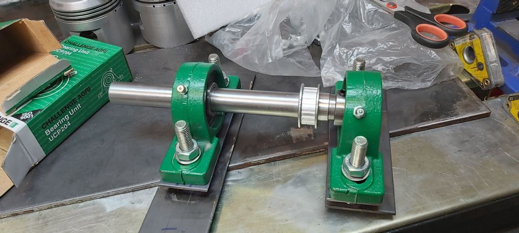

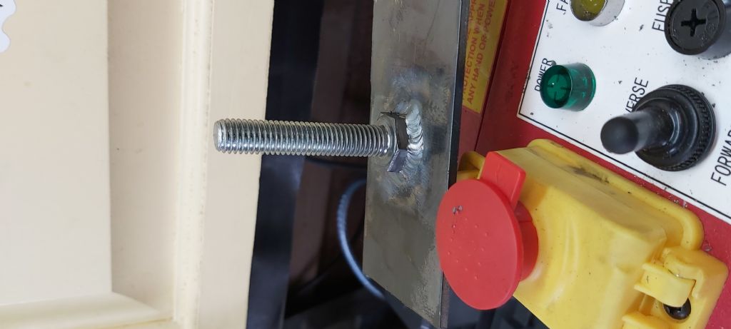

These nice, highest quality (magnetic) stainless bolts for the bearings could be carefully welded with normal A15 tig filler. They're solid!!

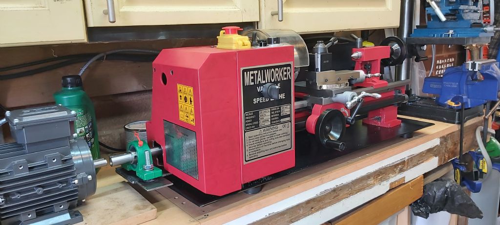

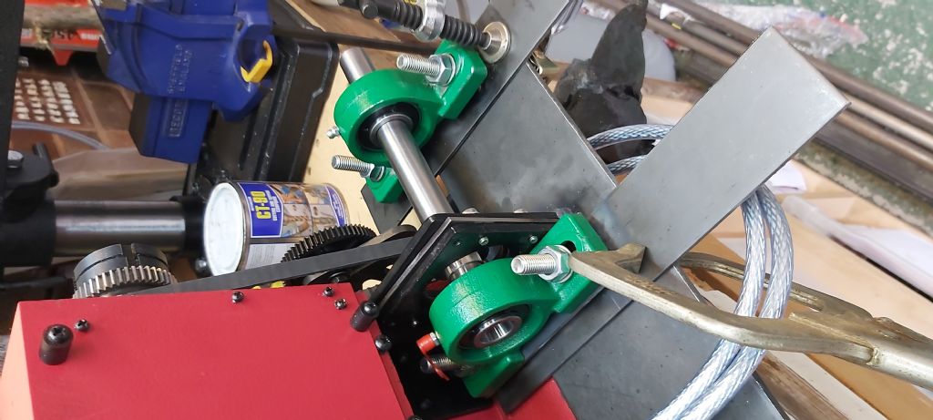

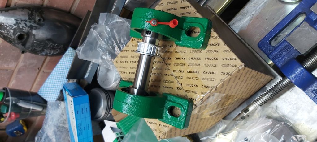

Extension mounted through the bearings. I am expecting these to move a little when welded to the main plate that fastens to the lathe so what you cant see from this image is that i have a lot of options to raise and lower the bearings as well as more than enough front to back to get things lined up properly.
A quick mill for the key. I did both ends. The motor end is completely through.
Jigged up ready to weld. Everything seemed so easy!

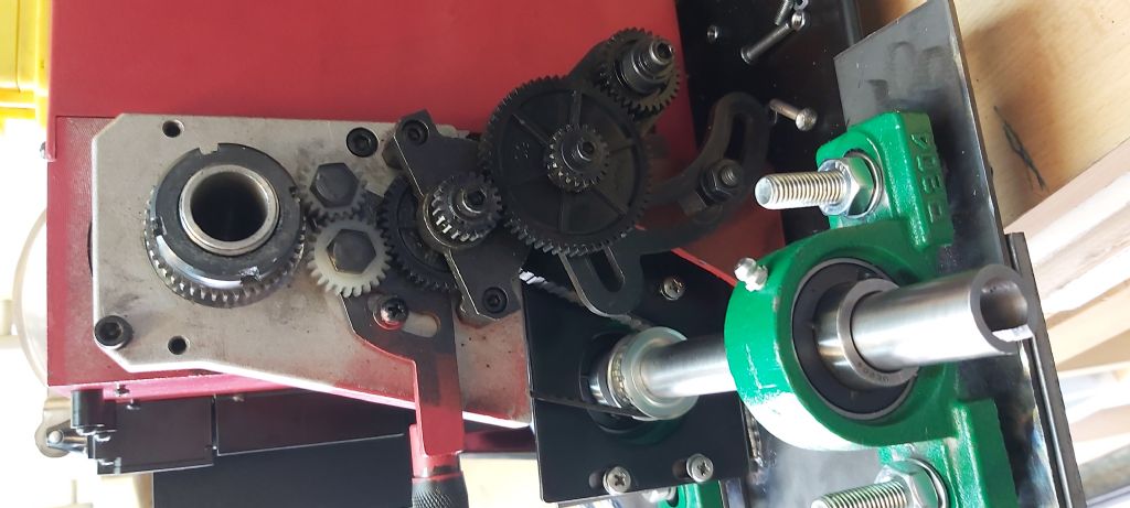

Plenty of room for the thread cutting gears. So just a bit of cover cutting and the whole things is back together..
