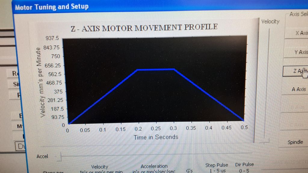

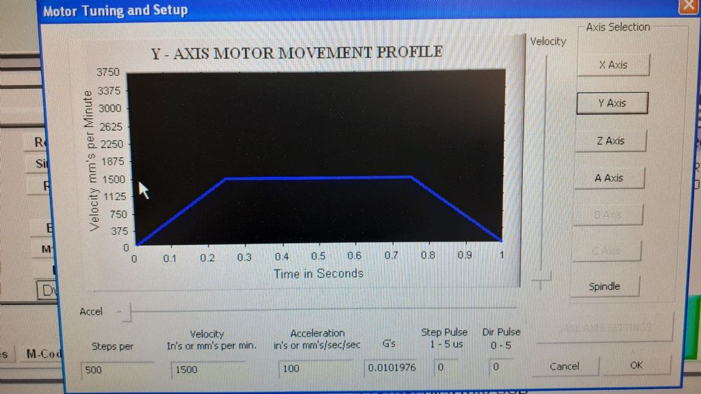

      For the F360 job, I'm setting up the DTI so that it reads 0 when Mach3 reads -30.0000 mm in Y. After the job I jog the Y until the DTI reads zero again and check the Mach3 Y readout. It would show -29.7500 mm, for example.
      Actually, I had to cave in and purchase a year F360 subscription. I have so many components being used at once. I was using Aspire, but mostly for 2D milling and engraving. I've moved to F360 cam. Might as well since I'm paying for it now. And the designs move seamlessly into the cam module.
      I see now. There's lots of rapids. I was looking at G0 Z5. and not realising the subsequent lines were rapid moves too.
      I checked the rapid speeds in Mach3. It was set to 1999. One of those settings I was messing about with a few months back and forgot to set back. It will have worked fine in X, but would be on the edge of failure for Y. My little vise seems to have pushed it over that edge. The first component I produced was clamped without a vise. But some heavy cuts were causing sliding. Once I attached the vise I lost accuracy. That first component produced so perfectly was confusing me. What had changed?!
      I'll double check after running the job again (with JasonB's update), but hope that's the problem fixed. But thanks for all your invaluable input. I'll update soon.

        My X & Y are set at 1500mm/min, Z is less at 650 but I think I altered that due to damage from the previous user. I was running one of the ARC 100mm versatile vices the other day which is a lot larger than the 80mm I usually use and did not notice any problems.
        The job should take a lot less time, your code ran at 48mins, mine using your feeds 22mins and if I change to 6mm carbide tooling it comes down to 11mins. Were you actually machining the end of that long stock or did you just put a short bit in to test as I wondered why the profile is drawn the whole length but you are only cutting part of it if a smaller part then time would come down even more

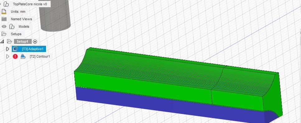

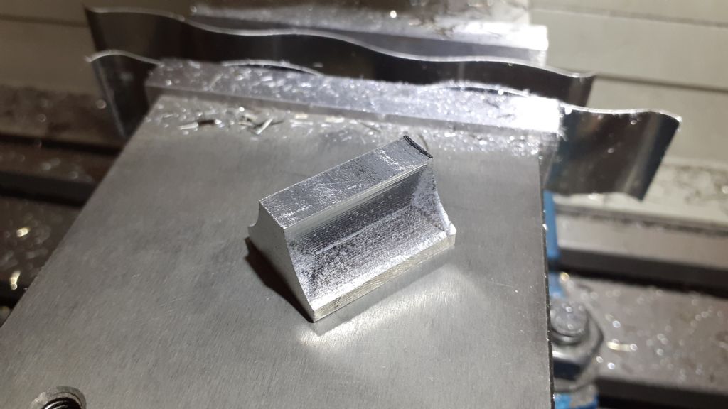

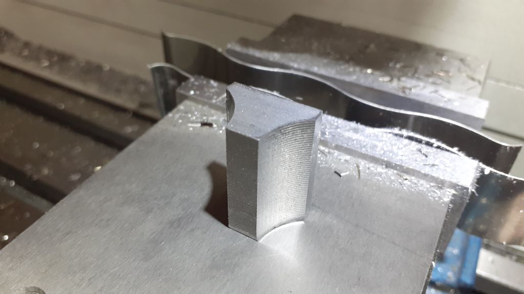

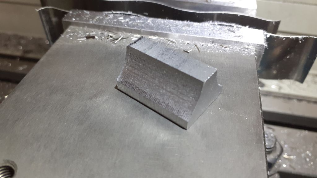

                      While the machine was turned on for machining another CI flywheel I thought I would have a quick go at one of Nicola's parts. As I said a few posts up doing them from individual blocks 25mm long would be better than working on the end of a bar so roughed out a bit of scrap black bar of unknown spec.
                      Started with adaptive clearing with my usual 6mm 3-flute carbide cutter taking 5mm vertical x 1mm horizontal cuts and then stepping up the profile in 1mm steps, set to leave 0.5mm stock. 5000rpm, 400mm/min feed
                      Then did two options, firstly a scallop 0.25mm stepover on one side and then on the other a parallel path following the curve so stepover remained a constant 0.25mm. These were done with a 6mm ball nose tool with 4 flutes 5000rpm 500mm/min feed.
                      Not the best of finishes, so could do with a bit of playing around with settings or some known stock but enough to give an idea of what's possible and at just over 7mins run time better than Nicola's original 50+mins particularly as 16 are needed.
                      Parallel
                      Scallop This gives a smoother surface roughness test (done with finger nail)
                      Andrew did you mean doing them like this when you said vertically?

                        Great job! Now, how did you get scallop to do one side at a time? Mine's doing a column at a time and then going to the other side, back and forth. Lots of time wasted.
                        [edit] Got it. I unselected the top face and it seems to be doing something similar to yours.
                        Where did you get those lovely wavy parallels from? I definitely need those!

                          When in the geometry part of the scallop setup click avoid surfaces, I did this anyway to top, sides and ends but also added one of the curved surfaces so there was just the one left that it could machine. Simply marking the top surface as one to avoid will get it doing one side and then the other rather than going back and forth over the top as though it's machining it but there is no metal to come off as you have found out..

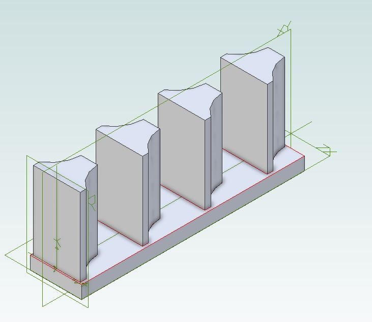

                          #543961
                          Anonymous
                            Posted by JasonB on 08/05/2021 14:06:52:
                            No, I meant as in the third picture.
                            I'd definitely finish machine the curved surface with horizontal cuts and a stepdown. You'll get a better finish for a given step size, or with an adaptive stepdown and a specified scallop height it'll need fewer passes. If the parts are only 25mm long I'd do them as a couple of long parts and slice up later. One could make a fixture to hold them in the vice with screws into the base of the parts at each end. I'd probably dispense with the vice and use a length of material for a fixture clamped directly to the table. If it isn't acceptable to have screw holes in the bottom of the part, just make each length slightly longer so the screw holes get lost when slicing.

                              I did mean the last (third picture).
                              Could probably do them on a piece just over twice the length, cut one end and then flip over to do the other before cutting in half and cleaning up the cuts. Something like this is no screw holes possible?
                              Your thinking of a ball nose to finish the vertical curves is that it is likely to leave a less visible step I assume and could be done in say 5mm high steps so just 5 passes would indeed be a lot quicker. It would certainly give a better finish than either the scallop or parallel as the stepovers leave ridges unless you do them really small and that just takes up time.

                                Nicola, this is the way Andrew is suggesting the work is done with the profile on end then you get a much smoother finish. You could get away with less finish passes with a larger dia tool, I did more to let any spring out of the 6mm cutter as I had to use that for the size of my internal fillets.
