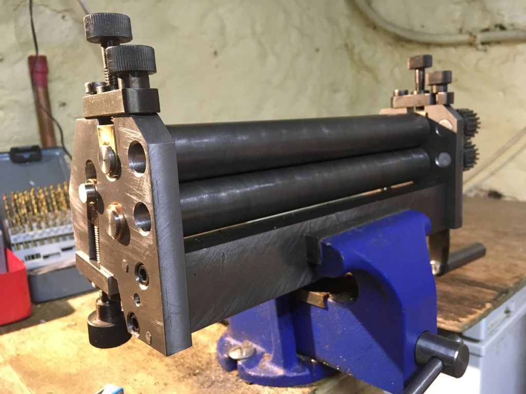

      As a brief respite from clockmaking, I made these bending rolls. It was a pleasant change to feel I knew what I was doing!!!img_2518.jpg

                Good work David. What are the extra holes on the end plates used for ?

                  Is it the Geo Thomas design scaled up?

                      Posted by Paul Lousick on 14/03/2020 22:02:49:
                      Paul
                      Hello Paul,
                      Thank you.
                      Well—– I could say they were for cooling! But the two end plates were dowelled together to maintain concentricity and rather than attempt to stop boring half way through, I carried on.
                      David
                      #457258
                      David Noble
                        @davidnoble71990
                        Posted by duncan webster on 14/03/2020 22:16:54:
                        Hello Duncan,
                        Don't know the origin of them but the plans are from Hemmingway. If scale helps, the rolls are 10" long.
                        David

                          Looks a good job. I would have said the extra holes were made so that it could be for either left or right handed operation.🙂
                          Question: What is the minimum diameter you can roll!

                            Posted by not done it yet on 14/03/2020 23:26:40:
                            Thank you NDIY, You're right, that would have sounded much better smiley
                            Minimum diameter would be about 1 3/8" (ish)
                            David

                              The Hemingway design is GHT, and includes the later mod. of gears to connect the 2 main rolls.
                              GHT also specified small tommy-bars on the adjusting screws to give a visual reference when operating them.

                                Hello Clive,
                                Yes, this does have the gears which connect the main rolls. As for the tommy bars, thank you for the info', I couldn't see the point of them so I left them out.

                                    I picked up one of the Hemmingway kits from John Moore (Bogstandard) in his workshop clearance.
                                    Whilst I accept we have different machinery and you probably have more experience than me, how long do you reckon it took you to build it. (yes, I know it's not a race)
                                    Also, any useful tips?
                                    Bill

                                          Posted by peak4 on 15/03/2020 10:58:32:
                                          Bill
                                          Hello Bill,
                                          Don't bank on me having any more experience than you! I suppose they took around 3 weeks but only a few hours each day in the workshop.
                                          If I can help, feel free to contact me. Just start at the beginning and concentrate on one part at a time.
                                          David
