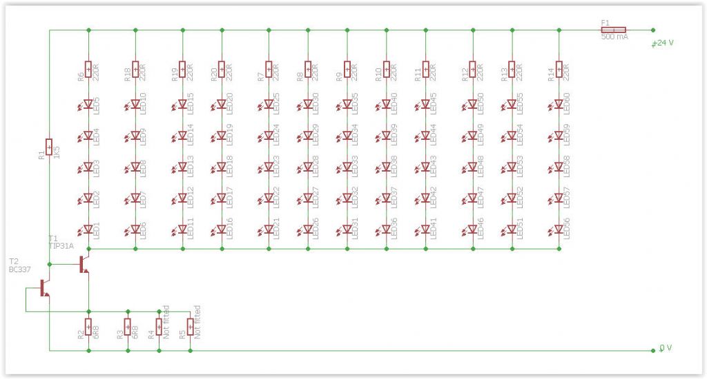

                                                    Hi All have just run the engine on air with no governor connected the pressure was set to 100 psi its working pressure the speeds were 1000 rpm 6 volts 3000 rpm 12.4 volts 4000 rpm 16.5 volts 5000 rpm 24.6 max speed unregulated 6500 rpm? 31 volts this was very erratic hope this helps Derek
                                                    #264166
                                                    Les Jones 1
                                                      @lesjones1
                                                      Hi Derek,
                                                      Here is a circuit that should do whatyou want.
                                                      It is designed for a LED current of 20mA and the transistors in the constant current circuit should be OK up to 60 volts from the dynamo. The TIP31 will need to be mounted on a small heatsink. You could use the regulator that Michael suggested in place of the two transistor constsnt current source if you want.
                                                      Les.
