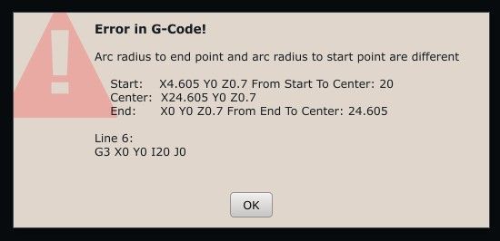

                          I get this error message with your gcode.
                          Try this gcode instead. It's just a pattern of arcs.

                            I have looked to see what the error code is telling you. G03 or G3 is an anticlockwise move around a point, in this case defined by i20 j0. Starting at x0 y0 and ending at x0 y0 would make sense as the radius will be a constant 20mm (assuming this is what everything is set up in). If however you try to start at some random place other than x0 y0 then the start point and end point are unlikely to have the same distance to the centre of rotation so a constant radius arc will be an error as flagged. If you add g01 x0 y0 z0 after f900 it should work (unless it runs out of space to move).

                              OK, I also use UGS and have just plugged that code into my machine – it runs perfectly!
                              So, I believe that your issue is one of configuration, frustratingly.
