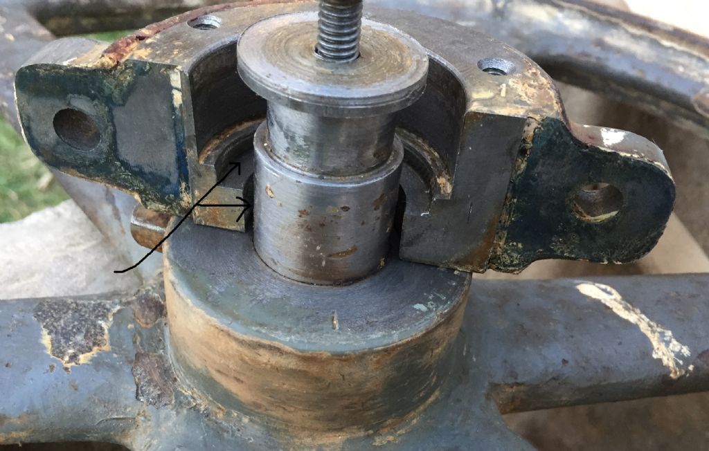

  • #530998
    pgrbff
      @pgrbff
      I am attempting to restore an old woodworking bandsaw. I have removed the top wheel bearings. Should there have been an oil seal of some type in the areas indicated? The open bearing sits above this point and has a brass cover plate with a stauffer grease cutop wheel bearing housing.jpgp. The areas indicated seemed to be filled with very congealed grease which came out in one piece. I'm not sure how old the machine is, it had what I think are standard 6205 bearings in it.

        #531005
        Dave Halford
          @davehalford22513
          Theres usually a witness mark on the shaft left by a seal lip. Where does the bearing go?
          #531009
          Emgee
            @emgee
            If there was an effective seal fitted below the bearing eventually the bearing would become flooded with grease because the excess would have no exit route from the bearing being charged by the stauffer grease cup,
            Agree it does appear to be an oil/grease seal groove that you indicate.

                #531014
                old mart
                  @oldmart
                  The 6205 bearings are available with built in oil seals (6205 2RS) so you need not worry about greasing if you get them.
                  #531018
                  pgrbff
                    @pgrbff
                    Posted by Dave Halford on 01/03/2021 17:41:39:
                    The bearing sits just above so the grease would just come out the back. I guess the grease may have been thicker 60-70 years ago? No witness mark.

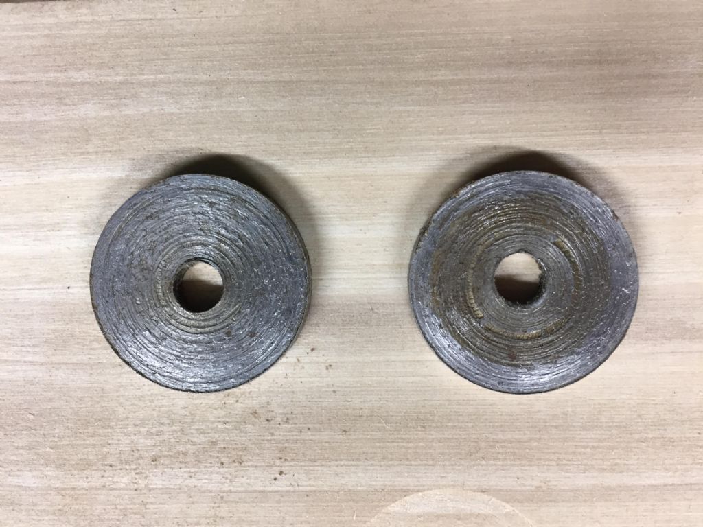

                                              #531787
                                              pgrbff
                                                @pgrbff
                                                OK, convinced, bought sealed.
                                                The two washers shown hold the bearings on the shaft that passes through the cast iron wheel. I'm guessing that the marking suggests that the bearing has been moving in its housing?
                                                I would prefer not too but will I have to use something like Loctite 648?
                                                Hopefully, I'm wrong or there is a better solution.bearing washers
                                                I haven't been able to find an oil seal that will fit either, it would have to be only 3mm thick. I have ordered some 1/8" oil seal felt.
                                                #531794

                                                    #531814
                                                    Hopper
                                                      @hopper
                                                      Posted by pgrbff on 05/03/2021 08:41:14:
                                                      Those look like they have just been rough machined – parted off – and put into use. Does not look like the bearing was rubbing on them. They would not have had loctite 70 years ago so would have relied on a light press fit between inner race and the shaft to prevent race moving — hence the need for a bearing puller to remove them. Plus if those washers bear down on the inner race when the centre bolt is tightened, that would hold the race too. Outer race should be a firm fit in the housing, or the split housing should clamp it, to prevent movement. I wouild avoid loctite if I could, as I might be the next person who has to pull it apart!
                                                      Bit of felt cut and put in place should suffice to keep sawdust out. Bit of grease on it might help. But the bearings own seals will be the actual barrier.
