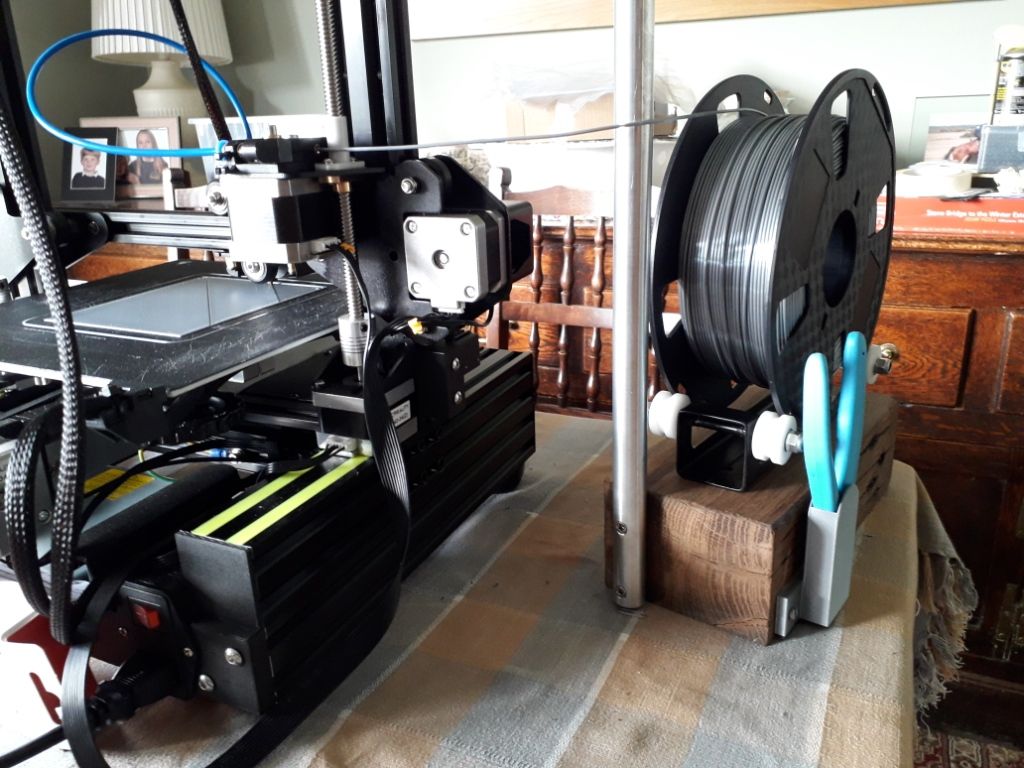

      Fitted a new reel of Filament to the 3D printer (Ender 3) and it was quite springy. The feed to the head was a bit jerky but I didn't notice until a duff print was produced.
      I realised the spool was not keeping in step with the needs of the printer but sometimes over ran allowing the filament to go slack – not only between the reel and the head but on the reel itself.
      I think I have fixed the original problem with a couple of elastic bands (thoughtfully left on the drive by the postman) wound round the tube it sits on providing a minimal amount of friction and preventing the over running but due to having been loosened the filament now jams in the loose winding on the reel when the feed reaches the cheeks of the spool.
      What to do? Carefully unwind the filament until a tightly wound section is reached and dumping the excess, the same but try to carefully rewind it tightly or saying 'to hell with this its only £20' and dumping the whole reel to obtain reliable printing?

                Don't ditch it, the reel can probably be saved. Firstly rewind the reel to get rid of serious overlaps and more importantly make sure the filament is not trying to tie itself in a 'clove hitch' where the end has managed to get under one or more previous turns. Then make sure the filament is dry, put it in a bag with some fresh silica-gel for a couple of days. Also worth checking that the entry and exit points to the bowden tube are nice and smooth, no sharp corners. Restrict the reel from swinging too much, as you have with the elastic bands.

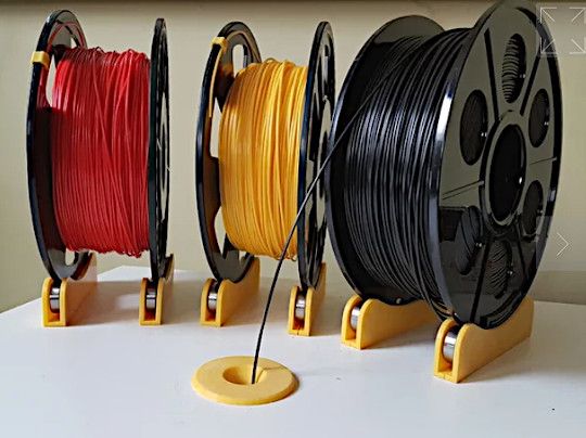

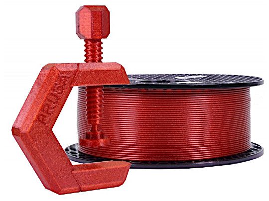

                It helps to buy quality filament have a look at the following images the first is from Prusa (Prusament) note the even wind. The second is an unknown brand but note how uneven the wind is. The difference is fairly obvious as is the outcome. Always try to keep the filament under control when loading. Even a smoothly wound roll can end up in a mess if the turns become too loose.
                The second image also shows some useful ball-bearing spool holders (search TUSH on Thingiverse). I have recently made myself a dry filament feeder box using these ** Journeyman's Workshop ** and they work well.

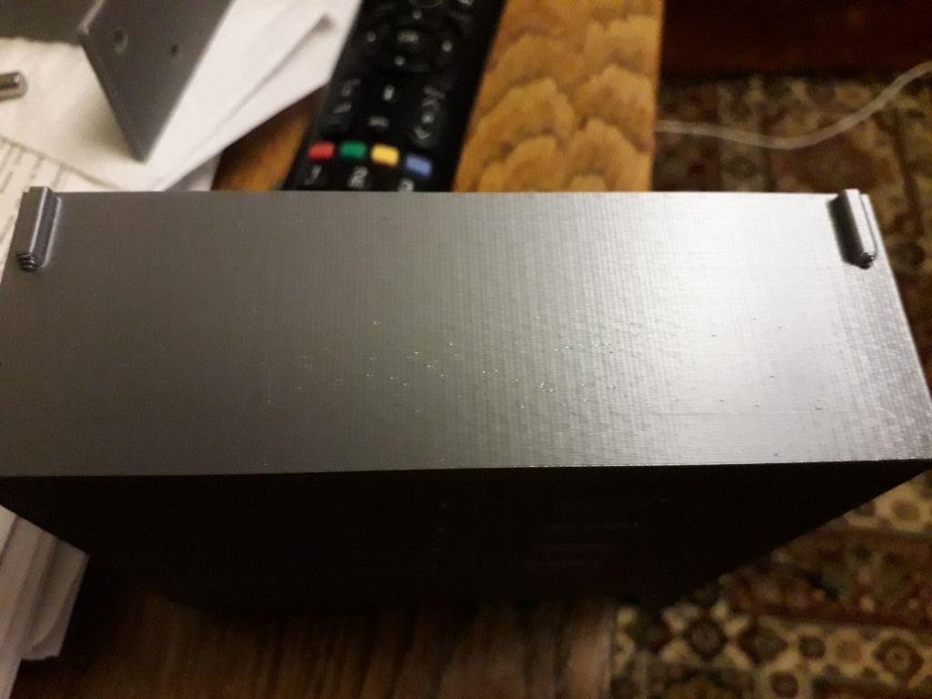

                              This is what moisture does, the little pits are just about visible:
                              It can be heard popping while printing and if it happens on the outer layer is quite visible and it is supposed to weaken the print if excessive. This is the silver silk PLA I mentioned in my earlier post, after drying I have almost removed the moisture and it has printed quite well this afternoon.
                              I made a spool holder from some 50 x 50 box with some POM wheels that the spool mounts on, I mounted it on a large block of oak as the spool has to be parallel to my printer due to space limitations.

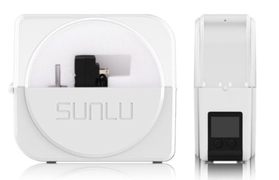

                                  I've had some good results reviving an old reel of PLA that had gone brittle by using a dedicated filament dryer that can also be used to feed the filament [it has a set of rollers in it]
                                  Though some reels can be a bit tight

                                        I have the Sunlu dryer shown above. Max teperature is 55C.
