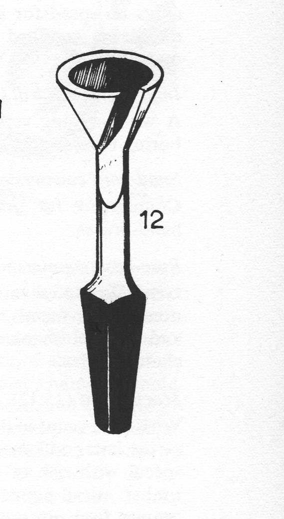

              Is there a tool just for de-burring the cut end ? I was thinking along the lines of a hand held tool in a handle and just give a twist on the screw end. I can't find anything on line, do they exist? Any ideas for making one ? I'm thinking a sort of reversed countersink but can't think how to make simply.

                Gordon W:
                There used to be a tool like the one you envisage for chamfering the ends of wooden dowels. I will try to find a picture.

                  Gordon W:
                  This is the sort of thing I had in mind:
                  **LINK**
                  One for screws would no doubt be smaller and the cutting element HSS or, perhaps, TC.
                  I prefer to perform this operation in the lathe using a suitable fixture but it is a time-consuming job.

                    Gordon W:
                    Here is an alternative form which could be suitable for shop manufacture:
                    The picture is from Ernest Joyce's Technique of Furniture Making.

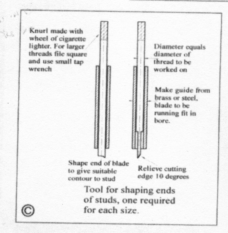

                          "Is there a tool just for de-burring the cut end ? I was thinking along the lines of a hand held tool in a handle and just give a twist on the screw end. I can't find anything on line, do they exist?"
                          The answer is yes, but for me the effort involved in making one for each size was why I adopted the 'concave diamond mini drill tool' (q.v.). What you seem to be looking for was published in the M.E. 31/05/2002 p. 394.
                          (Edit to correct page number)
                          Edited By Fowlers Fury on 20/03/2018 14:30:12

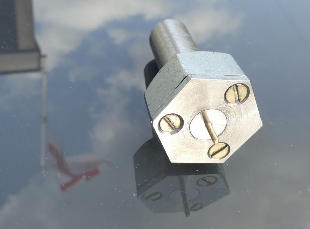

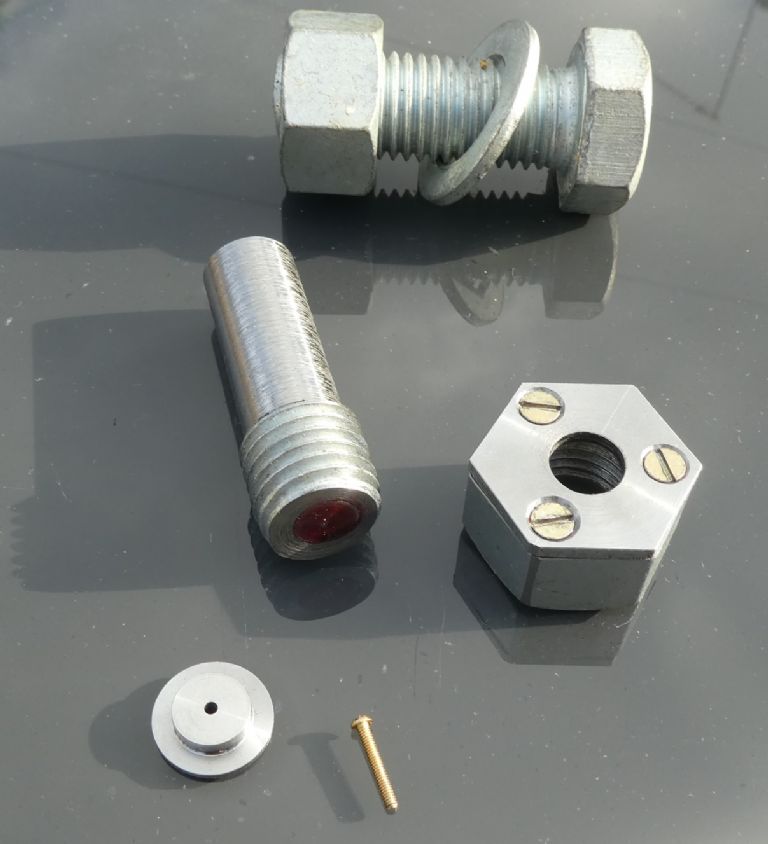

                                  Matt posted the following link here earlier:
                                  **LINK**
                                  (Thanks for that Matt). So spent a few happy hours today knocking one up with a 9 BA collet drilled out with a No.49 drill to hold my 9BA screws which are .072” over the threads. Hopefully this “tightish” fit will avoid any Howard Lewis type wobbles.
                                  Shop time for today came to a halt a short while ago when I ran out of “standing up time” ( don’t larf you’ll be like it one day!) so not been able to try it out yet. I’ll have another bash tomorrow.
                                  If it works OK then I’ll go ahead and make some different sized collets but not before I have worked out a method of “mass” production. This is where I miss the ability to go from turning speed to parting speed at the turn of a knob as I could on my now departed wm 250 vf.
                                  One more observation – the 20mm bolt as seen in the photo (of which I have a box full), is the sort commonly found on building sites and used for fixing steelwork. I fully expected it to be as soft as muck but to my surprise it was as tough as a very tough thing. My lathe is a Warco BH600G – big enough to make mincemeat out of something like this. Anyway, two chipped carbide inserts later the job was done. So much for my supply of cheap car boot steel.
