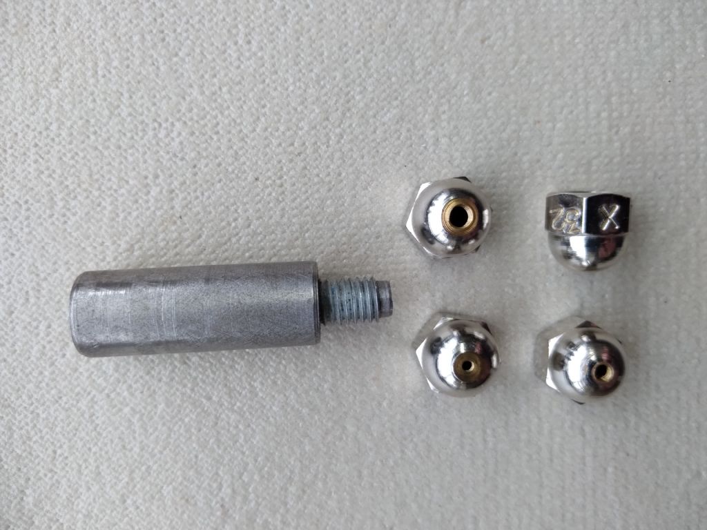

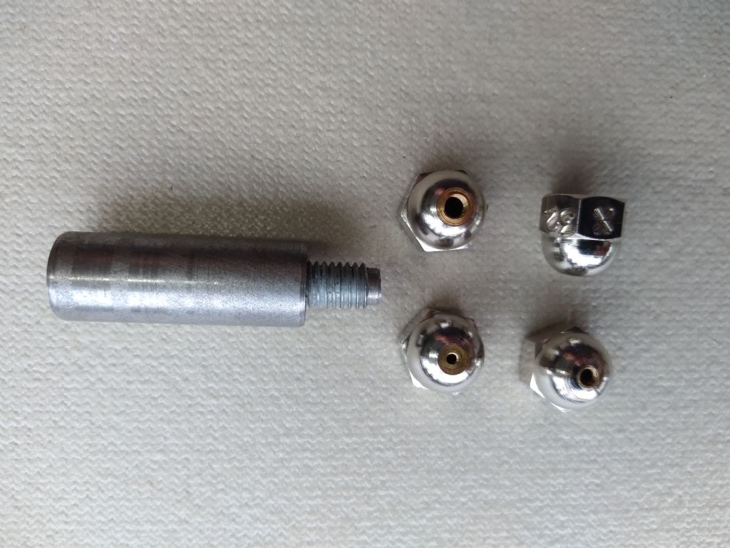

                                  20211214_090334.jpgHi Vic'
                                  One method of shortening screws is to screw on nut with excess length protruding, hold nut in vice and use a cold chisel to cut off excess length, unscrewing nut from screw will clean up thread.
                                  Alternatively a cheap and cheerful “lantern chuck” can be made by turning down a short length of rod and threading the end, then using dome nuts in the three jaw drill and tap to the require size (head of screw must be able to enter), position screw to give length of screw required. Screw nut onto threaded shaft until head hits end of threaded portion, place in chuck and turn off unwanted portion of screw. Disassemble to remove screw.
                                  I have done down to a 2mm screw.ic
