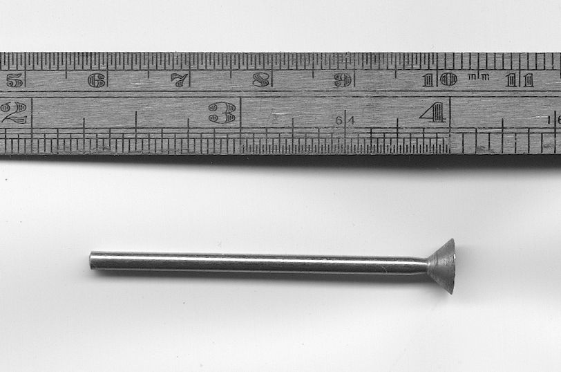

                                      #346044
                                      Fowlers Fury
                                        @fowlersfury
                                        Re: " The root of the problem is not cutting the screw to length but tiding up the cut end so it will screw in to the mating thread"
                                        Have searched for a current source of these without success.
                                        I use the concave, diamond-impregnated surface of this "cutter" in a hi-speed mini drill then onto the end of a cut-off BA bolt. It produces a nice rounded end without damaging the leading threads in a few seconds. It's lasted for years – only wish I could find a new spare.
                                        Addendum: Presumably the similar concave-shaped, but aluminium oxide stones which are freely available for mini-drills would be as effective although not as long lasting.
                                        Edited By Fowlers Fury on 14/03/2018 12:27:24

                                          #346075
                                          Fowlers Fury
                                            @fowlersfury
                                            "…….so a quick search found.….."
                                            Rob., well found !
                                            However at 6mm D it's unlikely to fit the chuck of a hi-speed mini drill but mounted in a drill press it might do the job. Over the years, I've learned the best way to round the cut edge is to hold the mini drill in one hand and move the bolt with the other hand in a sort of 'conical way' inside the rotating concave (harder to describe than to do !).
                                            If the bolt is held in the vice and the rotating cutter applied, the mini drill tends to jump about quite a bit.
                                            Yet…..with drill press and vice it should be OK.
                                            Prompted by your reference to a "jeweller's tool" – I'll also start searching.

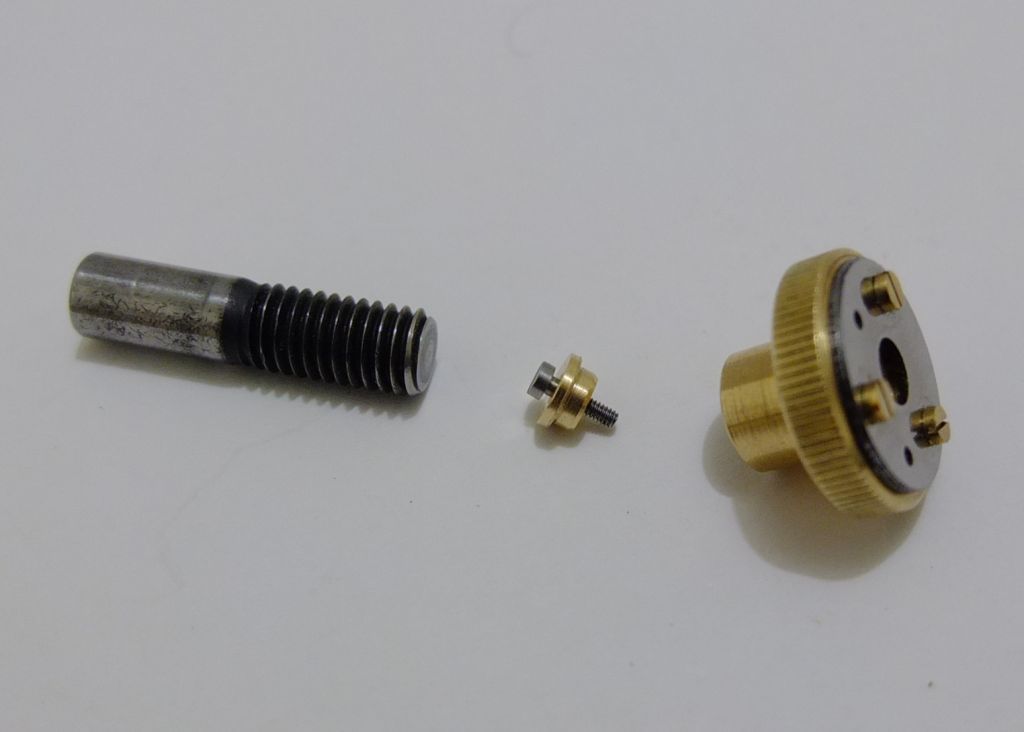

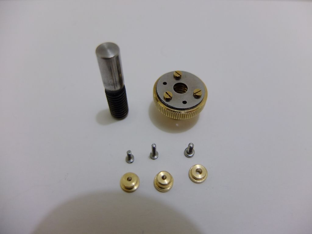

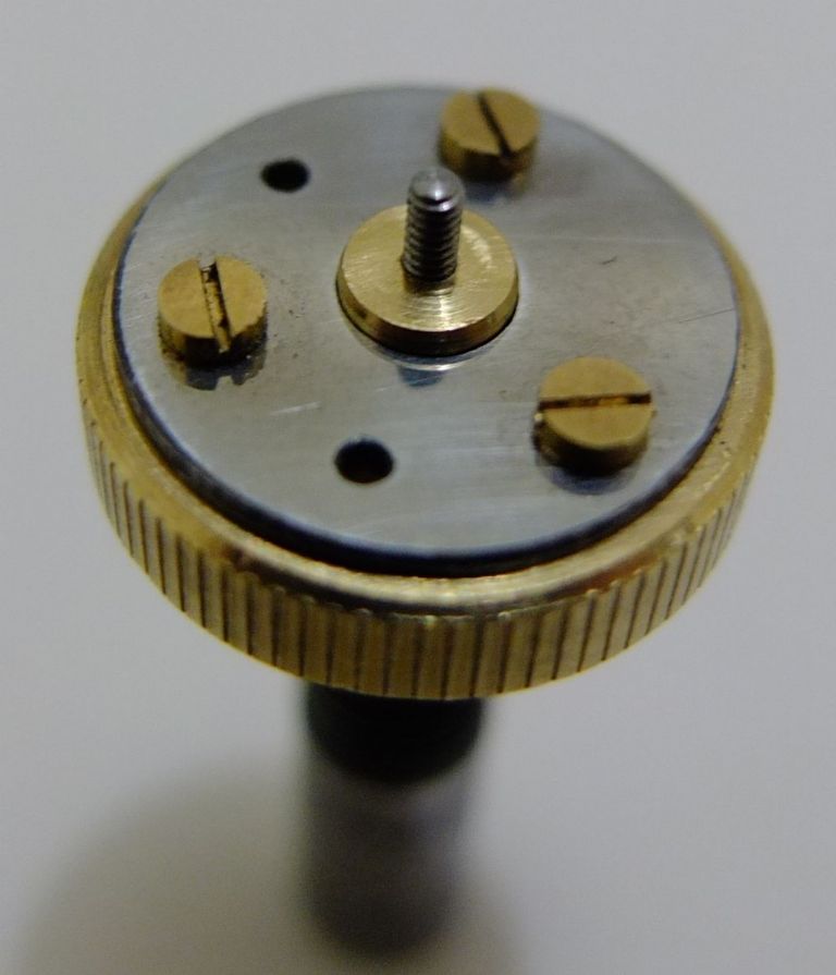

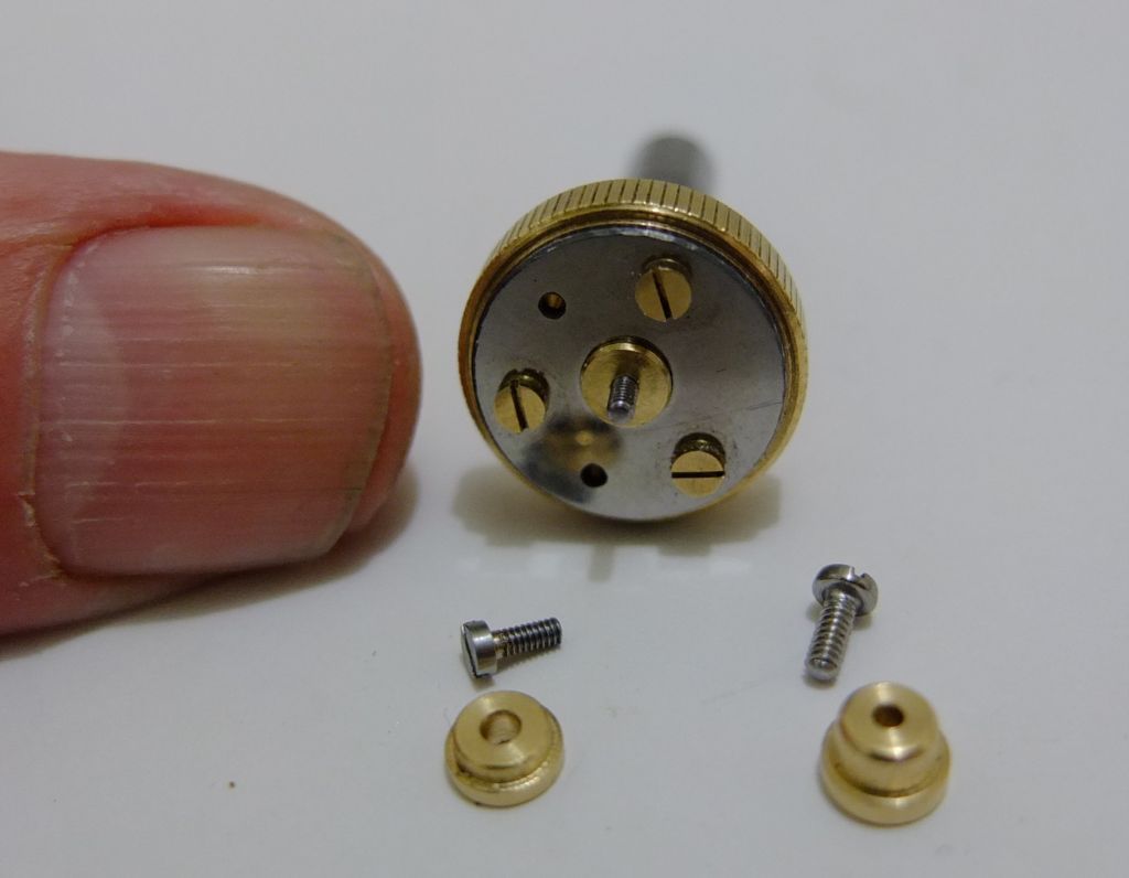

                                            #346222
                                            Steve Crow
                                              @stevecrow46066
                                              I made a primitive lantern chuck for small screws. The collets are for 12BA and M1.6.
                                              #346251
                                              Philip Rowe
                                                @philiprowe13116
                                                Posted by Steve Crow on 15/03/2018 13:40:08:
                                                Steve, that looks like a very useful lathe accessory – at least for the things that I do. One thing does puzzle me, it appears from the photos that the individual collets are not threaded, I would have thought that if they were it would give you more control over where the screw sits in the chuck, or am I seeing a problem that isn't really there?
                                                Phil
                                                #346254
                                                Tractor man
                                                  @tractorman
                                                  I don’t think the collets need to be threaded. As long as the screw sits snugly in the hole it will be central and is held in place by the threaded mandrel. Neat bit if work!
                                                  #346267
                                                  Steve Crow
                                                    @stevecrow46066
                                                    Hi Philip, I did consider threading the collets and I would have made one if I needed lots of different lengths of screws.
                                                    However I needed a couple of dozen of the same length (3.5mm + 4.5mm) so I made collets to suit. I opened the holes with watchmakers broaches so it's a nice snug fit.
                                                    The holes in the front plate are witness holes. The plate is made from 1/32 ground flat stock with the centre hole bored (4mm) with the whole thing assembled to ensure it's true. I then hardened and tempered it and the holes make sure it goes back on the same.
                                                    The body was made fro an old M4 thumbscrew drilled and M6 tapped and the shaft is a sawn off M6 bolt.
                                                    It is a treat to use in the watchmakers lathe. It takes no time to saw to length then round and polish screw ends pre-blueing.
                                                    I'll make more collets as I need them – again take minutes to make with a hand graver.
                                                    Steve
