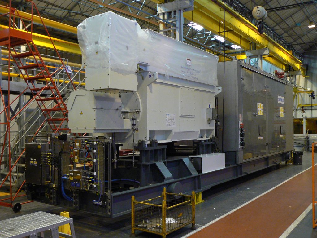

                        Alternator on Vibracon machine mounts. Vibracon technical page
                        Martin C
                        Edited By Martin Connelly on 19/12/2020 09:52:04
