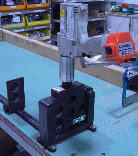

          At work we had a modified battery drill driven din rail cropper. It used a straight guillotine type shearing action.
          Martin C
          #744503
          Martin Connelly
            @martinconnelly55370
            Din rail shear
            This may give you some ideas.
            Martin C

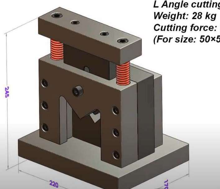

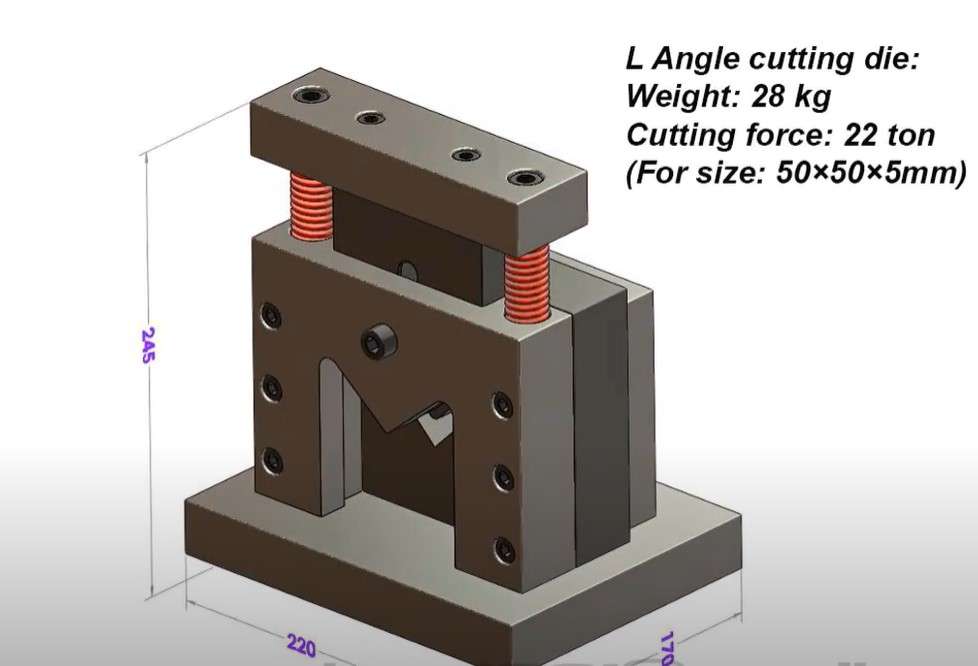

                  This is the sort of press tool I envision
                  Screenshot 2024-07-31 170135
                  But scaled down a bit. Probably get the cutting parts waterjet cut by the usual place. Re Laser cutting the angle quite a few laser cutters have rotary head attachments primarily used for engraving glass and trophies so one of these might be pressed into service but the aforementioned usual place has not been keen to take on this sort of job in the past probably too much setting time.

                    Another shear on the same principle.
                    images
                    IF you had a small fly press, you could make a shear block up out of silver steel – as I sad IF !!

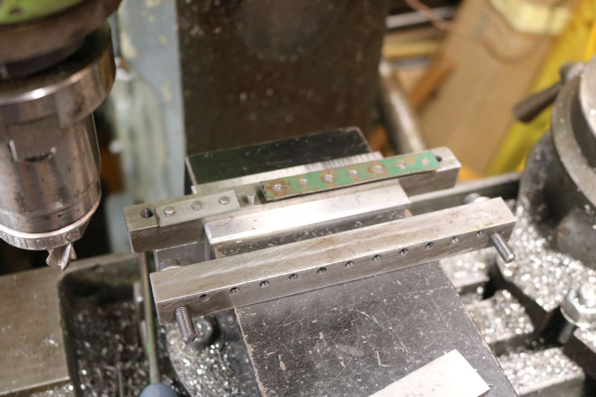

                          I have some experience modifying Meccano strip by sawing and milling, and it didn’t go particularly well. Needed several Part 6a (flat strip with 3-holes), and have plenty of mangled long strips to recycle.   Hacksawed them to length and made a fixture to hold them in a rotary table to mill the rounded ends.  Left me convinced there must be a better way!

                            The usual suspects in China offer a “Universal Manual Angle Steel Shear” which you could use for inspiration for a tool to use in your fly press, they have likely made the simplest and cheapest design.
                            It’s basically a piece of inverted angle iron as an anvil and a V slotted shear in two runners. You might not even need the runners if you can attach the shear to the punch of your press.
