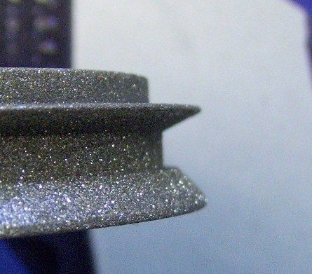

        Does anyone know where you can but a CBN grinding wheel to sharpen fine tooth slitting saws ideally 5 or 6 inches dia. I am thinking of a saucer/dish wheel with material on both the face and angled back side so a plunge grind would shape both the tooth face and the back of the next tooth.

                The problem with Diamond is its not good for grinding HSS where as CBN is ideal and unlike conventional grinding wheels maintains its shape. Someone must do it the professional cutter sharpening companies can do it so there must be something out there but where. I must have at least a dozen cutters that are all in need of treatment accumulated over years in our hobby.

                      That is very interesting I have always thought Diamond for carbide and CBN for HSS. The one problem I have found with diamond dish wheels is the only one surface is coated normally the flat face where for my application I would like the angled face also to be coated.

                          Could one of the wheels of ARC;s EMG end mill sharpener be put to use, available in CBN

                            Yes but it would work well although a bit expensive since most of the coated surface would not be used only small angled portion.

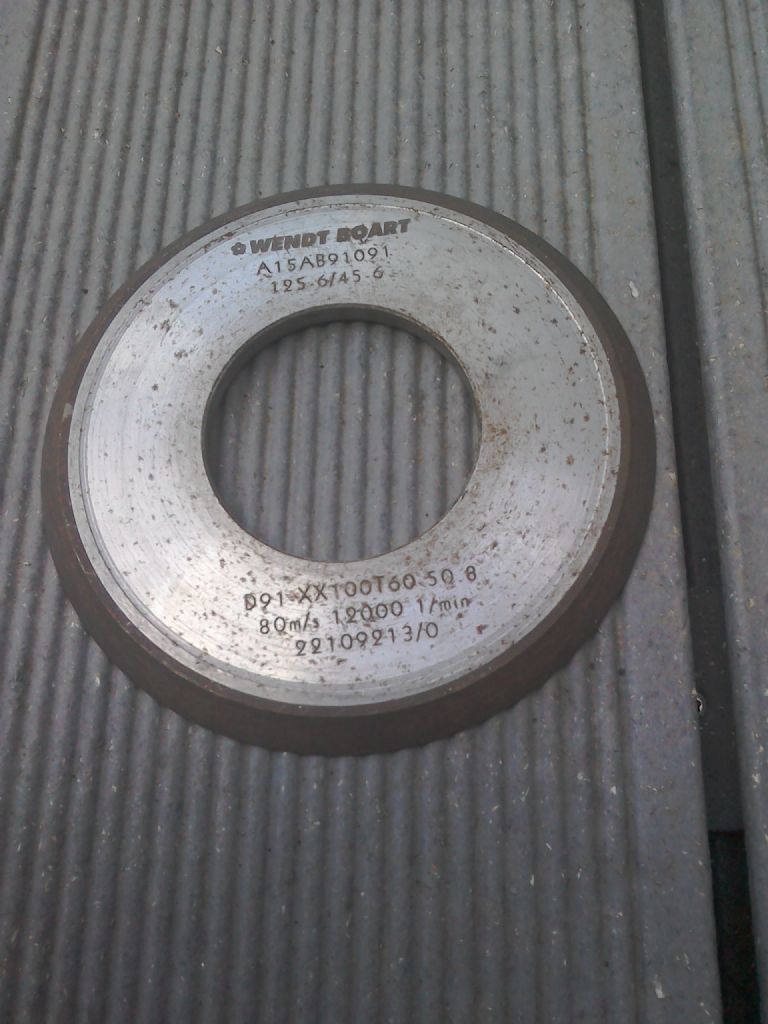

                                        You want something like this, don't know how much or where to get one.

                                            As far as I can see you need shape 11V9 **LINK** . Centre Abrasifs **LINK** sells them. They can be very helpfull and once made for me a small series of grinding stones for very little money but Google gives also other suppliers for that shape. Niko.

                                                I found 11V9 CBN wheels on ebay la-877109388934&abcId=1139126&merchantid=118974502&gclid=CjwKCAjw5Ij2BRBdEiwA0Frc9fM9qBPXTHmGhGxv6yJTxar1F0IVUi6GPPoUSGOaaUh3sD3Q4_TwyhoCPKAQAvD_BwE”>https://www.ebay.co.uk/i/174264707109?chn=ps&var=473272588092&norover=1&mkevt=1&mkrid=710-134428-41853-0&mkcid=2&itemid=473272588092_174264707109&targetid=877109388934&device=c&mktype=pla&googleloc=9041085&campaignid=9794971188&mkgroupid=98649237823&rlsatarget=aud-629407025185la-877109388934&abcId=1139126&merchantid=118974502&gclid=CjwKCAjw5Ij2BRBdEiwA0Frc9fM9qBPXTHmGhGxv6yJTxar1F0IVUi6GPPoUSGOaaUh3sD3Q4_TwyhoCPKAQAvD_BwE
