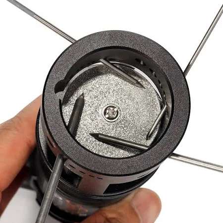

      Sharpening drills of 1mm and less diameter an easy way.
      Some are broke or blunt.
      I have a Tig tungsten grinder with diamond disc powered by Dremel type power unit.
      Wondered if with a suitable guide and drill held by a pin chuck I could use that.

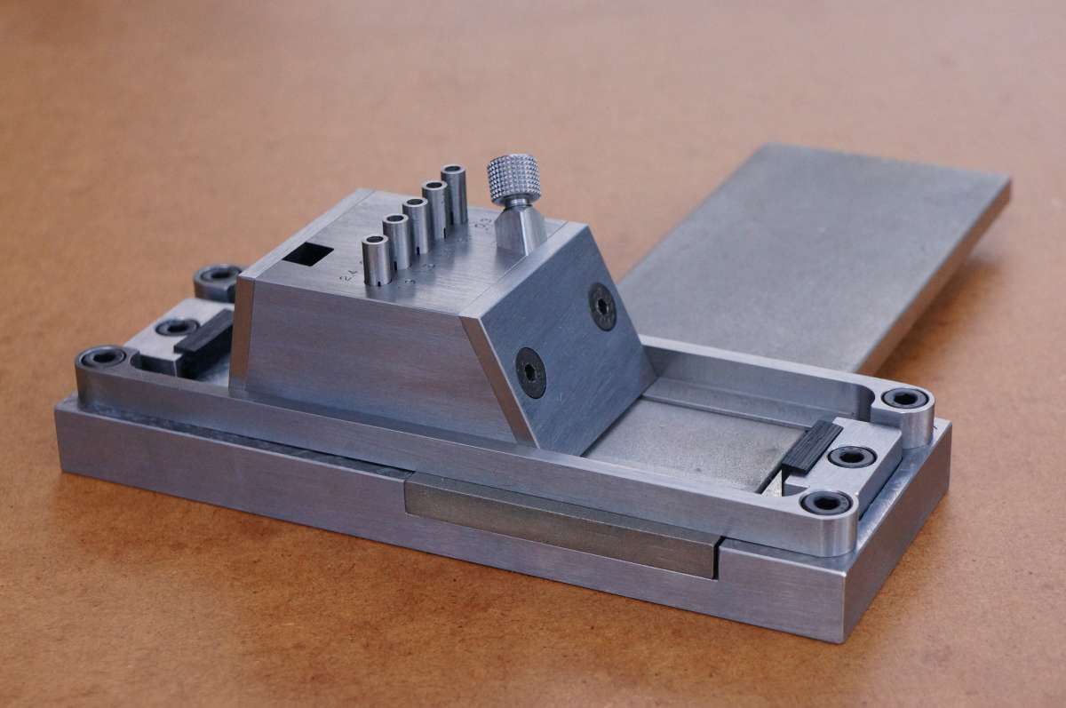

            The small drill sharpening tool designed by DAG Brown does the the kind of thing you are thinking of, but produces a four-facet grind which works better than the usual conical grind.
            2014-03-01_Small_Drill_honing_Tool_02

                  You could use a “Wishbone Drill Sharpener”

                    Wish mine looked as good as yours Charles but it still works really well and on occasion have sharpened down to no80 but that took a while to get right.

                      Lovely work on the DAG Brown sharpener Charles, a pleasure to see.

                        Wow, that looks great!

                            Your DAG Brown sharpener makes mine look pretty basic, but I like your modification to hold the collets, have to add that to mine, as currently the collets are just  lying on top of it and I am sure it won’t be long before one gets purloined by the workshop fairies!

                                Thanks for the link to the Wishbone idea, I like it  a lot.
                                Certainly easier than using a loupe and a stone, and looks to be more accurate once you get used
                                to setting it up. I see there is a 3d print one as well that would be appealing to those with a printer.
