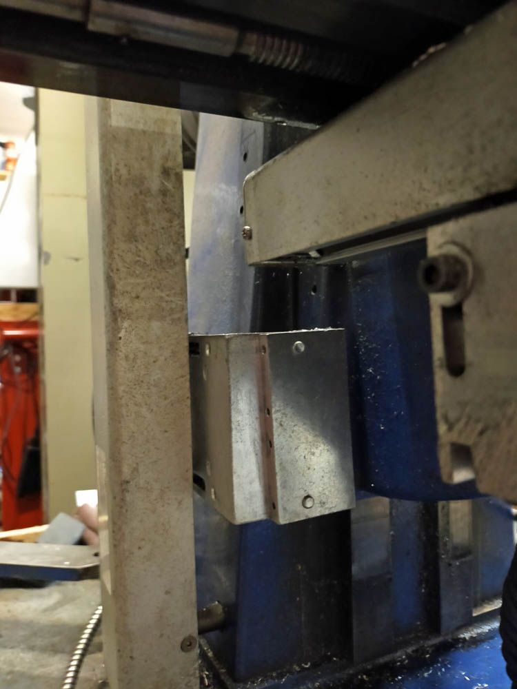

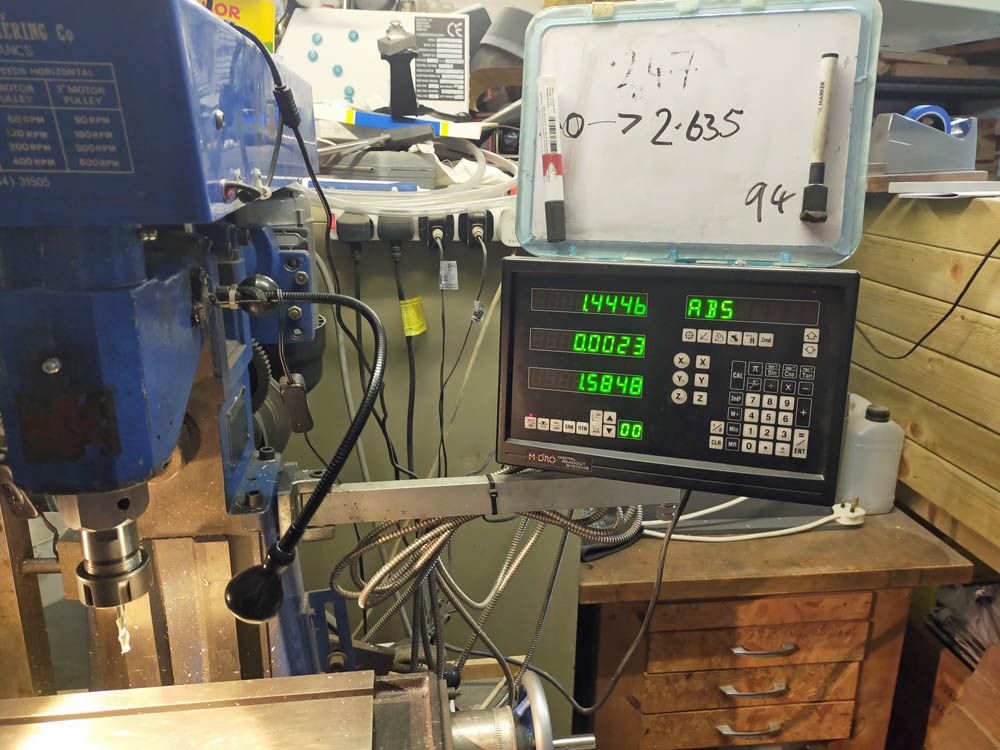

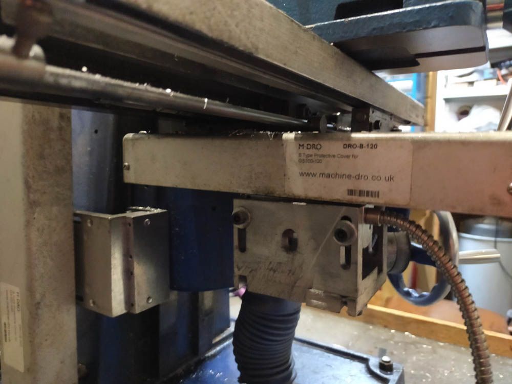

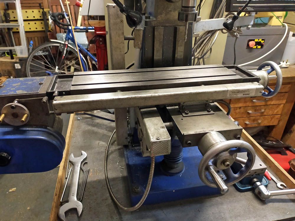

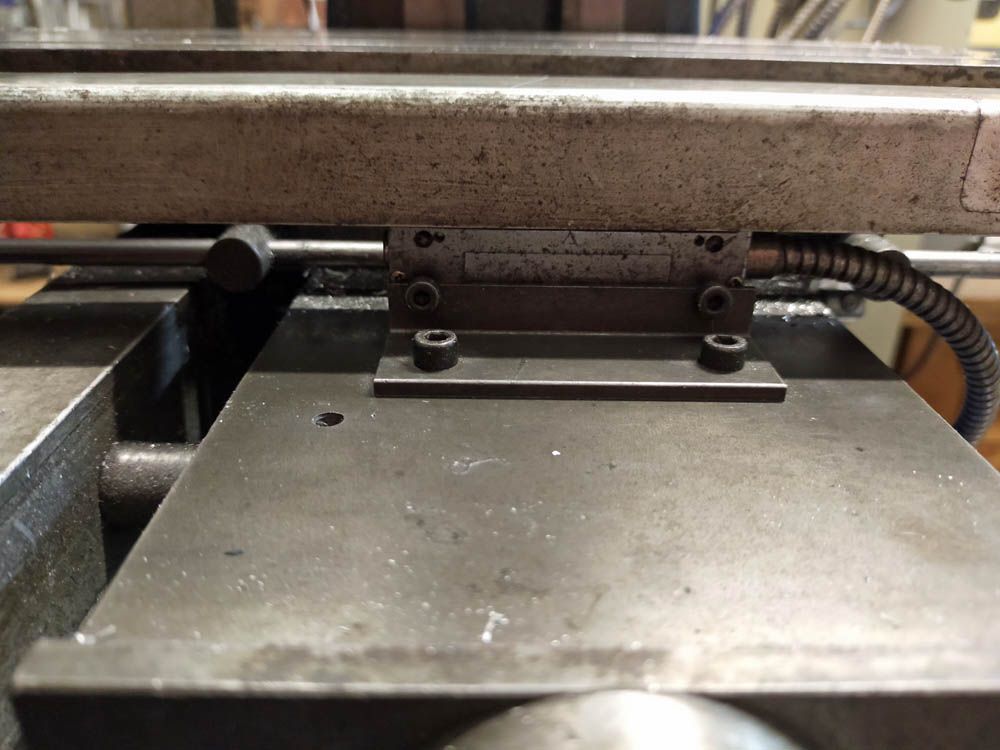

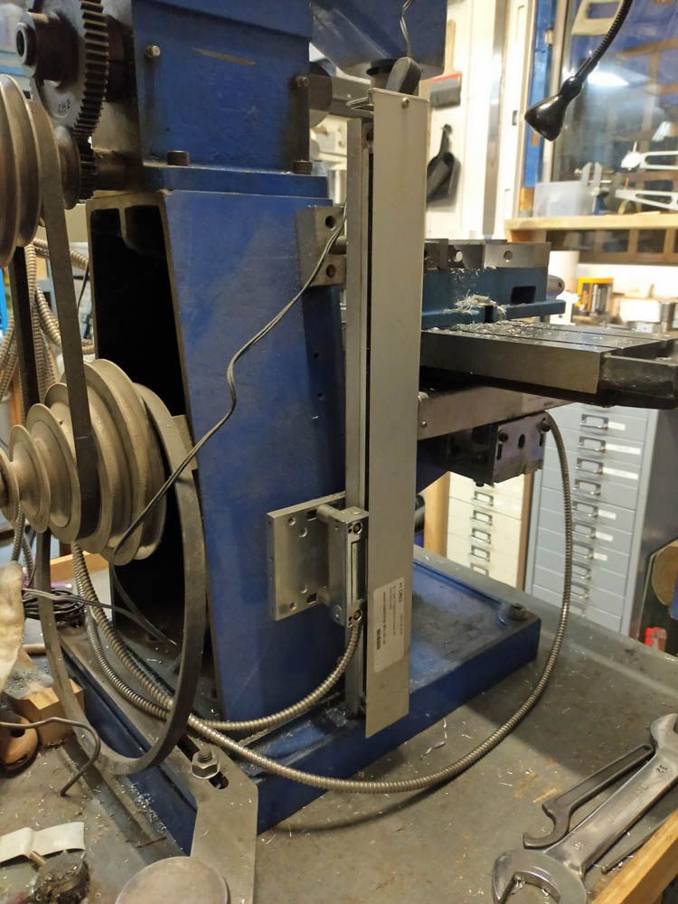

          Roger, here's a few more pics of the DRO. Z and Y are the standard glass scales but the X is a lower profile glass scale to stay below the table surface.

          Options have changed a bit since I installed mine. Magnetic scales could be an option.
          HTH,
          Rod
