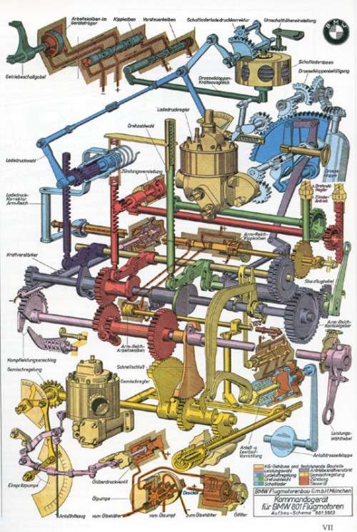

          Anyone know why the Merlin used carbs at all given the superiority of fuel injection?
          My guess is that, at the time, carbs were simple reliable technology, whereas injection on the BMW 801 engine required a fiendishly complicated electro-mechanical device called a Kommandogerät:
          fw190_kommandogeraet
          My guess would be that it was a matter of production engineering to a large extent. All those precision gears in the hideously complex German set-up require special gearcutting and shaving machines, which were in short supply in the war in the UK. Plus the injectors themselves required a lot of small precision grinding and the like to make them.
          Whereas, the humble carbutator could be diecast in any one of many existing factories or foundries and machined entirely on existing capstan lathes, milling machines and multi-spindle drill presses. Smaller components like jets and needles etc could be churned out on existing capstans, small lathes, screw machines etc.
          Remember, model engineers and other hobbyists churned out aircraft parts for the war in their home workshops, on ancient treadle lathes in some cases, or motorised versions there-of (Eg Drummond M-Type). Production capacity was running at 110 per cent!
          And there were longrunning issues with keeping up production of Spitfires to meet demand since very early in the war. The factories were horribly inefficient, as were many work practices. So quick and easy was the order of the day. Bit like the Liberty and Victory ships. UK designs but had to be built in the US because they could build them faster than the U-Boats could sink them, whereas British industry simply did not have the needed capacity.
