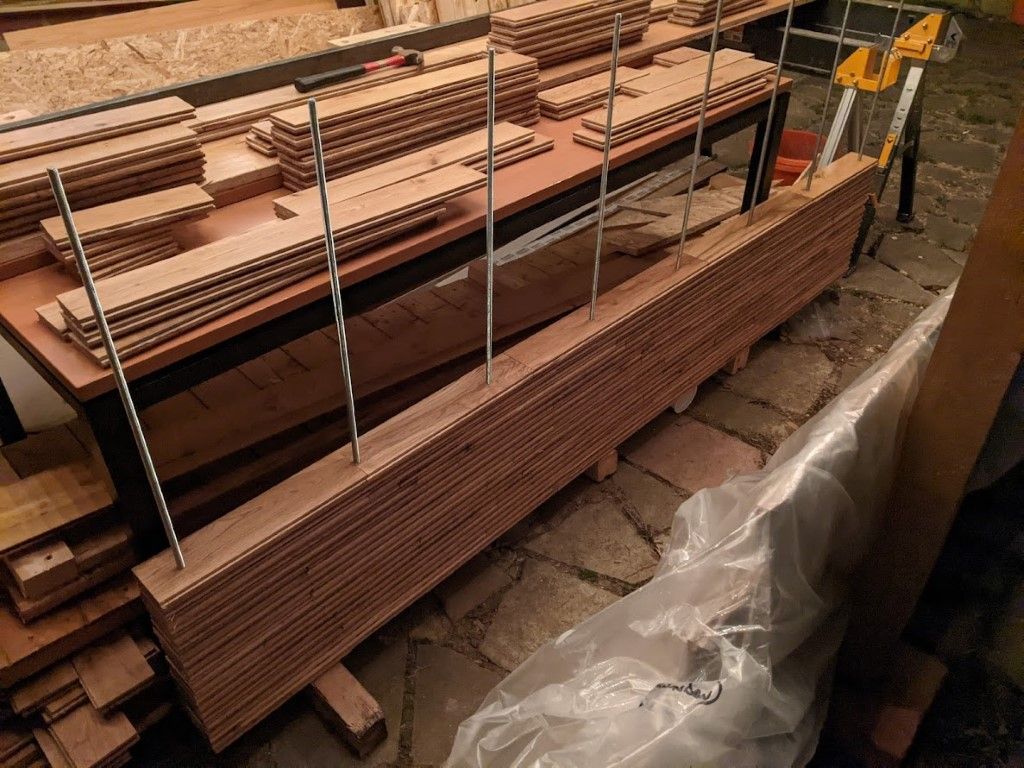

          Vic, as you can tell from one of my earlier photos my shed gets in a bit of a state when I'm actively working on something, but I try and declutter between things. You seem to have a nice patch of floor to work on though angel 2
          I have been working on the top for my workbench in the meantime. I sadly had to tear out the living room's wooden flooring after a leak forced me to. Nice floor too, I believe red oak. Obviously there was no way I was going to take that to the tip, and decided to turn it into a worktop for the shop. The plan was to stack the planks, tie them together with 10mm threaded rod, and then use an electric plane to flatten the tongues and grooves after.
          I made a template of evenly spaced out holes for the rods, and started tearing planks out of the removed sections of floor. Knocking holes in them, drilling those to size, and then stacking them into a top. Starting to get quite quick with it. I wanted to have some nuts at the 1/3 and 2/3rd mark to get the planks nice and tight together.

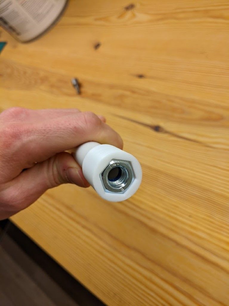

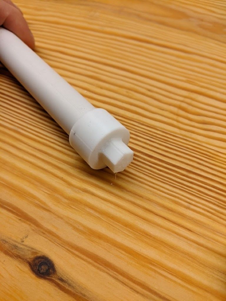

          I quickly realised that wrenching nyloc nuts onto 10x70cm of threaded rod was going to be an absolute nightmare. Seeing as I had some conduit left and a 3D printer, I knocked up two little adapters for a little socket I had for the electric drill and another that'd fit the nut with an opening to allow the rod into the conduit:
          After two iterations it worked brilliantly and made threading the nuts on a breeze.
          The top is coming along! Hoping to finish it this weekend so I can stop playing with the brown stuff and start cutting some steel!

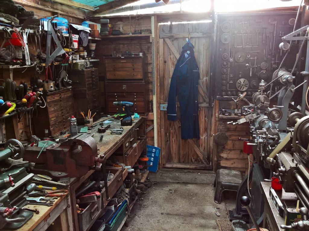

                A lot of my big stuff was obtained in the 1980's and then added to over the years, here is a view of my shed towards the door. Perhaps we should have a separate 'Show us yer sheds' thread smiley

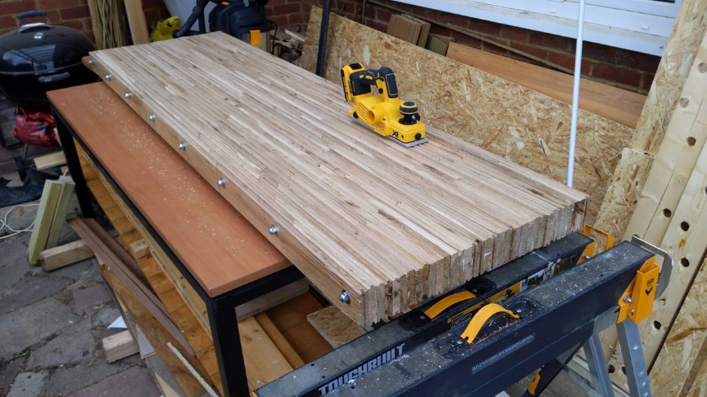

                  I particularly like all the little drawers, I'm still figuring out how I want to do something like that. I'd lvoe to build custom-fit steel drawers as I have a bunch of nice drawer sliders I salvaged off an old file cabinet years ago. The problem is I don't have a box bender or the place to store one. I may just have to by some…
                  In the meantime, I have finished the top. It must weigh about 120 kg (or about 19st in old money) or so, maybe a little more. It's a pain to move but it'll make a brilliant benchtop! Now the arduous task of planing begins. When I got the plane it seemed useful to get a battery one to match some of the batteries I already have so as not to deal with the cord. But it uses so much power it eats through those batteries very quickly. Starting to second guess my decision. Ah well, we'll called it forced de-hurrying (as my mom used to say)
