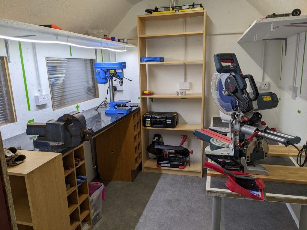

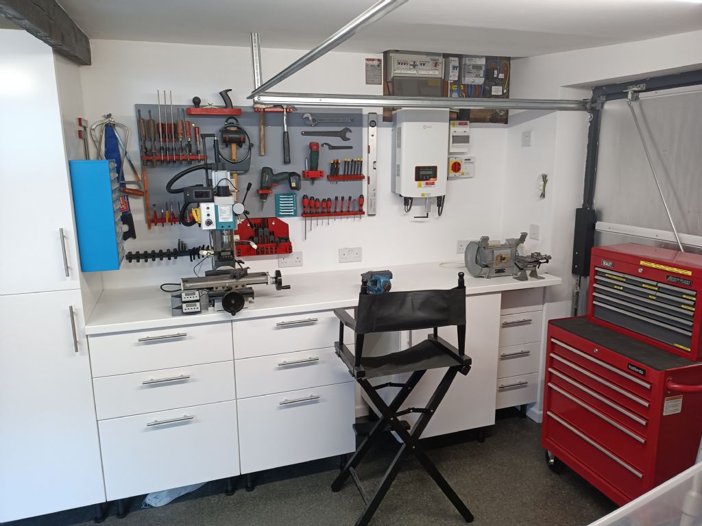

      Hello everyone,
      I'm new to the forums. If this is not the right place for this, please let me know. It's not exactly model engineering, but a bit of a prelude.
      Having purchased my first house in 2020, I've finally gotten to the point where I can turn the large-ish (~3×2.4m) shed it came with into a proper workshop. The shed was damp and subject to massive temperature swings, so before getting any proper machinery in there I decided to insulate it all. Building materials are currently as pricey as they've ever been in recent history, but life is short, so I went ahead…

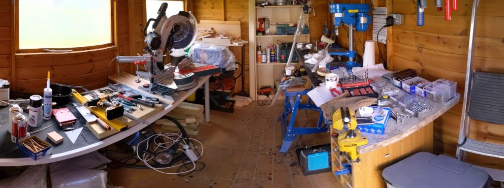

      This is the shed when we moved in. Having been in an apartment since I moved out of my parents' house I was very happy.
      And soon put it to good use. It's only this messy whilst actively using it!

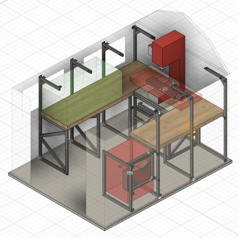

      Drew up plans to make sure everything will fit. The green box is where the lathe will go, space for a mill at a later point has already been reserved. The red box at the right front is the (huge) mitersaw folded down, to more effectively use my limited space. All the frames will be welded mild steel 25x50x2.5mm. The worktops will be made (as far as material goes) from out old flooring I had to sadly rip out due to some water damage. It appears to be some type of hardwood so should make a nice heavy benchtop.

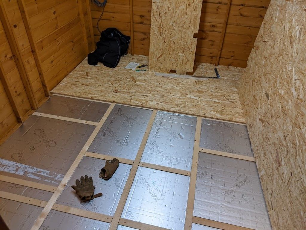

      The first step was to stud out the floor to make sure there's proper support under the bench stands, and insulate in between. 18mm OSB over that to be finished later with vinyl flooring. The existing shed floor is quite densely studded on top of a concrete slab, so should be fairly strong and solid.

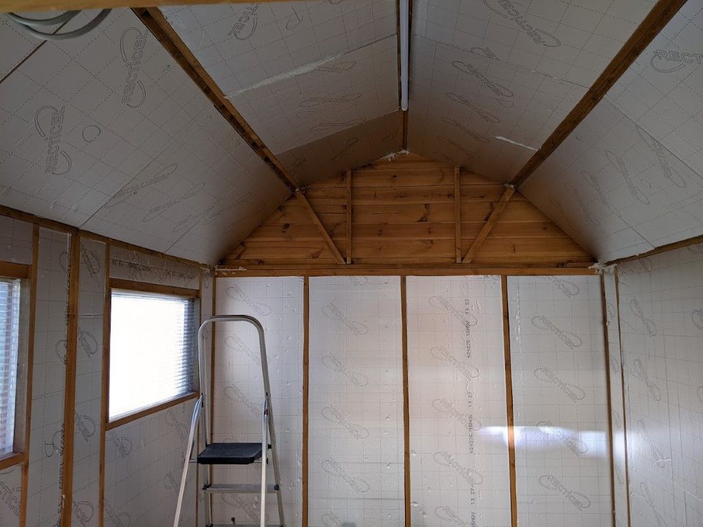

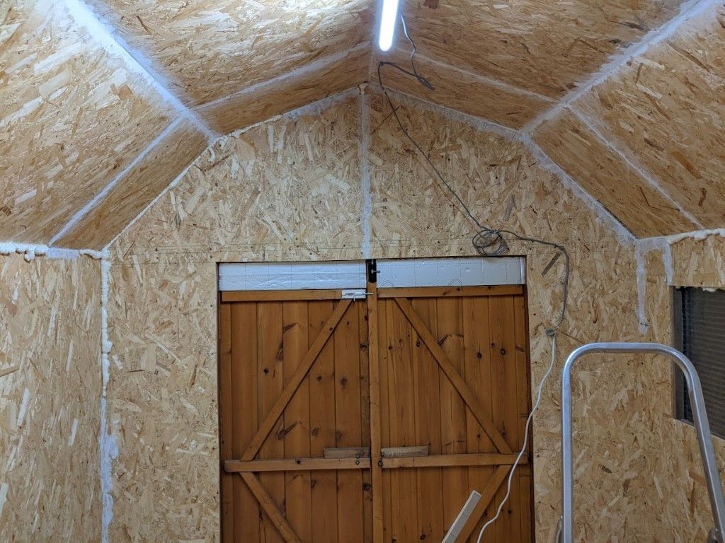

      Then insulated the walls and ceiling. There is expanding foam in all the little nooks and crannies.
      And clad everything in OSB, filled some more gaps (nothing was straight in this shed!) and puttied the seams.

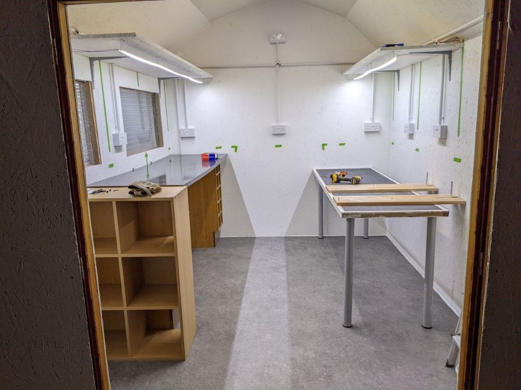

      Added a lick of paint to keep everything nice and bright and bright and started on the electrics.

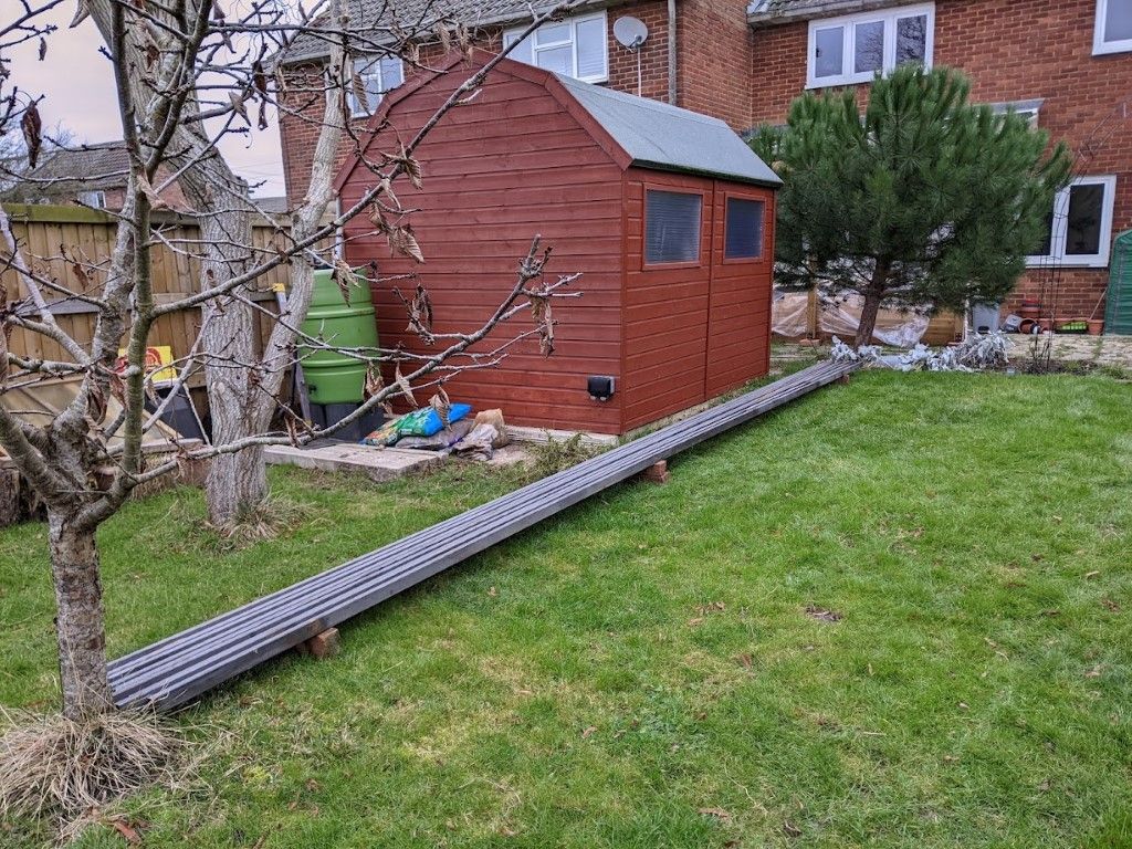

      200kgs of steel for the workbenches was delivered. No covered space for the 7,5m lengths so they are under a tarp for now…

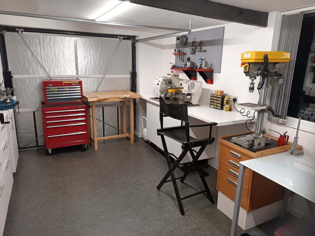

      Interior now mostly done. Put up temporary supports for the shelving so I can have some light as I manufacture my benches. The LED strips are very bright, should be nice to work under. Note the green tape is the future supports and worktop placement.
      Finally put some tools back in place.

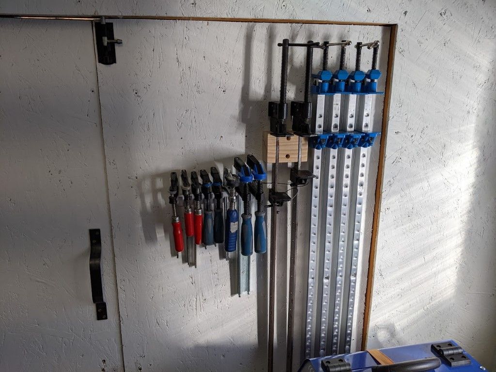

      And manufactured some custom mounts for my hodgepodge of clamps and a door handle.
      I'm currently in the process of laminating old floorboards into a worktop which is a lengthy process. That'll free up some space under my awning so I can get started on the steel after. I'm hoping to have the first bench in somewhere in March so I can order a lathe for my 32nd birthday.
      I've got a google photo album with more/bigger photos here for those interested.

                Brian, I do believe it's called a Dutch barn style roof, but named after the Pennsylvania Dutch who are actually German dont know

                        consider making it a bit more burglar proof ,bars on windows,and make the doors and hinges a lot stronger,line the doors with plywood,its tougher and stronger than other composite boards,lot of shed theft around our way,its easier nowadays to break into a shed than a house.and use close shackle padlocks.
                        #583342
                        DutchDan
                          @dutchdan
                          I've been having a look at getting some heavier hinges with security bolts on there. And mad weld up some bars for the windows. The windows are multi-layer polycarbonate so shouldn't be too easy to get through. The doors are now clad in OSB so should be plenty strong. Hinges are just screwed in on the outside so pretty useless there.
                          Having no direct access to the garden, however much of a pain when getting materials in, helps here. They'd have to go over my neighbour's wall and then the fence between our gardens. I've now installed a security light as well.
                          That being said, I will be taking some additional steps.

                            Security:
                            I have window and door contacts in the summerhouse, connected to the house alarm. I had movement sensors at the beginning, but a few false alarms made me change that into door contacts. (even a sturdy summerhouse lets enough air in so that objects hanging from the ceiling (some of my model aeroplanes) start moving in a storm. And they do that when you are on holiday of course…
                            I also modified all hinges replacing some of the screws by coach bolts which went through the wall. Originally all hinges were screwed on from the outside. I don't know why the manufacturers of summerhouses do that,
                            it is an invitation for intruders.

                                          All in favour of insulation. Stops or minimises condensation and keeps the place cosy.
                                          My shop is about the same size and a 2 Kw fan heater soon brings it up to a comfortable temperature.
                                          It was painted gloss white when first built, walls and ceiling, to make it as bright as possible.
                                          It may be a good idea to put in a couple of small floor level m,vents so that moist air can exit, rather than accumulate.
                                          I also have a 6" intake fan, mounted high up, when additional ventilation is required . The exterior vent has a long, downward pointing, hood to prevent ingress of rain.
                                          Internally, it now has great similarity to Rubik's Cube.
                                          Power is supplied from a RCD in the house, to a ring main above the bench, feeding no less than eleven double metal clad sockets. The one supplying the VFD for the lathe is a suppressed one, to prevent any nasty "spikes" being fed back up the mains to the detriment of our house and any other on the same phase.
                                          One day I should fit a proper Garage unit to supply the lights and sockets; but tomorrow never comes!
                                          Lighting in addition to the work lights on the machines, and above what little of the Fitting bench and Vice can be seen above all the rubbish, is by two individually switched 4 foot 60 / 85 watt fluorescent tubes.
                                          Should really replace with LED tubes!
                                          Security is important. You do not want the damage caused by breaking and entering, or the loss of items which have cost a lot of money and / or time.
                                          Make sure that the doors are sturdy and not easily distorted.
                                          If need be, have two hasps, or bolts, at the upper and lower quarter height points of the doors, that can be fitted with good quality padlocks.
                                          Use coach bolts, with domed heads outside, so that they cannot be gripped and turned, with the nuts inside; to secure the hasps or bolts, and the hinges..
                                          Fit hinge bolts to both doors. I made mine by turning off the heads of substantial woodscrews, and used a drill chuck to fit them (2 per door ) to the back edge of the door, so that about 12 – 15 mm protruded. Trying to close the door marked the post where a hole needed to be drilled, to accept the hinge bolt.
                                          In this way, once the door is closed, driving out the hinge pins still will not allow the door to be lifted out (My door is actually a fire door with a 6 lever lock! )
                                          With regard to windows, my shop has no windows, allowing full length shelves.to be fitted, to maximise storage space, My shelves had been the bargeboards for a neighbour's house, so can carry the weight of what is placed on them..
                                          It might be a good idea to have internal removeable shutters for the windows, so that when the shop is shut, prying eyes cannot see what is inside to be stolen!
                                          HTH
                                          Howard

                                            Howard, I do need to have a look at ventilation. I have a dessicant humidifier in there so not worried about humidity. But air quality is an issue as the shed is practically hermetically sealed at the moment.
                                            Power right now is using a line that was already there that was obviously put in by a sparky. It does seem to be spurred off of the ring main for the downstairs socket, so I will be putting a dedicated line in at some point and have a sparky sign off my work (well, that is the plan). But as it's fused at entry and once outside I'm not concerned with safety now. I've worked under an electrician in the past so am confident my wiring is safe.
                                            The windows are impossible to see through, it is 4 layer "multi-wall polycarbonate". Insulating as well. I didn't want to close them up entirely to let natural light in, but I'll probably put shelving up over it. If I put a beam across bolted between the upright that should prevent anyone from crawling through.
                                            I've been looking at ways to secure the doors more. Will definitely start with beefing up the hinges and putting coach bolts through. Great idea to put hinge bolts in as well! Will definitely do that.
                                            Maybe I should run some metal mesh hooked up to the 230 in the door as well. That'll scare of any cheeky burglars taking larger tools to the door laugh (dear police, this is a joke)
