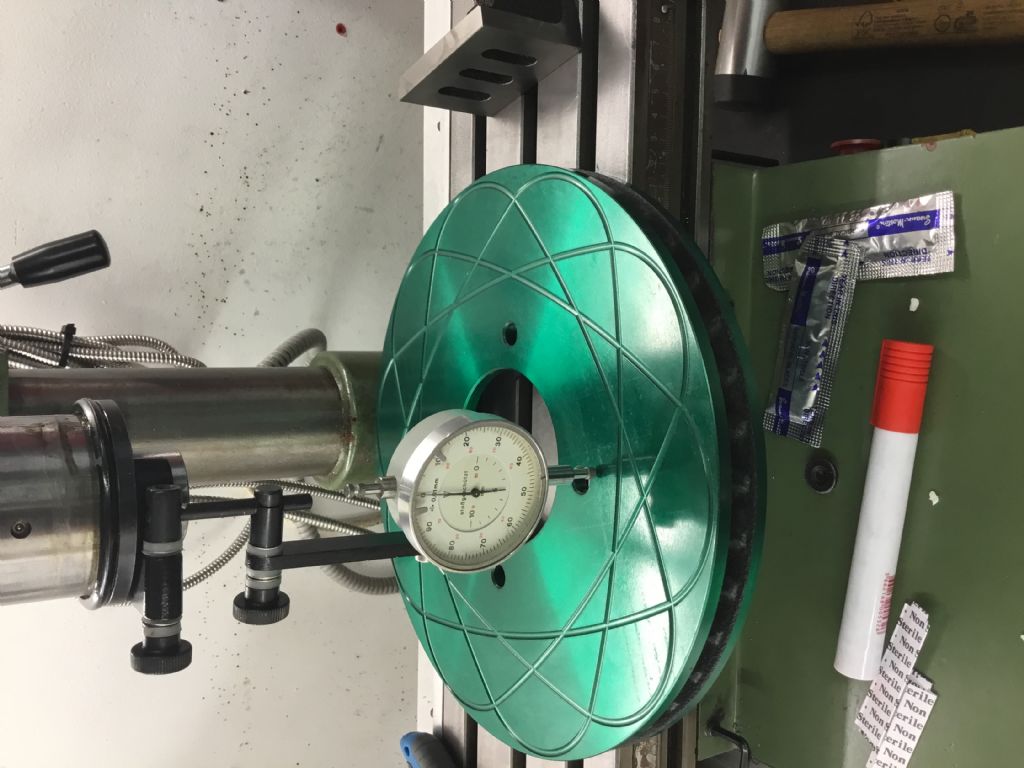

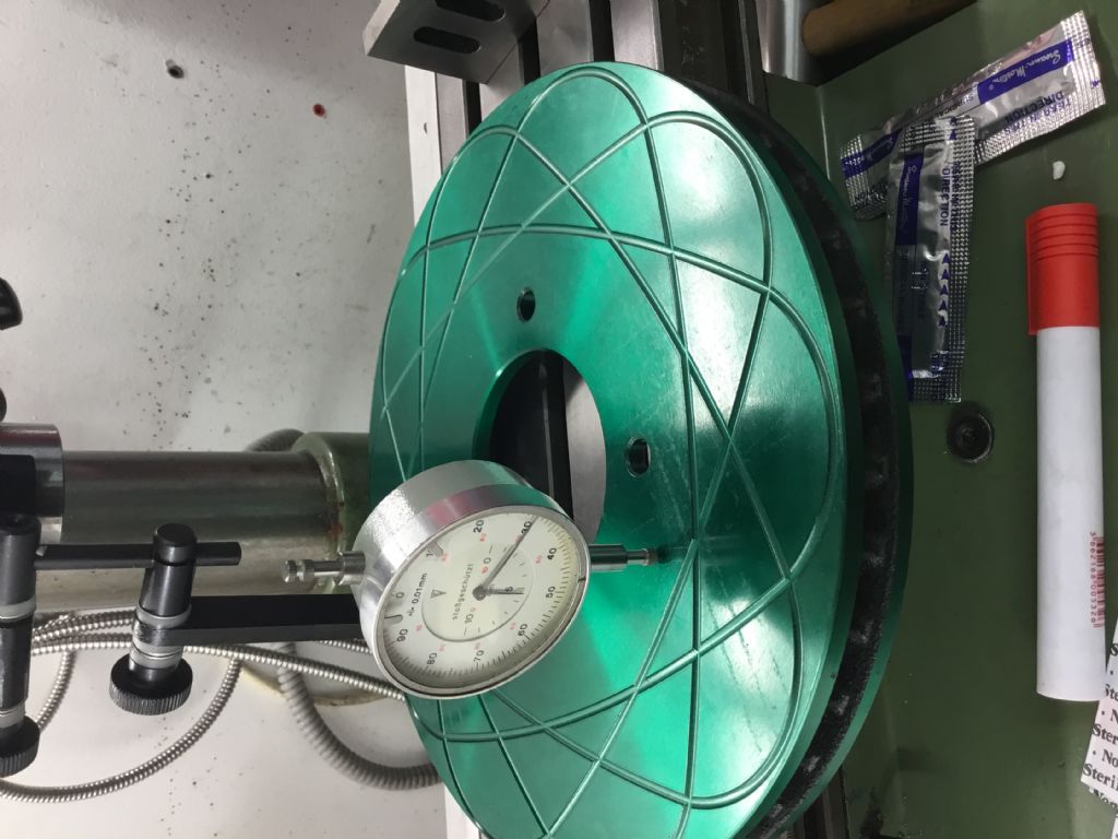

        Hi I spent this afternoon trying to get a better set up / understanding of my mill.
        First I checked x axis witch is fine, I the wanted to check y, I put a new brake disc down , the checked y found it to be out by 0.02mm really happy. Then things started to happen.
        when I zeroed my DTI buy lowering the head, started to turn the spindle it dropped by 0.3mm, this did not happen when I raised the head.
        I started to look and can get 0.3mm free play in the spindle, so thinking I should tighten the spindle using the clamp at the head, great it stopped the movement, but now I have 0.08mm over 150mm swing on the y axis.
        is there something else I could try and get rid of the 0.3mm on the spindle.

          Do not accept that the brake disc is perfect. I have measured new ones and they can be several thou' out. I would suggest you tram the table 1st using either the table itself or a known good large parrallel.
          Try to use an indicator in a collett in the spindle. IMHO The holder you are using is not the best way as they are not as rigid as they seem.

            Definitely take off the fancy looking green disc, is the .3mm free play with the spindle locked?? Tram off the table itself with the spindle locked, using an nicely ground object to bridge the tee slots.

              Hi when the spindle is locked there is no movement, I can check off the table, but why a difference when I lock or unlock using the same disc and not moving it?

                I would guess the quill is loose in the mill head & tightening the clamp pulls it to one side? As I said check the tram with the quill locked as this is the way you mill.

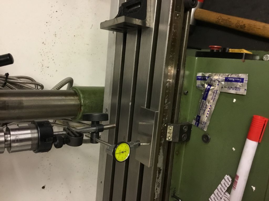

                              okay could not wait until tomorrow, this is the set up and this is what I have found.
                              spindle locked. Zero as shown, when turned 180degrees it shows 0.1mm out,.
                              spindle unlocked zero as shown, 180 degrees 0.09mm so not much difference. But movement on the spindle 0.3mm
                              is 0.1mm over the width of the table acceptable?

                                  Ok, just a small point but have your DTI stylus nearly horizontal not nearly vertical as you have it now. I would not be happy with .1mm over the table width but that is me, if you want it better then you will need to shim the base which holds the round column, there are multiple threads on this subject. Your mill is not a heavy weight job so you are able to flex it by push/pulling the head.

                                      Check the column to base bolts are torqued properly.
                                      It's possible to adjust tram on a 'non adjustable' mill by changing torque values (if that doesn't work you may also have to shim different quadrants of base)
                                      I got my mill drill with an 'inspection chart' that was pretty worthless but eventually got it near perfect by thinking about which bolts to tighten and loosen. The various sections of cast iron will distort tiny amounts but can be set pretty accurate (less than0.01mm over 8" swing)

                                          As Tony said the DTI probe needs to be close to horizontal if you are you get anything near accurate height measurements. The cosine error with the probe as close to vertical (as seen in your picture) must be significant!
                                          A plunger type indicator is possibly a more suitable device if you want to measure absolute distances, lever types are good for comparative readings but since you are using a block under the probe that will allow the probe on your DTI to be set parallel to the table surface so the height readings should be quite accurate.
                                          I usually indicate directly of the table surface, sicne we are only looking for height changes in tenths of a mm I have never found the 'T' slots gaps a problem as the probe ball tip will cope with half a mm easily.

                                            Update, been working on the mill today, after shimming and torque the bolts I have the y axis at 0.02mm over 150mm, which I think is a great improvement from yesterday, worked in the x axis and over 500mm I have 0.06mm. Change my DTI to plunge type held vertical to give better results
                                            this is with the quill clamped, so I think the will be better than my machining capabilities. Theses measurements were taken with the quill and head in low position to the table, out of interest I raised the head and extended the quill to full amount, no great deal of difference possible 0.01 added to both readings.
