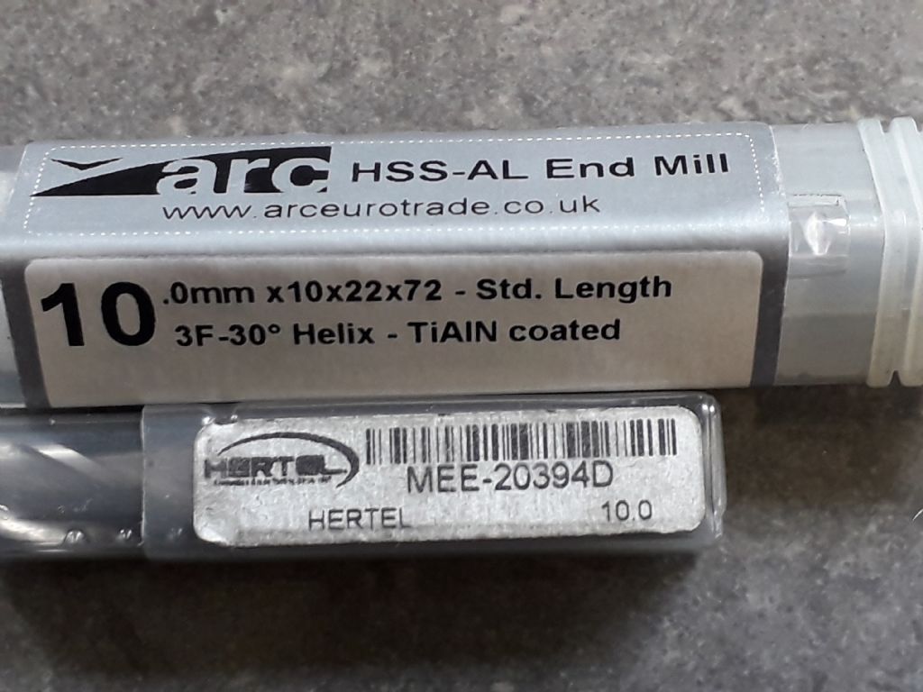

      The biggest unknown is still that bit of tool steel do you have any mild steel of known spec to try cutting? Better to eliminate that unknown before mucking about with the machine.
      I’ll get some steel off EBay next week.
      TBH it’s a simple job to remove the column shims and repeat the test. If it’s the same Ill just replace them.
      Re. The cutter – I get exactly the same results with the brand new ARC cutter I got last week (similar spec to the ball nose), albeit that is 10mm not 12mm.
      I suppose I’ll have to buy another set. Any recommendations?
      Thanks.

        Can I suggest you go to M-machine for your steel just to be sure what you get is as ordered. Excellent service, good pricing and they carry a large selection of material. If you go to their website you can download the catalogue and you will see the various grades listed against the types of material.
        The 10mm cutter I used in the video is from the ARC premium range HSS 3 flutes TIAIN coated £10.36.

                As for Cutters ARC's premium have been mentioned a few times in this thread and the standard length 3 flute that Ron mentions would be a good all rounder and just for risk of being called bias this 10mm 3-flute "disposable" is another alternative., I use both but would suggest you don't go at the iron castings with these until you know if there are any hard spots under the surface, keep the Tin ones for that.
