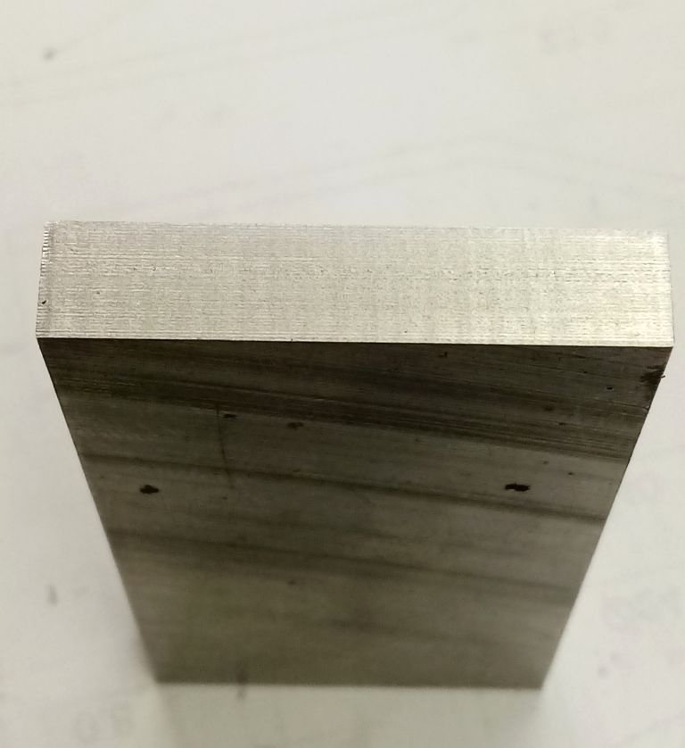

                          Ok another one:
                          I made the first bit of fixturing for the 10V – a simple rectangular piece of unhardened tool steel about 5mm thick, with two holes in it.
                          I began by mounting the sawn piece on a long edge in the vice and face milling the other long edge, then turning it through 180 degrees and repeating the process. No problem at all. Quiet, smooth machining, nice finish and parallel to the limits of what I can measure.
                          Since I wanted the piece to have square ends, I thought I'd simply turn it 90 degrees, and mount it flat in the vice, on parallels, and side mill the short edges. This was hopeless (as it was with my vice clamps). I got a load of noise and chatter, and terrible surface finish. Cut depth was about 0.5mm. Steady feed. I was using a 4 flute slot drill.
                          Any comments? Cheers.

                            Assuming it's not a cheapo cutter there are a couple of possible reasons:
                            1. Too slow a feedrate, with shallow depths of cut you can really ramp up the feedrate, search for chip thinning to see why. With a 4-flute cutter I'd be feeding at more than 500mm/min assuming the cutter is carbide and is running at 2000rpm.
                            2. Climb ,milling will generally give a better finish, especially in sticky materials like some low carbon steels, in particular EN3B.
                            Andrew

                              But with your mill, climb milling might be a tad courageous unless you have the gibs very tight. Problem is that the cutter force pulls the work into the cutter if there is any backlash in the leadscrew so the cutting depth suddenly gets much bigger. Common practice with cnc and if you have ballscrews, but not so common with a manual mill with conventional screws.

                                  The cutter is a Sandvik 12mm slot drill, used only a couple of times on aluminium.
                                  Regarding feed rate – I tried slow, and fast – fast like I was in in a comedy film. Same result.
                                  No way I'd try climb milling on my machine – I did it once by accident, but wont be doing it again – the backlash in the leadscrews is terrible even after adjustment.

                                      I'm afraid I regularly climb mill on my old X2…
                                      Only experience and a few failures will teach you when you can and when you can't with a given machine.

                                        It might well be the cutters. I'll try it again when the new ones arrive. Unfortunately I decided to make a start on all this with the few cutters I had from experimenting with the vertical slide on the ML7, and delivery of new ones is obviously a bit hit and miss at present.

                                              Posted by Dr_GMJN on 11/05/2020 14:02:43:
                                              0.5mm in what looks like 6-8mm thick "tool steel" is probably pushing it for the SX2, try half of that (but should be OK in mild steel )all non moving axis and quill locked and use the top of the cutters flutes not the bottom end to reduce overhang as much as possible
                                              You have only mentioned adjusting the gibs, have you adjusted the split nuts that the leadscrews run in?

                                                I adjusted the split nuts back in September when I first got it. I suppose I could try again, but the difference between smooth and sticking was a pretty marginal tolerance (much like the gibs). To be honest there’s only so much adjusting I can take; after a while it seems like I’m back where I started. Either way, would backlash cause an issue for conventional milling? After all I’m pushing the cutter with the lead screw flanks at a fair rate, and it’s not trying to move Itself away from contact by rotation.I do lock the axes I’m not using when machining.

                                                  Should not affect traditional cuts much.
                                                  What slideway lubricant are you using?
                                                  Have a look at these 3 videos I did to go with the beginners series, although it is the SX2.7 it should give you an idea of the type of cuts these machines can take and types of feed rate. EN3 mild steel and a fairrly cheap HSS 10mm 4 flute cutter

                                                    Thanks Jason, very helpful. Could well be depth of cut. Maybe I underestimated the tool steel.
                                                    I’m using “Slidex” – I got it from a local supplier years ago. Same place gave me some “Hydex” for the ML7 drip Oilers. Both seem to work fine. It’s a shame the mill doesn’t have oil nipples like the Myford. Guess I could add some at some point.

                                                      This morning just as a quick test I put up a piece of 8mm gauge plate on my SX2P and tried a 0.5 mm deep edge cut using a 10 mm 3 flute HSS TIAIN cutter from the ARC premium range.
                                                      No issues at all the mill sounded and felt fine which is something I always go by. I went with 1250 rpm and a steady not too fast feed. I tried it at slower speeds but it was best at 1250. A picture below of the finish which I can't detect with my finger nail so good enough I think.
                                                      p. s. I forgot to say going by the hanwheels my machine has 0.2 mm backlash which never gives me any problems and with the DRO, s I am lazy and tend to ignore it. Also I sometimes climb mill for a better finish but nothing too heavy. I guess I really should try to reduce the backlash before it catches me out.
