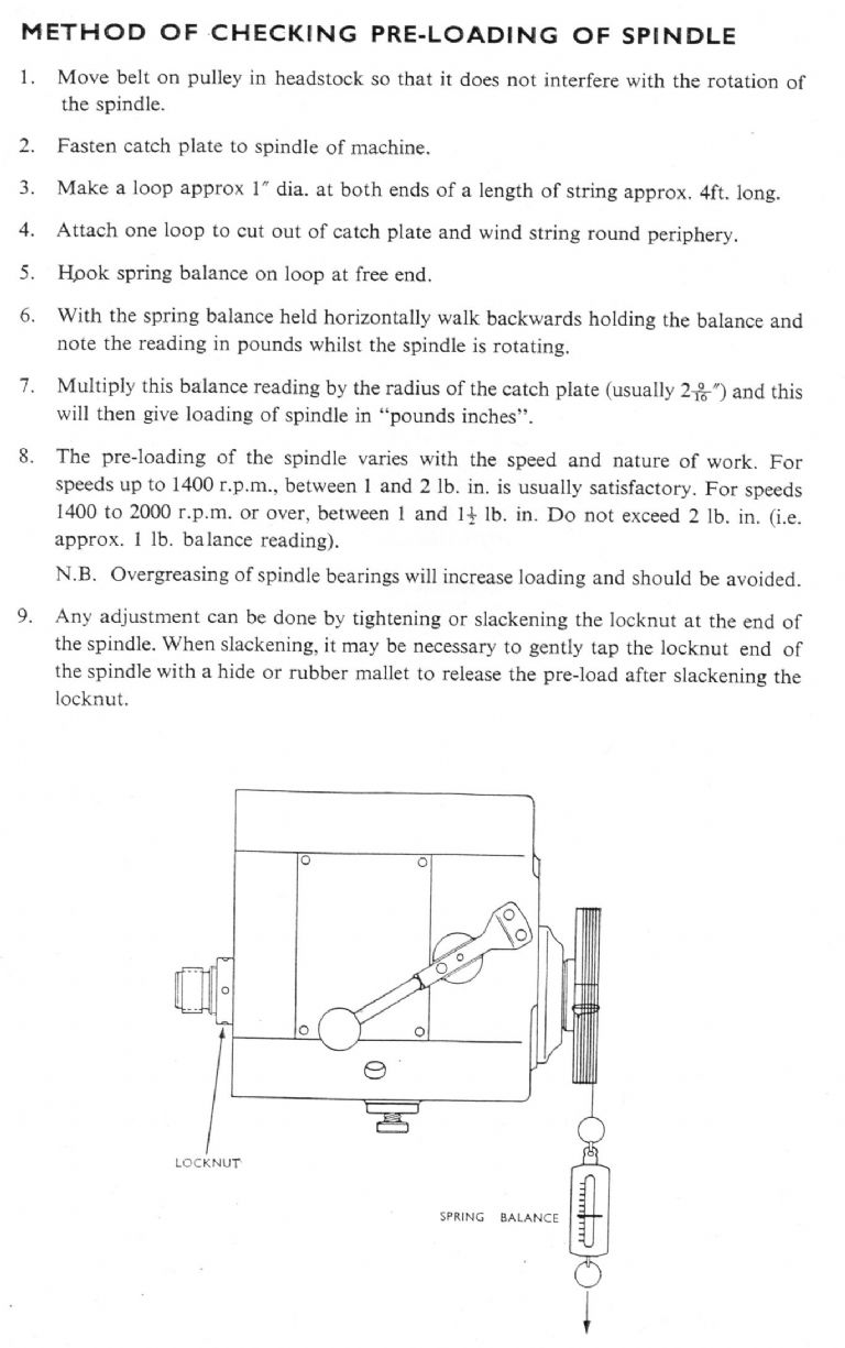

      This may sound like a naive question but I've never seen it spelt out. I've recently changed the angular contact bearings in my Myford Super7 for taper roller bearings. What is the correct procedure for setting the right preload? I've tightened everything up to remove all trace of movement but not tightened it beyond that. Is this correct?

                                  I had to adjust the bearings many (30) years ago on my Boxford lathe. I followed the instructions that were in the manual for the lathe (that I no longer have so cannot refer back to it). If I remember correctly, it consisted of wrapping a thread around the spindle and attaching a spring balance and then pulling on the balance to cause the thread to unwind. The spindle was adjusted until the required reading showed on the balance.

                                      Hi Norman, I think you are refering to this one for the Boxford.
                                      Regards Nick.

                                                      My Atlas has Timken tapered roller bearings from new and is only slightly bigger and a similar design to a Myford.
                                                      The official procedure is as follows:
                                                      Run the lathe for 30 min to one hour to warm up the spindle. Loosen the thrust nut and then tighten until the end play just disappears. Tighten a further 1/16 th of a turn and lock.
                                                      The thread on the spindle is 20 tpi so 1/16 th turn corresponds to about 3 thou.
