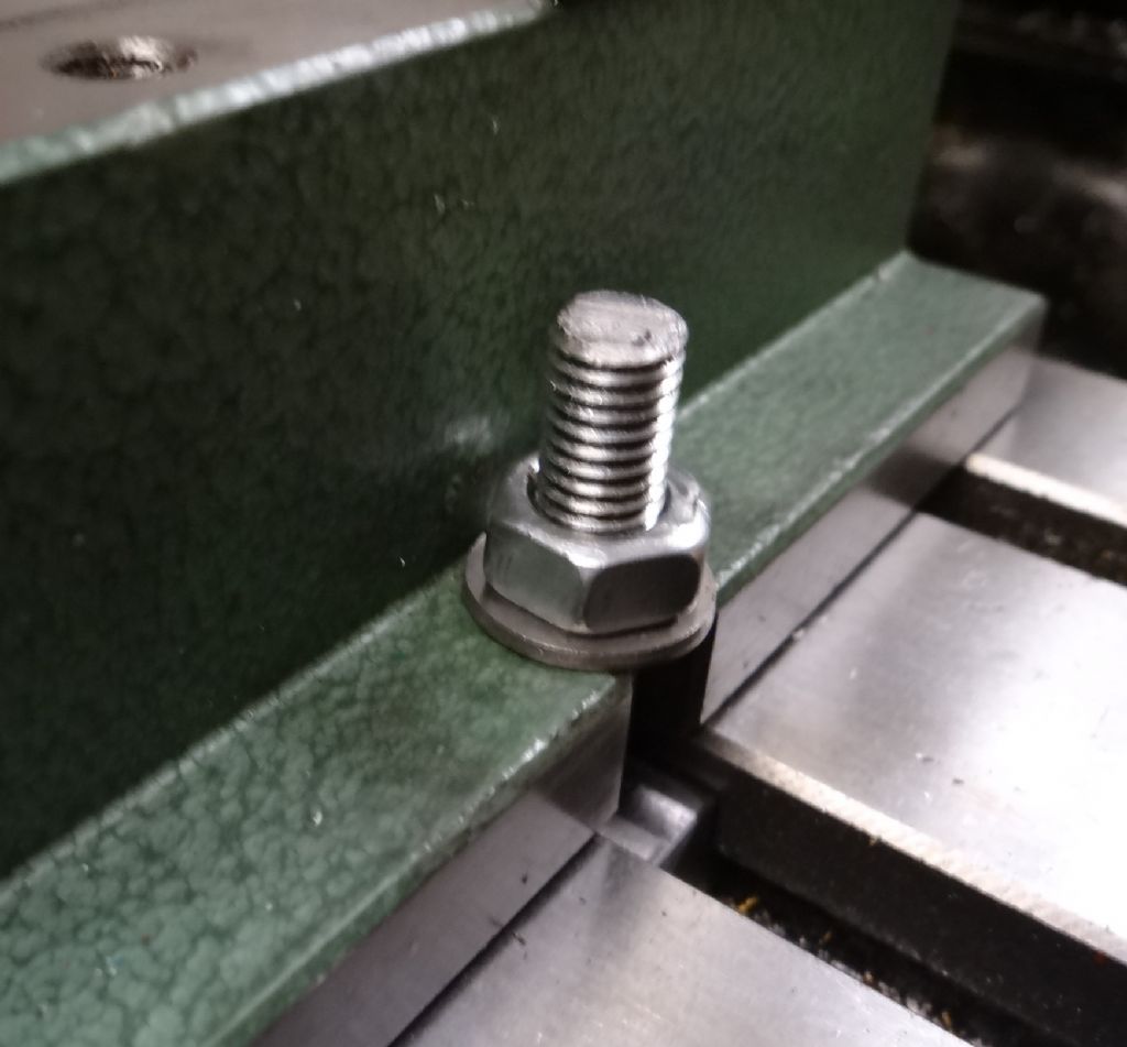

                                      I bought a relatively inexpensive Soba (Shoba) vice from Chronos. When I got round to checking it I was pleased to note that the nicely machined mounting holes were parallel to the jaws. I simply turned a pair of press in sleeves to fit the slots in my mill. Simply placed on the mill and bolted down it’s within one thou parallel. Not sure why I bother but I normally “fuss” it until it’s spot on.
                                      I have to wonder if a budget manufacturer can make a vice with accurately machined mounting holes why can’t some “premium” vice manufacturers do it instead of nasty as cast slots.

                                        There's a lot in that Mike. I got into trouble using exactly the same method as Andrew. Be nice to blame my Chinese made mill and vice, but it's not true. Most of my disasters are down to me!
                                        In the other thread I reported taking about 40 minutes to set my DH-1 vice and theorised the problem was due to the washer. Michael Gilligan suggested burring, but that's the photo exaggerating loose paint. This is the suspect washer, it is tall and narrow. I suspected it was rocking and causing the vice to jam rather than swivel when tapped.
                                        I replaced the washer with an ordinary one and took 6 minutes to align the vice including time wasted swapping the washers on both sides. The new washer hasn't eliminated the problem but I found that alternating taps between front and back doesn't cause sticking.
                                        Andrew advised "The left side clamp is done up until it bites, and then a bit more. The right hand clamp until it isn't loose." This is exactly what I do, but I'm wondering if the bite part is critical. When the vice is tapped, I want it to swivel, not slide. I'm wondering if tapping causes the vice to slide as well as turn because left clamp isn't tight enough. Possibly setting the optimum torque comes with practice
                                        Never had a problem aligning my other vice, maybe because being heavier it has more inertia.

                                          Hmmm…just had a thought (rare)..I wonder if a bearing on a rod in the quill could be used to line a vice quickly..

                                              I like that idea. Been meaning to do something similar for "not telling you how many" years. But I find simply pulling the vice hard back so studs are tight against both lathe Tee slot and vice mount slot always gets me to a thou or so in four inches error. So hardly seems worth the bovver.
                                              Of course I left the swivel base on so getting the basic adjustment right was easy. As is tweaking when it has to be dead nuts right. But I have a Bridgeport so loosing an inch of vertical clearance matters not at all.
                                              This ease of tweaking is the only real justification I can see for the conventional swivel base. Theoretically it can be used as a sort of poor mans rotary table I suppose. But who does that? I might have done it once in 30 years.
                                              Wonder how well re-working one vice slot to carry a fixed pivot would work. If the opposite slot were also machined to have smooth sides and faces an eccentric, hex headed, T shaped spacer bored a nice fit on the stud would make accurate, controlled, angle adjustment easy. I guess ± 20 thou / 0.5 mm adjustment range would be more than enough.
                                              Big question is if a simple drop over ordinary studs set up would work or whether you'd need to arrange for the studs to be fixed down rigidly before dropping the vice on. Rigid studs or posts should theoretically be better but whether the better adds up to anything you'd see in practice is a different matter. Not in principle difficult but, as ever, the devil is in the details.
                                              Hate monkeying around tapping stuff into place.

                                                  Dave, I think sometimes it helps to be anal about some things. smiley I turned up some thick washers and use flange nuts on my mill vice. It looks like you’re a bit tight for space on yours though.
                                                  As I mentioned in another thread. A professional machinist I know of drilled right through his vice into the table for a couple of pins. Setting up his vice now takes no longer than bolting it down. wink
