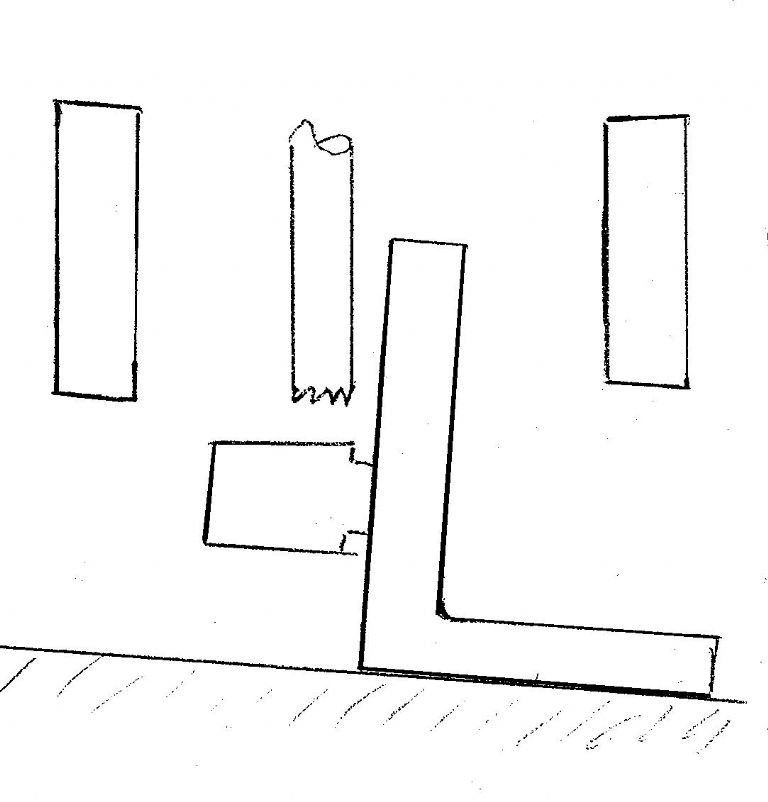

                          #575548
                          GordonH
                            @gordonh
                            The HH method is to fit the two buttons to the angle plate, each offset slightly by a washer. The top of the buttons are then milled to provide a base location for the bottom of the part to milled. This location is parallel the plane of the milling cutter. The part is then clamped to the angle plate, located against the buttons, milled on the top face, turned top to bottom and the new top face is milled. This produces two parallel faces.
                            #575549
                            Vic
                              @vic
                              I ended up with quite a number of pieces of ground flat stock which I simply cut to length. Using two pieces from the same bar has worked for me. I just left them soft.
                              #575558
                              Nicholas Farr
                                @nicholasfarr14254
                                Hi, excuse my crude sketch and I have exaggerated the angle a bit, but the two buttons on the angle plate will work out fine, however, it also needs the side of the angle plate to be in the same plain as the cutter, otherwise you could end up with a pair of "parallels" with a shape as shown on the left and right. A way to overcome this is to mount a plate on the angle plate with the buttons and machine the face of the plate true to the cutter plain. You can of course have the same situation with your vice.
                                Regards Nick.
                                #575560
                                Tony Pratt 1
                                  @tonypratt1
                                  Nick, when I posted my reply to Rob Cox I was aware of both conditions but the LH one is the best of the 2 but as you say you could machine the side of a sub plate and then mount against that.
                                  Tony
