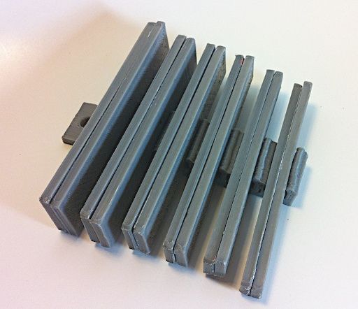

                      Going a bit 'off piste'  as it were, I wonder if 3D printed parallels would be any good. Of course these would not be precision or long lasting but might suffice for the odd job and 3D printing can be surprisingly accurate with a good set-up.

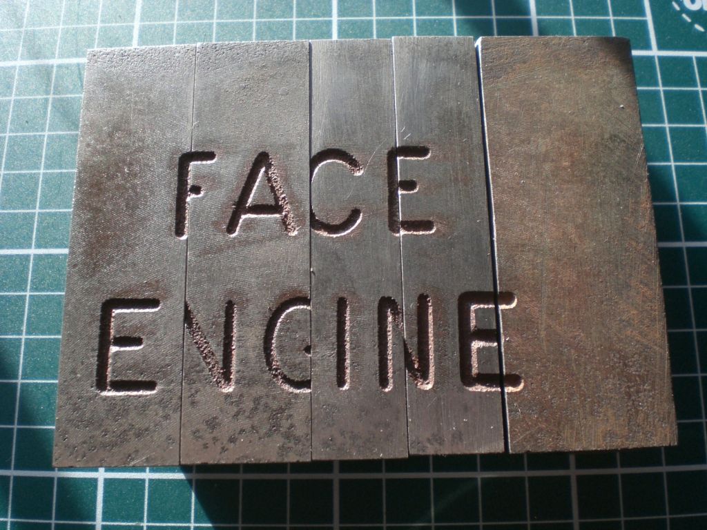

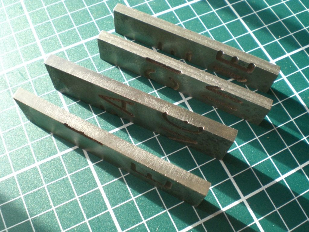

                                I have made two pairs, one 16mm high and one 22mm high & 4mm thick, which are 80mm long, these were made from a scrap cast iron baffle from a lorry engine (don't know what it did, but had a nice flat section) which I just milled to the highs mentioned within a small amount, but each pair was milled together, OK, I don't profess them to be precision, but they are the next best thing and they do well for many jobs, but like Jason has said, decent flat bar will do many jobs that don't require precision work.
                                Regards Nick.

                                            Well someone on Thingiverse got there before me *** LINK ***

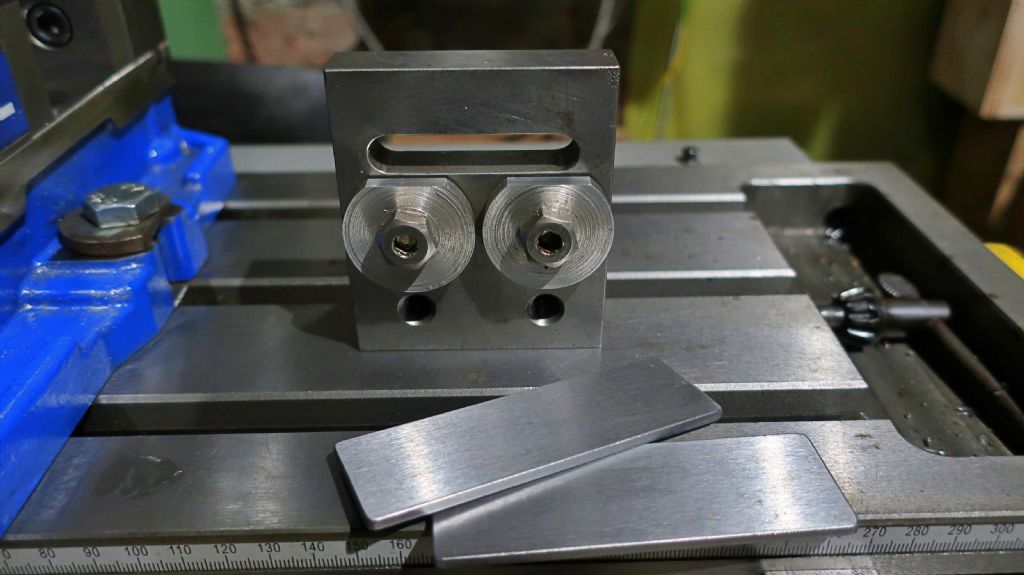

                                                It's not hard to make parallels with parallel long edges that 'will do' for most work, using a method I think I absorbed from ?Harold Hall;
                                                Cut some strips of gauge plate / ground flat stock close to finished size and 'true' one long edge of each.

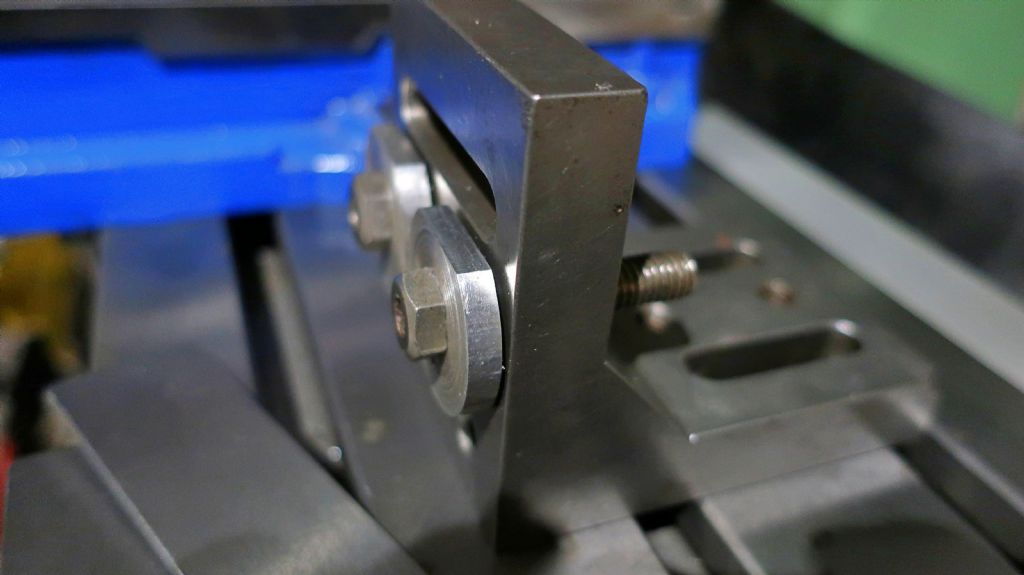

                                                A couple of discs of scrap steel are bolted to a small angle plate with washers behind to hold them off the face, and the top of the discs skimmed, bringing them parallel to the table.
                                                Without disturbing the set-up, the 'true' edges of your proto-parallels are placed across the freshly-cut tops of the discs, firmly seated and clamped, and the upper edge trued – with a little care, the end result will be as close to parallel as your machine is able to achieve..
                                                It's possible to find quite large lumps of GFS surprisingly cheaply, and with a bit of foresight and planning , it's a quick 'Saturday Mornng' job to knock out a few pairs of different heights..
                                                It goes without saying that there's no point hardening them, they will warp – I view them as consumable, but a generous chamfer avoids 'high-spots' if I drop or hit them and they seem hard wearing enough as is..

                                                      DiogenesII, (you're a cynic?), could you say how you recommend clamping pieces of ground stock to the angle plate? I'm assuming they're like yours, i.e. without holes.
