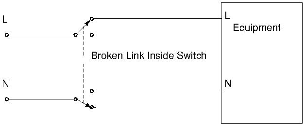

          Hmm… I've just been reading through what I've written and realised that most household appliances (or light bulbs, at least) only use a single pole switch on the live supply, leaving neutral continuously connected to the appliance. So my proposed arrangement will be just the same.
          Could someone please tell me when DPST switches are used on appliances to switch both live and neutral?

            DP switching on equipment totally disconnects live and neutral (considered live) conductors for greater safety. Many 13A sockets are available with DP switching for the same reason. Lessens the chance of neutral to earth faults on plugged in equipment tripping an RCCB.

              If you switch both the neutral switch could fail and leave the appliance live but switched off, a very risky situation.

                            A DP switch is two single pole switches operated in parallel by some form of linkage. The DP switch fails dangerously if the linkage breaks and only one pole disconnects. Operating the switch still turns the appliance on and off but it does so by disconnecting the neutral return. Although it appears to be 'safe' the appliance is still live and dangerous to work on.
                            On the other hand a single pole switch doesn't protect against Line/Neutral reversal faults. In that case a DP switch is safer. Otherwise I'm not completely convinced there's much advantage in disconnecting neutral if the equipment is still earthed. But I'm not an electrical engineer!
                            I don't know the original logic behind recommending SP rather than DP. Possibly because it's:
                            • Reasonable to expect that most of the time electricians won't reverse L and N on the supply side.
                            • Easy to test if L and N are reversed.
                            • Hard to test whether or not a Double Pole switch has failed, especially if the switch is fitted in an appliance. And there are millions of appliances!
                            • Easy to detect that a single pole switch has failed. It either works or it doesn't.
                            • Of itself an SP switch doesn't fail dangerously – a DP switch might.
                            Current thinking may have changed because of design improvements. I know some forum members like to think that anything made in the 'good old days' was high quality. It's not true; the mains switches used in old wireless and TV sets could be pretty nasty.
