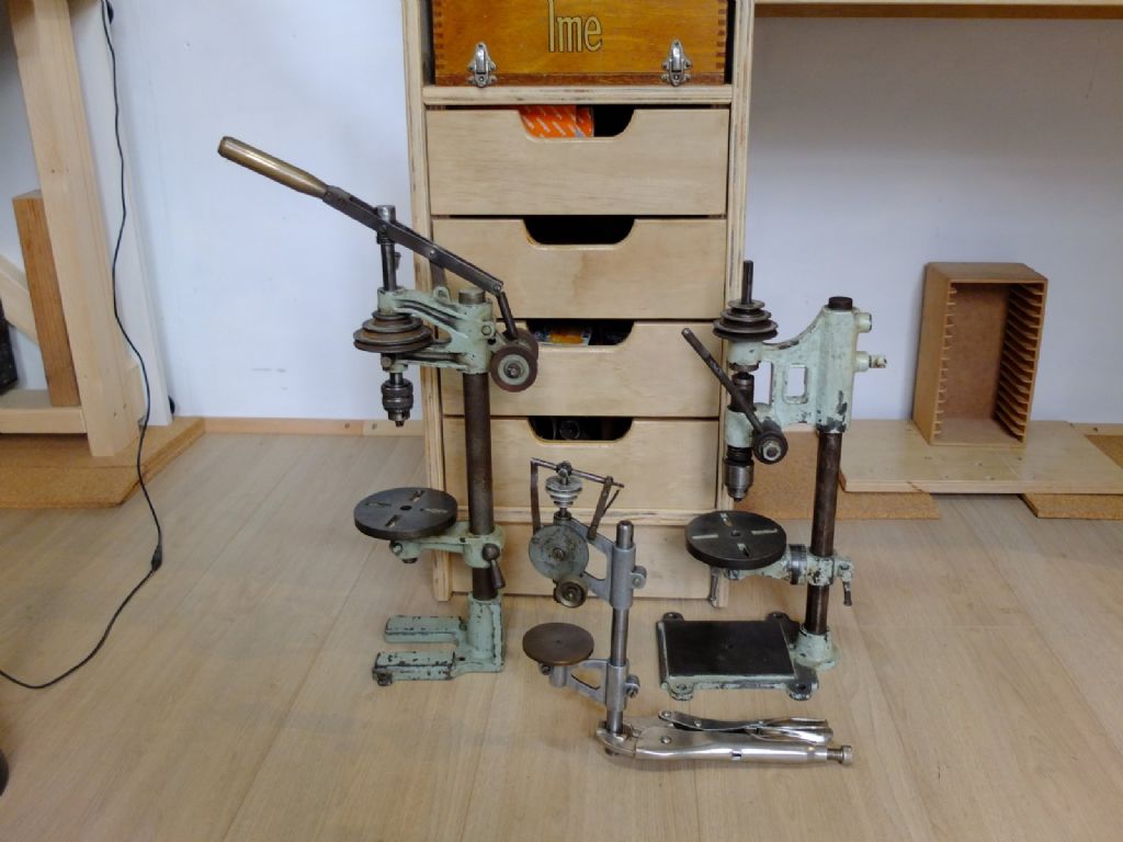

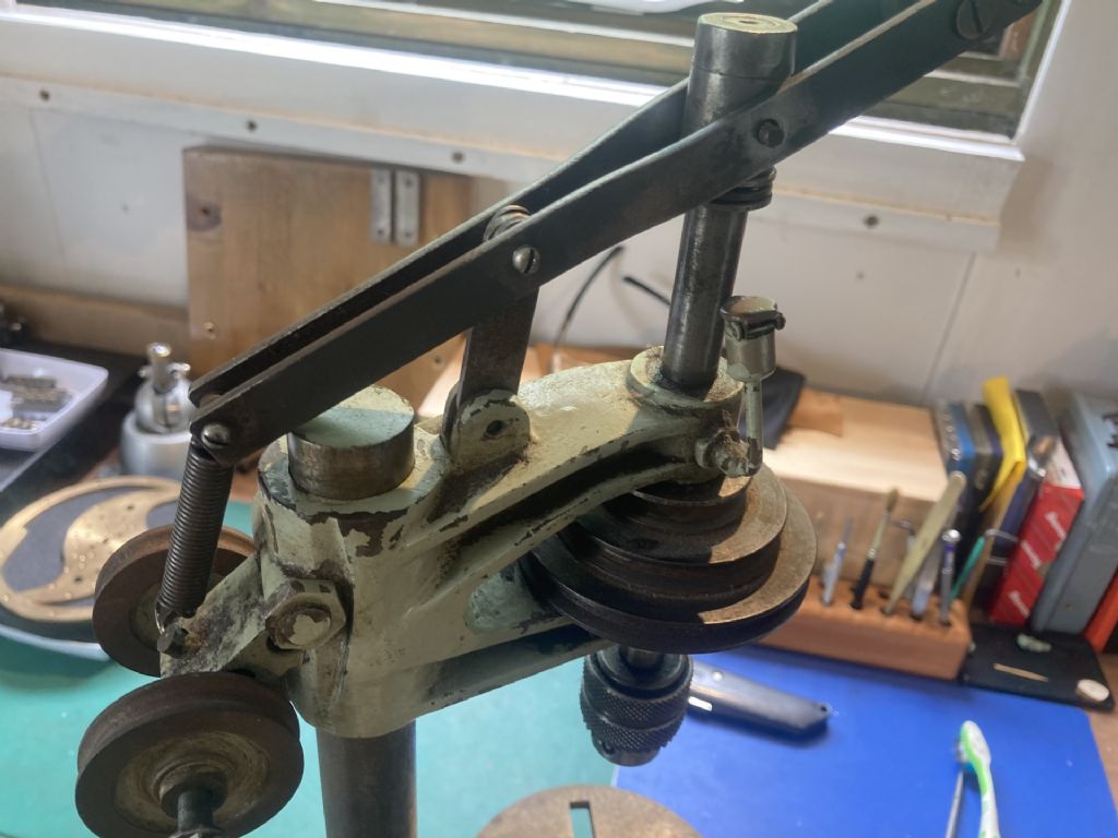

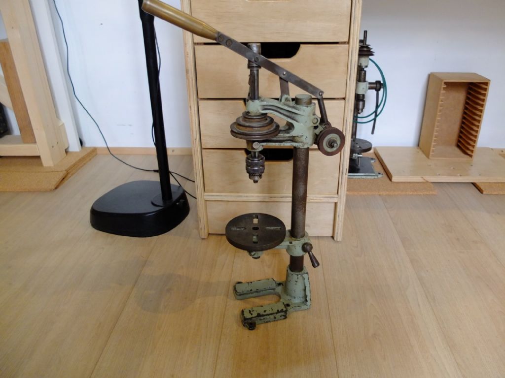

      Some years back I acquired a few sensitive drill presses.
      They are all in good working order but I have only really used the one on the the right, a Champion No1, which has given me around 8 years of service.

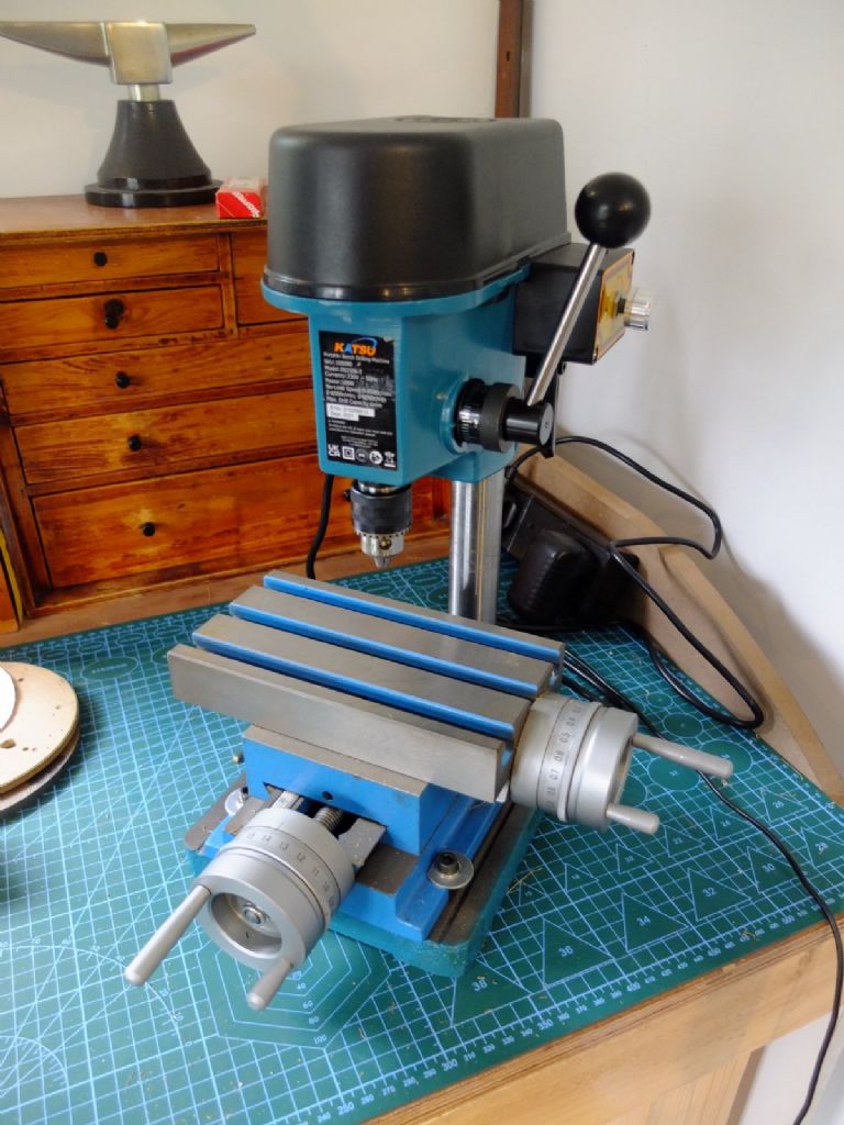

      Nowadays, I largely use this-

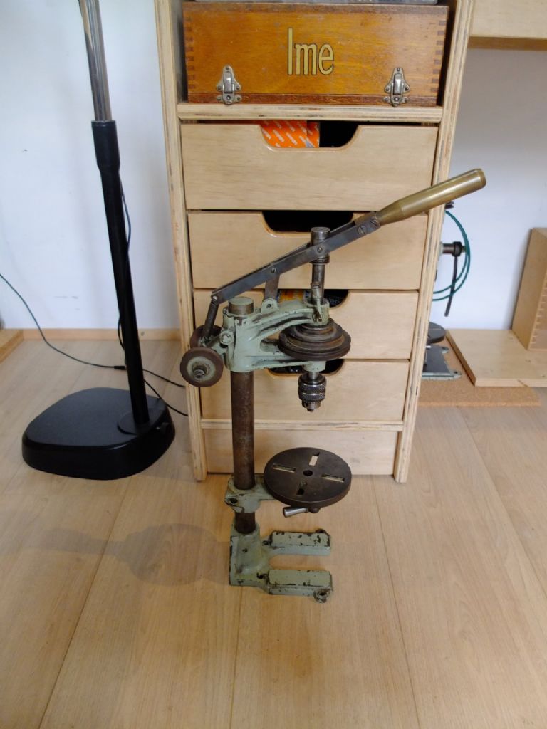

      I would like to renovate the larger of the machines (more questions about that later) and would be grateful if somebody could identify it. I would like to know the original colour.
      It's a solidly built piece of kit, even over-engineered for its 1/4" capacity.
      It has a heavy brass handle and an oiling pot on the top bearing. Everything runs nice and smoothly.
      Anyone any ideas?

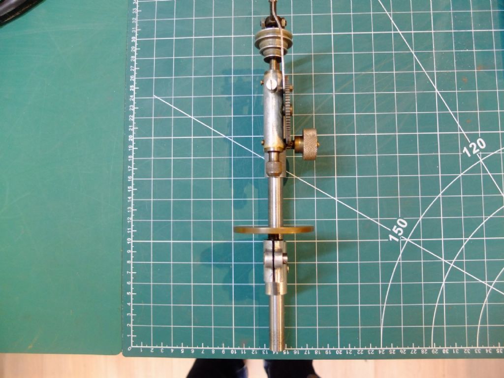

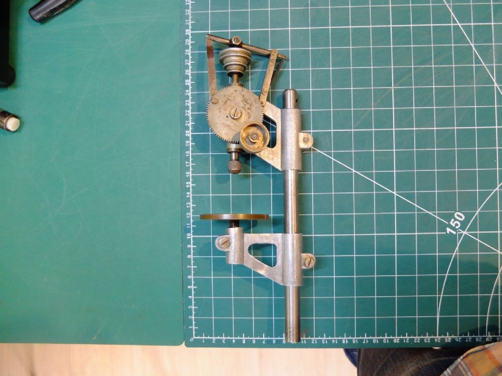

          This is the smallest drill. The base is missing.
          It is operated by turning a knurled brass knob which is geared to the larger wheel and lever mechanism. There is a return spring. Very sensitive and smooth action but a tad counter-intuitive as the gears reverse the direction.
          The casting are some sort of light alloy and the column is 9/16" so its Imperial. The table is brass with a threaded spigot and a tapped casting for a very fine height adjustment. There is about an inch of adjustment this way. The drill came with a single 1/16" collet
          I'm hoping to rehabilitate this and put it into service for horological uses. With a spade drill bit, it should be ideal for spot drilling small parts after marking out.
          I would be very interested if anyone knows the identity of this machine. Maybe it was a kit of castings and parts?
          Steve

            I can't identify their makes but the colours they are may be original, perhaps faded. Find a corner unlikely to have been damaged by wear or oil, and gently scrape a small patch to see if there is any sign of a different colour between the primer and present top-coat.
            There might be a flatting layer on the casting itself, not necessarily the same colour as the primer..

              Thanks Nigel, I will try a bit of scraping.
              It's hard to see from the photos but it looks like it was painted in the dark. Nuts and the oiling pot are covered in thick green gloop.
              I'm not too bothered about authenticity when it comes to the colour but I would like to see an original one.
              It might suit a Myford green!

                I am sure that I have seen that very distinctive base casting before … but I’m blowed if I can remember where.

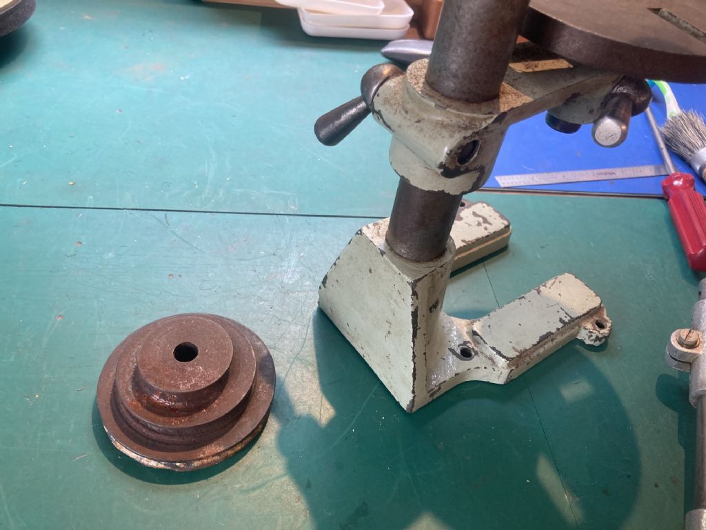

                  That base casting is distinctive. Quite a small footprint and the drill is top heavy. Very unstable unless it is screwed down.

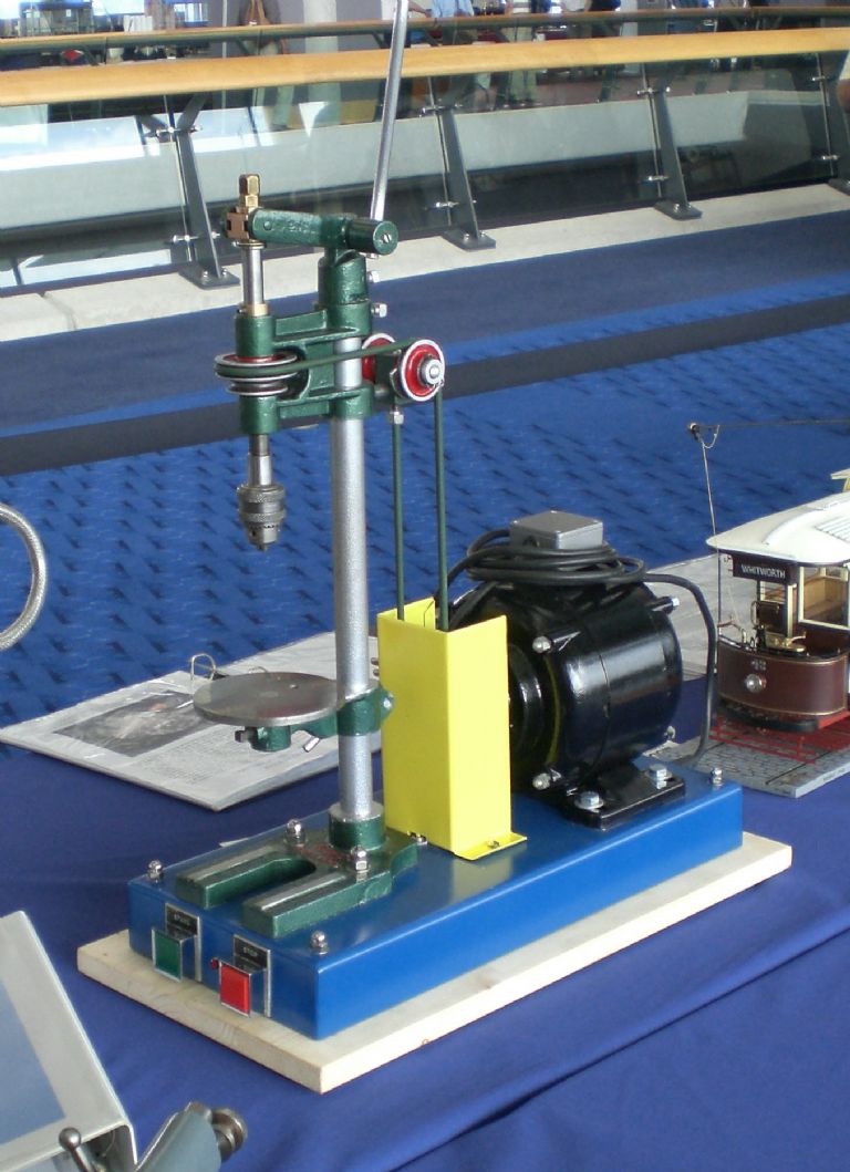

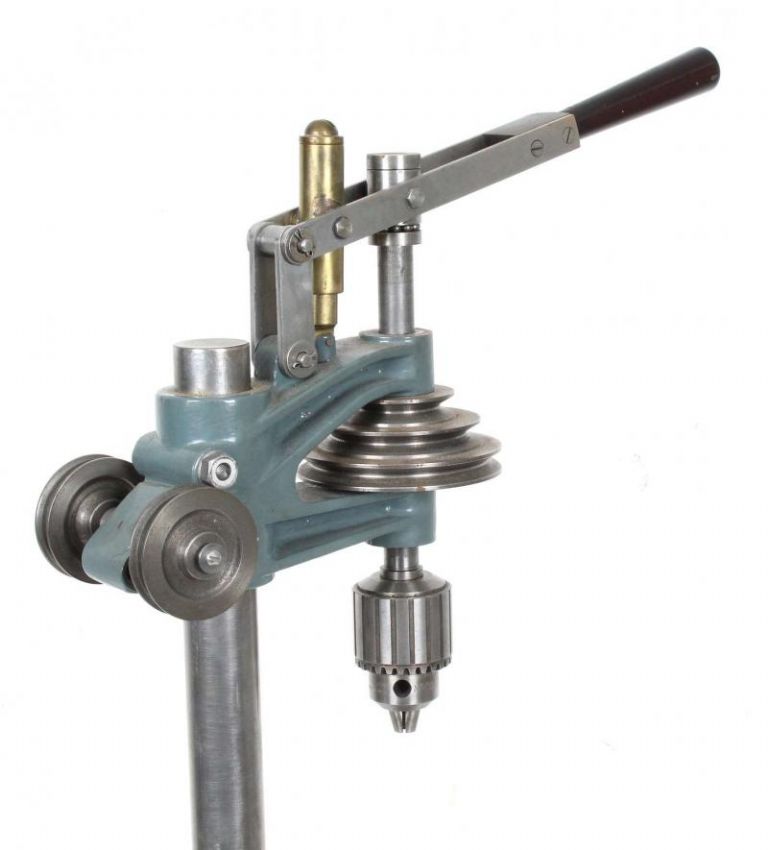

                      Station road steam Sold this drill last year, it looks to be much like your’s, the name remains a mystery but it appears to have some additional features.

                            Thank you Mike, that's the one!
                            I've been looking for pictures of this for years.
                            I wondered about the flat at the rear of the base, it must be to accommodate the drive weird pulley array on the back. Looks like some sort of flat belt drive.
                            They are no holes drilled in the my base to fit the attachment. Maybe it was an optional extra with a kit of castings? Mine came with a spare pulley as well.
                            #650621
                            Steve Crow
                              @stevecrow46066

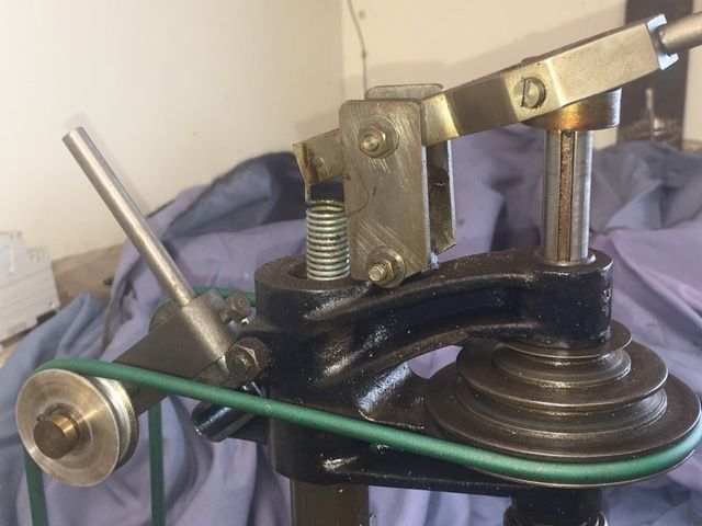

                              The other major difference is the return spring. Mine uses an extension spring and a lever.
                              This machine seems to have a compression spring enclosed in a brass tube and a lever in different positions and a shorter handle at the rear so it doesn't foul the column on adjustment. All in all, a better, more compact design than mine.
                              I do like the colour though and I'll use the photos as a guide for restoration.
                              Do you happen to remember what it sold for?
                              Cheers
                              Steve

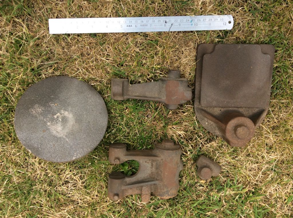

                                        I have a set of Castings fir something similar and my son has the finished article and very nice it is too. This version is counterbalanced not spring return and motor is mounted similar to GHT pillar tool albeit a bit larger . I also have the original Indian ink drawings on tracing paper dated 1975. They were drawn by a friend of mine now sadly gone.d87d40d4-5cf6-45f6-8e3c-9b3248c4861f.jpeg

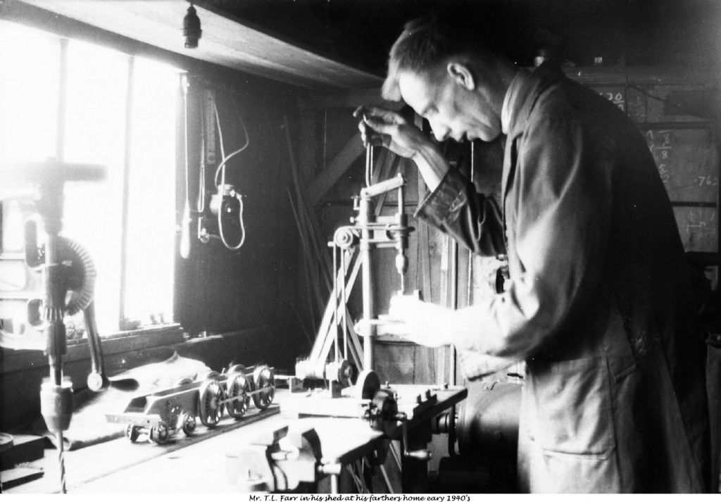

                                          Hi, this is my father's one that he had in his shed back in the 1940's.

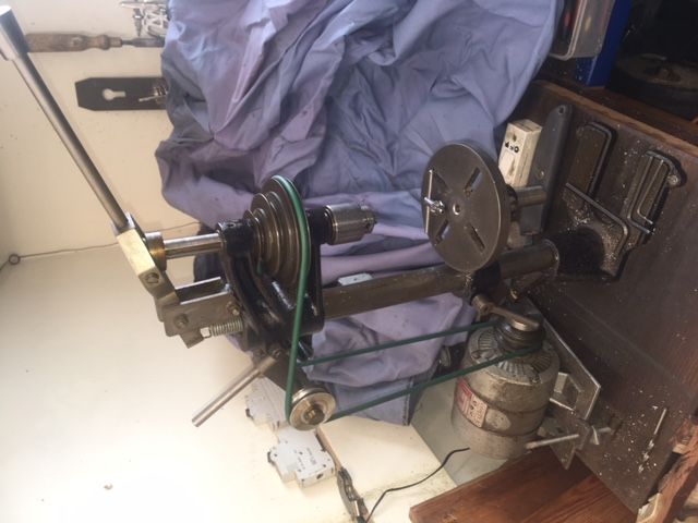

                                              img_1233.jpgimg_1231.jpgI have a similar drill, I bought it from a club auction many years ago, it was incomplete – only a base, column, table and spindle with a chuck.
                                              I was about to make a Geo Thomas one, so instead incorporated some of his ideas into mine.
                                              It was as far as I can remember a similar colour to what it is now. I guessed it was a home made from casting design but that is only my guess.
                                              #651339
                                              Richard B
                                                @richardb44403
                                                Not sure why the pics are not below text ?
                                                Also the colour has not shown up well – its a very dark Blue.
                                                Richard B.

                                                  Thanks Richard, that looks very nice. I suspect it was a kit of castings as well.

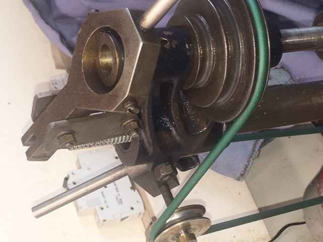

                                                  In the meantime, I'm part of the way into rehabilitating this little fellow-
                                                  I'm making a new spindle with an integral ER8 chuck running in Oilite bearings and replacing quite a few other components as well. There will be an adjustable pulley countershaft and a motor. I am aiming for something compact I can easily move around the bench.
                                                  Steve

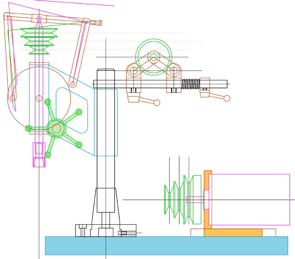

                                                    This is the idea.
                                                    The column is shortened and the table omitted for the sake of the drawings.

                                                    geoff walker 1
                                                      @geoffwalker1
                                                      Hi Steve,
                                                      The first 1/4" drill you asked about was covered in a series of articles in M.E.by the writer "NED".
                                                      It commenced in issue 2092 on June the 12th 1941.
                                                      It continues in 2094 and 2096.
                                                      I have those three magazines, if you would like them send me a p.m. and I'll post them to you.
                                                      The build is not complete and continues in 2098 and probably at least one more issue.
