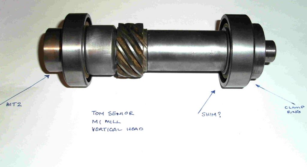

        I have a Tom Senior M1 milling machine with a vertical head of the old type.  I have had to change the quill bearings and in doing so found a lot of strange things with this head.  It seems that there is no positive shoulder for the end bearings (thrust bearings) to rest against, these just resting against the end caps (which were shimmed).  I have a feeling that this head has been “butchered” in order to use “out of size” bearings and that the eventual shoulders have been removed.  I would like to get hold of the construction drawing(s) for this head and have tried several places but not succeeded.  I must here point out that I have what has been available of documentation and Tony Griffths at WW.Lathes.co.uk was also contacted but to no avail.  Is there anyone who has changed bearings on one of these heads, and could they eventually be persuaded to make a diagram showing how they were put together?  OR  is there anyone who is willing to dismantle a head to find out? and make a diagram?  I can produce a machine drawing from a diagram which I can afterwards distribute  to those who would like this(and to Tony Griffiths of course).
        PS I have solved the problem for the moment using a piece of tubing between the bearings in order to get a preload, but it is not a good engineering solution.

                Got an unexpected morning off – and inevitably I spent the rest of the night wondering about the M1 head assembly and how it was supposed to work… it’s amazing how much somebody else having a similar problem focusses the mind!
                So, I’ve taken a picture of the shaft as it is at present – assembled, but out of the casting:
                The way I think that it’s supposed to work is that shims shouldn’t be applied to the outside of the bearings at all (which is what you appear to be indicating has happened on yours), but at the point I’ve indicated on the picture. The idea appears to be that you do a trial fit with the bottom end cap in place, and when you screw down the upper cap, you check for end play. Remove the upper cap, release and unscrew the clamp ring, which releases the bearing. Place appropriate shim on the end of the sleeve so that it’s pressing on the bearing inner, replace the bearing, clamp it up again and replace the cap. Then recheck the end float, and probably do the whole thing all over again – possibly several times. Incidentally, the original bearings are Hoffmann thrust bearings, LS10ACD/MS9ACD.
                So, just to be clear, it appears that you adjust the preload by forcing the inner part of the upper bearing more firmly against the upper cap, which has the effect of forcing both bearings apart slightly against both caps. I’m still thinking about where the forces end up with this design, and whether I like it or not. It’s clear that any axial load is taken by the upper bearing  – I can’t see it being any other way. There doesn’t appear to be enough room to double up on the lower bearing as I’d hoped – it would foul the larger drive gear.
                As for a real fix for this, well…
                The thing is that really, the larger sleeve needs to be adjustable in length – with the end caps in place. Whilst you could contrive a sleeve assembly that did this, as there’s plenty of room for it, you’d have to face the prospect of the only way to adjust it being to mill an access point in the side of the casting.
                Of course I’m open to any suggestions about this – none of the above has been confirmed by anybody else; it’s just the results of a sleepless night.

                  #46284
                  Antony Cook
                    @antonycook35332
                    Hello Steve, Found your mail this morning but haven’t had a chance to reply before now.  The bearings on my vertical head were extremely worn (squared balls I think) and I replaced these with the same as you have quoted, so it is obvious that the bore hasn’t been altered at all (I did think at one time time that an eventual shoulder had been removed in order to use another size of bearing).   The state of construction was just as you have described in fact, with a central spacer tube but with the addtion of shims on the top bearing (ie between the outer ring and the end cap).  I thought that this was maybe a “fix” that somebody had made in order to change bearings at some time and thought (as yourself) that this wasn’t  a very good engineering solution.  My attempt to sort this out temporarily, because I needed to mill something quite urgently, was to place a large bore tube between the bearings (with these turned around) such that it pushed against the outside of these.  I cut out a large hole in the middle in order for the main axle to come through.  I was then able to shim up the top end of the axle to give a preload.  This has worked very well, even though the tubing is not retained horizontally in an y way.  This was of course done as a purely temporary measure as I was sure that somewhere someone would have constructional drawings of the head as manufactured and that I could possible reinstate the proper construction.   However drawings don’t exist and I am now lucky that you have found the same as myself, so I know that I can:  A).  replace the original solution or B).  Find a better one than I nao am using.
                    I will probably have time during the Christmas period to look at this again, but let’s keep in touch on this as I have a feeling that anyone changing bearings on such a vertical head is going to find problems, as I think that the original solution was dependant on bearing limits in width.  I would prefer a permanent (and traditional?) solution where the bottom bearing is pressing on a shoulder with the top bearing being shimmed to give preload.  Whether this is possible I don’t know, as it would probably entail using another bearing size.
                    Happy Christmas – Antony Cook, Langhus, Norway.

                      Posted by Circlip on 16/12/2009 13:58:34:
                      Don’t ya think that a clamping “Washer” could be fitted between the outer race and the cap??
                      It certainly could – and it would achieve the same result without having to disassemble the whole thing. My only problem with it is that this is a  2 1/4″ OD bearing, with a 7/8″ ID for the shaft. And on a decent unworn bearing, you’d need washers only a couple of thou thick – if that. Despite the potentially easier task of changing them, I think that these washers are going to be a lot easier to fabricate in a smaller size – unless of course anybody can provide information about where to get the items ready-made…
                      But I still don’t like it, and I’m pretty sure that Antony doesn’t either! So I suspect that both of us are likely to spend some time trying to figure out whether there’s a more satisfactory way of achieving a correct adjustment without disassembly.
                      Antony, I’ve read everything you said, and I’m having another careful look at the Sandhu “Spindles” book (WP27). One of my concerns with the existing arrangement is where any axial loading is transmitted – into the top of the casting. Somehow this just seems wrong to me in terms of the applied forces, although I’d be quite happy to be talked out of that by a convincing argument…
                      Edited By Steve Garnett on 16/12/2009 16:04:34

                            Okay, I think I’ve worked out the answer to doing it properly, as Antony and I would like. I’ll do a proper drawing of it as soon as I’m able, but a brief description I can provide now:
                            This is based on what Antony has already done – in other words turning the bearings around so that the thrust force on them is reversed, and putting a sleeve between them. The idea is to get at least the top end cap out of the force equation altogether, and achieve an adjustable preload, preferably using what’s already there – and it can be done. The first thing is that a close-fitting sleeve has to be fixed firmly to the casting at the appropriate place – not too difficult to achieve at all – it could be loctited and pinned, because it never has to come out again once it’s in position. This would enable the axial force to be transmitted into the casting around the centre of the MT sleeve – which is where it should be; as close to the source of the force as possible. All the bottom cap has to do is hold the bearing in approximately the right place for assembly purposes; in the final analysis, it doesn’t even need to do that very well either – it’s pulled against the sleeve from above.
                            At the other end, it gets more interesting. At present, the clamp ring just forces all of the components on the shaft together, and doesn’t provide bearing preload at all. But, if the long shaft sleeve was locked in place independantly (its only function now is to stop the keyed helical gear from moving up the shaft), and it was made very slightly shorter, then the screwed clamp ring would now be free to move the inner race of the bearing in the thrust direction – thus providing the preload adjustment by pulling both inners towards each other. And that effectively takes the top cover out of the equation completely, meaning that the whole assembly can be adjusted just by removing three hex bolts and slackening one locking screw. As far as I can tell, you’d only have to take 25-30 thou off the sleeve end for this to happen, and you wouldn’t run out of thread for the adjuster either – not for quite a distance.
                            At the moment it’s just a thought exercise, but it seems to meet all of the design criteria. Antony, since you have one in front of you, do you have any comments?
