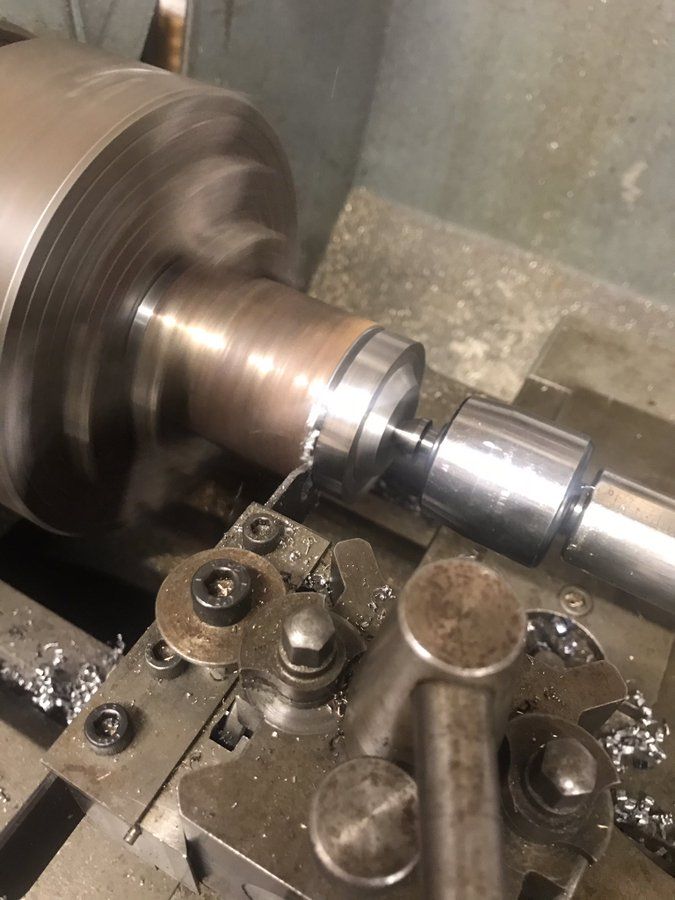

                                      I use centre support all the time on the CVA.
                                      This is mystery steel, about 2" diameter:
                                      Just remember to loosen it of as you get towards the actual cut off.
