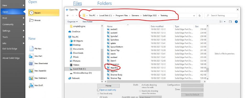

                Wot grindstone said, but what they mean by 'Look In' is usually called the 'Navigation Pane', ringed in red below. It allows the user to find, or navigate to, or 'look in' a particular folder:
                On my copy of SE the training material is preloaded, and the Navigation Pane is used to get it:
