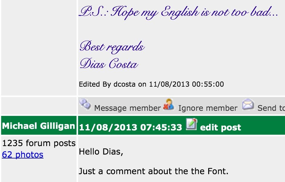

              Posted by Michael Gilligan on 11/08/2013 08:22:55:
              For info …
              Sorry, that post should have included a photo !
              Surprisingly; appeared O.K. when I saved a " .png" image to my album
              … Will post again, later, when I have converted it to ".jpg"
              Edit:
              Now I'm bewildered … just refreshed the page and the image re-appeared !
              Edited By Michael Gilligan on 11/08/2013 10:13:20
              #126692
                Posted by OuBallie on 11/08/2013 08:44:27:
                MixhaelG,
                How did you do that post within a post?
                Thought my iOS had done a W on me.
                Geoff – Grasp of Portugese = nil
                Geoff,
                1. Opened the relevant post on my v1 iPad
                2. Zoomed-in to the area of interest
                3. Screen Grab [briefly press the Sleep Button and the Home Button, together]
                4. Opened in PS_Express App, and cropped the image
                5. eMailed it to myself [cannot put photos into the forum from v1 iPad]
                6. Opened the eMail on my iPod Touch [which runs iOS 6] and saved the image.
                7. Logged onto forum and inserted image into my "Odds" album
                8. Inserted image as a photo, into my posting
                9. Edited the posting, adding two rows of dots; for clarity.
                Not exactly a slick process but: If it informs the discussion, then it was worth the effort
