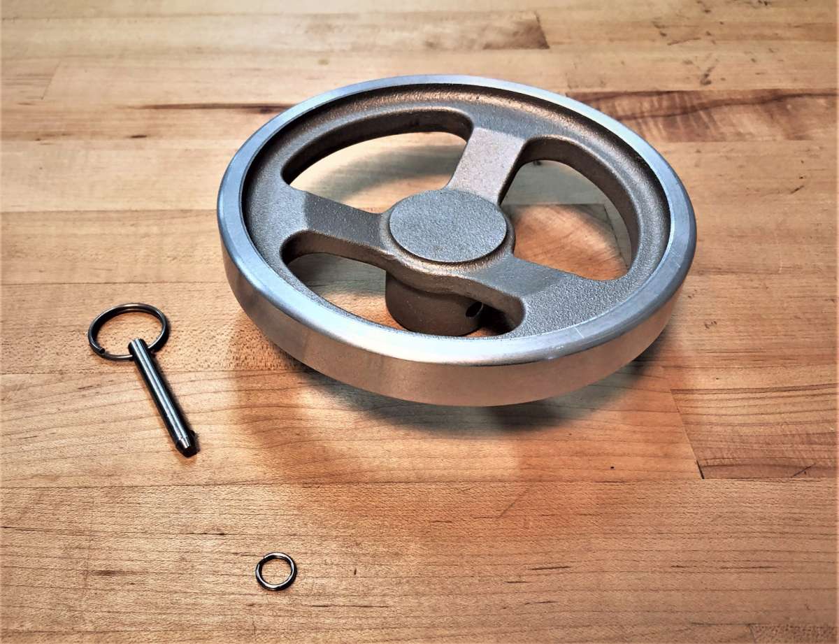

                                It’s Hovarter, and there are no European suppliers as far as I know.  Benchcrafted, also American, do similar hardware, available in the UK and Germany, but to give you an idea of cost, if it were available, look here

                                  The Benchcrafted ones are internally threaded for an Acme screw by the looks of it, hence the price.
                                  https://www.core77.com/posts/66117/Benchcrafteds-Moxon-Vise-A-17th-Century-Design-with-21st-Century-Design-Upgrades
                                  By the looks of the design, they use cast iron and a thick rim because of the weight to allow for fast smooth tightening.
                                  These seem to be the Hovarter large ones, which presumably have a plain blind bore, or at least a plain bore with a cap.
                                  https://hovartercustomvise.com/product/large-hand-wheel-with-quick-release-pin-for-use-with-vx-20-leg-and-vx20f-face-vises

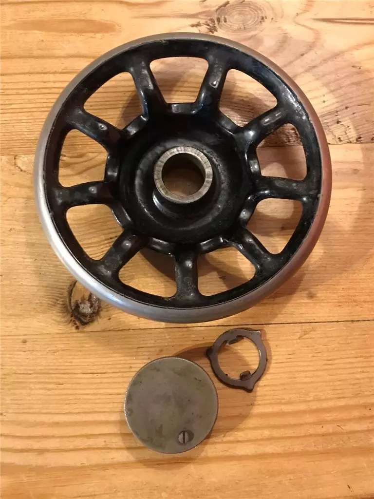

                                  This brings me back to my original suggestion of a sewing machine handwheel, but with an inserted step up bush to provide the socket to go on the end of the screw thread, and also provide more finger clearance.
                                  I measured my own Singer last night, the through hole is about 0.812″ and the outer diameter of the boss is 1.1″ The wheel is 4 ½” diameter.
                                  Other machines may vary.
                                  OK that’s not enough material to bore out, but plenty to allow a bush to be fitted with Loctite, which would also provide for the stand-off for a drive pin; it might even be pleasing to the eye.
                                  e.g.
                                  image_2025-02-19_140116035
                                  https://www.ebay.co.uk/itm/176812330894
                                  Failing that, since weight is a requirement, rather than a disadvantage, maybe attach a drive flange/boss to a cast iron gym weight, some of which fit a standard 1″ bar.
                                  Alternatively, bore them larger, and bond in some 1″ bore tubing.
