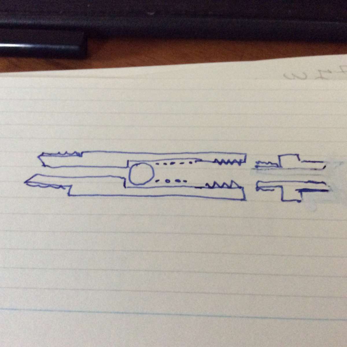

      I am interested in making up an in-line water feed check valve for a model locomotive and would be interested to hear if anyone can suggest some likely generic designs in 3.5” or 5” gauge which may have been published in the past.  Martin Evans in his book “The Model Steam Locomotive” gives details for one such valve for use in the vertical position but I am looking for a design suitable for use  in the horizontal position.  Any help and assistance would be much appreciated.
      #733479
      bernard towers
        @bernardtowers37738
        Could be a bit difficult if you do not use a light spring (stainless or bronze)IMG_3604, how about the valve body vertical with the threaded unions at right angles one at the top and one at the bottom?. sorry about the crap image but I’m sure you get the idea.Should be in on the left and out on the right

          The reason for the enquiry is that I would like to be able to make use of one of the wash out bushes located at the bottom of the boiler backhead which for space reasons lend itself to a horizontal fitting.
          #733483
            This will probably be considered a cheap/tasteless suggestion, but:
            Such valves are common in automobile windscreen-washer systems
            … you may do well to investigate these for design features and spring rates.
            Search for: windscreen washer check valve
