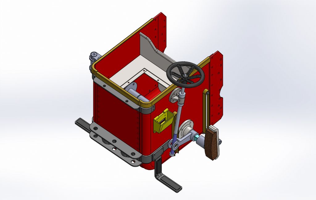

                        #392531
                        Paul Lousick
                          @paullousick59116
                          The tanks on most original engines have a removable cover on the side of the tender which allows access for inspection. The cover should be removed to allow the tank to be completely dried when storing the engine to prevent rust.
                          I am building a tender for my model engine at the moment and have also added a removable cover on the top panel (under the coal bunker) for just this reason, so I can coat the inside with sealant.
                          Paul.
