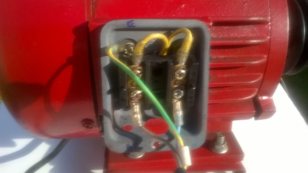

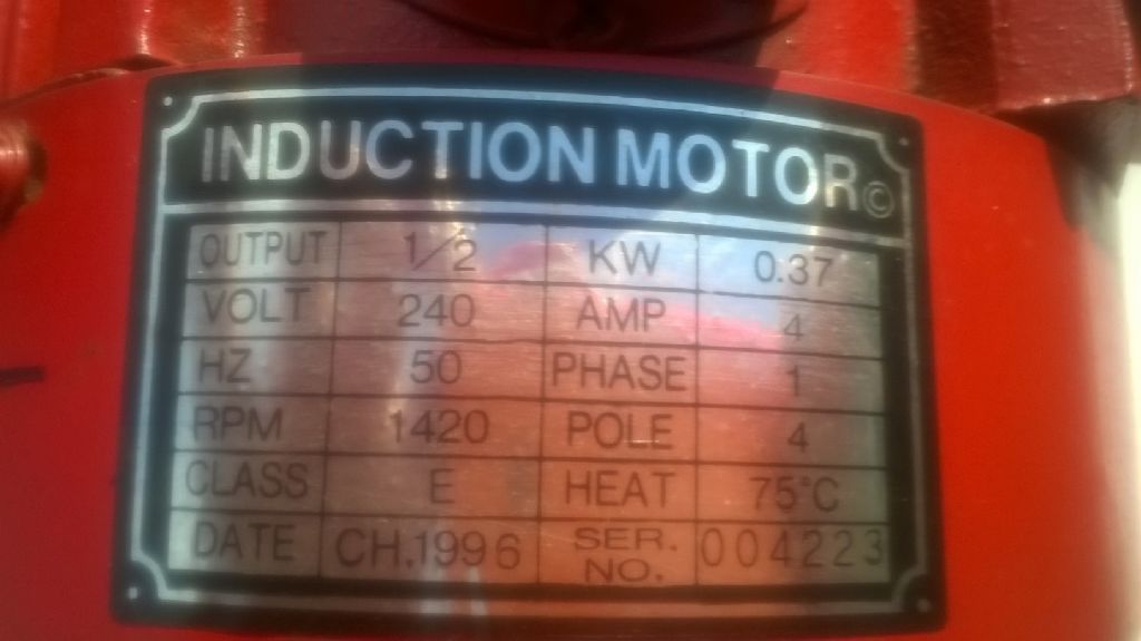

      I have a 0.5 hp induction motor (240 volt) that was fitted to a Sealey drill press. Is it possible to reverse the D.O.R by swapping the wires over. Would like to use this motor to power a small vertical milling machine and it would make life simpler if it ran the other way. Steve

        Stephen, it may be possible, can't say without more information. Photos of motor, data plate and motor connections would help.

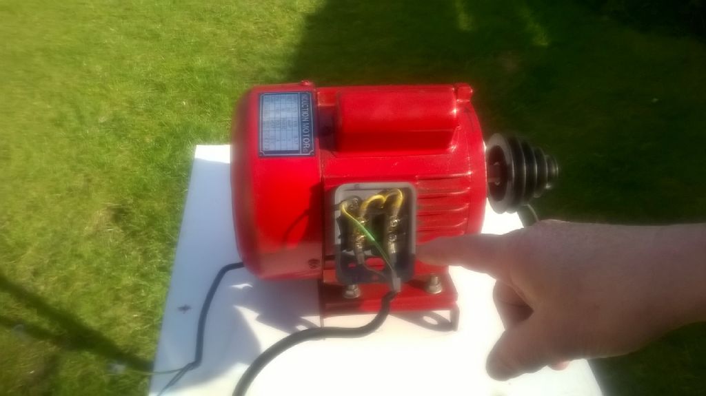

                      wp_20150322_09_24_21_pro.jpgwp_20150322_09_24_06_pro.jpgwp_20150322_09_23_45_pro.jpgwp_20150322_09_23_36_pro.jpgwp_20150322_09_23_07_pro.jpg
                      #185361
                      Stephen Fuller
                        @stephenfuller
                        Hope these pics help and thanks for the posting help
                        Steve

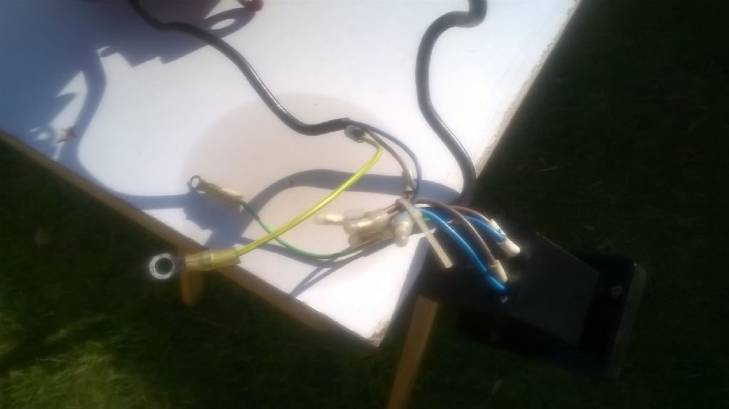

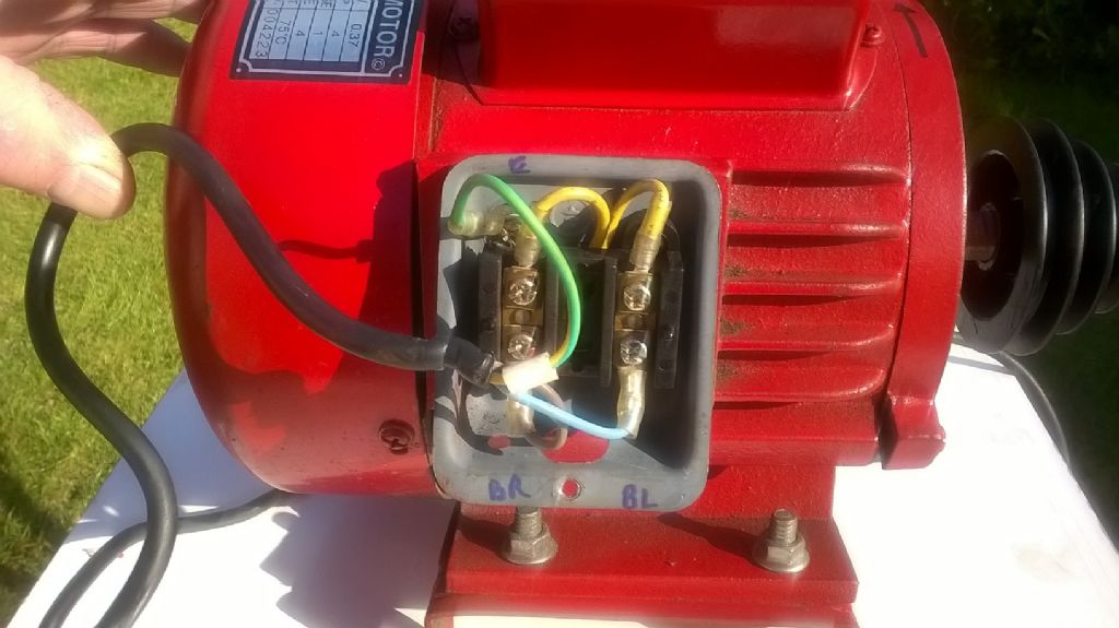

                          From your pictures there only appears to be two wires coming from inside the motor.This could mean two things. One The windings and capacitor are connected togeter inside the motor. Two There are some wires connected to the back of the connection block. It may be posible to undo the screws holding the terminal block to see if there are wires connected to the back of the connection block. If you cannot do this remove the yellow wires that come out of the motor (Mark them so you know which is which.) Measure the resistance between the yellow wires. Measure the resistance between the terminals on the connectot block. I expect one of the readings to be between 2 and 15 ohms. The other will read open circuit. (It may read less than an open circuit very briefly if it is a winding in series with a capacitor.) If you do not see the brief reading then connect these two terminals to the mains via a low wattage filiment bulb. 15 to 40 watts.) If tha lamp does not light at all then the conections between the windings and the capacitor must be inside the motor. If you have any test equipment that can read capacitance then use this instead of connecting it to the mains via a lamp. If the connections are internal then the motor will need to be dismantled and you may even have to get into the end connections of the windings. As you do not fully understand motors then you will need someone to help you. Report back with the results of these tests.
                          Les.
                          #185402
                          Stephen Fuller
                            @stephenfuller
                            Les I have now done what you said and the lamp did not light, so assume, as you say, the connections must be inside the motor. I shall seek a mechanical means of reversing DOR. Thank you all for your help
