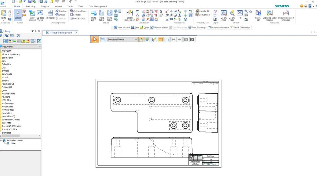

Here it is as a PDF, could have sent it straight to paper printer or made a jpg as well as the usual DXF and DWG files
Or a screen shot

In brief, with SE(CE), the process for producing printed conventional drawings is fairly easy but maybe not intuitive.
Have your model open on the screen. Right-click on the component in the LH list which shows all the sketches, etc, that have gone into the model. Select "create drawing…" and you will be presented with a blank sheet with title box which lets you position your component on it. You can add further views, including isometric, at this point. Use the dimension tool to add all the dimensions you wish (including baseline/incremental measurements if this suits your way of working).
Once you have the drawings/views wanted, click the very top LH button on the menu (with the SE logo on it). From the LH menu, select "paper print" and you can then choose to print directly to a printer, or save as PDF format for later use. I have just checked this with SE 2022; not sure if it is true for earlier versions.

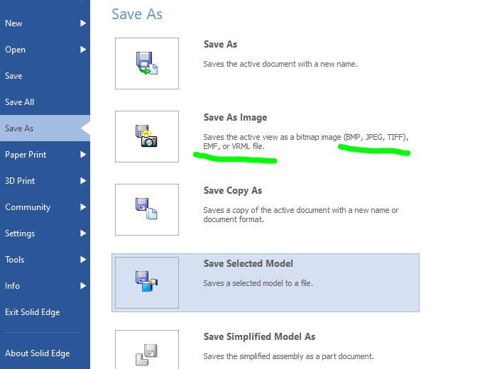

It's fairly clear in SE-CE "paper Print" should be clear enough.
As for saving in other common formats that you say you could not find try this, jpg is in there and can be loaded to your phone to view in the workshop or easily printed out.
…and in SE, if all else fails, type what you want to into the "find command" box at the bottom of the screen. Helps enormously find functions that aren't in the current menu tab.

Have found it now.
I'd been looking in the "Data management" set that includes "Save As" etc.; similarly to most software running in 'Windows', and not realised the significance of the button with the star trade-mark.
