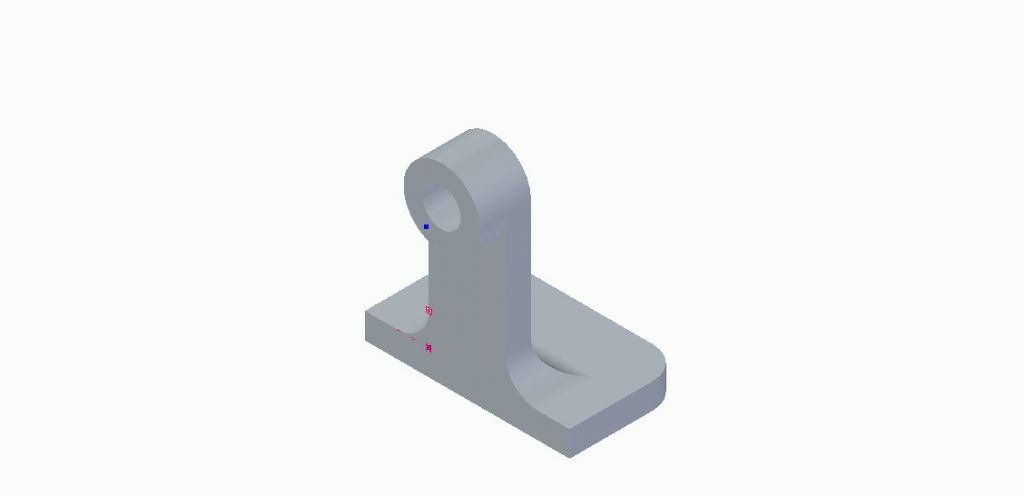

      All right, the first exercise in Siemens' tutorial set. Years from any real design-drawings of my own.
      It is a journal for a simple roller assembly – basically an L-bracket with a hole through a boss on the upright. I think a later exercise incorporates it and a twin, in the entire assembly.
      Not easy…..
      It starts by drawing a rectangle but it is very hard to select the correct plane (the XY) for this.
      Then I found –
      The various tools and their results do not always agree with what the instructions tell you to expect, e.g. by symbols not showing; no "Quickpick" tool).
      The diagram showing the three planes appears or not according to its own whims. Similarly with trying to select the plane from that three-arrow sign.
      The order of instructions is confusing in places. I found it best to read several ahead to see what we are aiming for.
      Eventually I reached the last stage: a fillet round three corners. The fillet tool itself is easy – really rather elegant – but the problem is picking hidden corners. Either I missed it or the instructions do not tell you to use the Style tool to show them. I found that by guess-work after turning the thing in all sorts of improbable angles to find the corners.
      Eventually, feeling teaching Schroedinger's luckless cat to dance (or not!) would be easier, I managed to save the result:

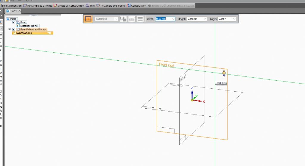

                        Setting the plane at the beginning, here the trick is to move the mouse until until the wanted plane illuminates in yellow, then press F3 to lock it. There is no default plane.
                        Hint: F3 is very important in Solid Edge – used a lot to make sure sketches and selections are locked to the correct plane or face.

                          Just tried that.
                          I opened a new template ("metric part" ), and the 3-way sign was there in the middle.
                          Pointing to it, made it all turn yellow, and in splendid isolation.
                          I pressed F3 and it was now that the three planes appeared.
                          The X-Y was highlighted, and I could centre a test rectangle on the origin, but because the plane-frames don't appear until pressing F3, there seemed nothing to indicate I had actually selected that plane by choice and not chance.

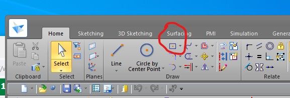

                              Ah ha. Sounds like a small detail has tripped you up.
                              Solid Edge doesn't begin by selecting a plane as the very first action. Instead, starting one of the drawing tools causes it to run the plane selection dialogue seen in my earlier picture.
                              Try opening a new metric part and selecting the Draw 'Rectangle by Center' button:
                              If a plane or face isn't already set Solid Edge asks for one when the drawing tool is first activated.
                              Edited By SillyOldDuffer on 20/09/2022 19:09:25

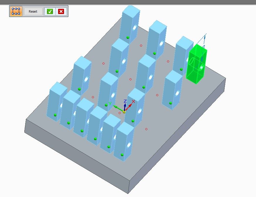

                                  Found an intriguing effect (I'd obviously done something wrong!)
                                  No longer really trusting either the tutorials or me, I tried repeating the gist of that journal drawing, but with my own drawing.
                                  The first thing I noticed was that the figure lacked any mid-point markers. Anyway, I planted a simple upright with just a hole though it, on the end of a slab; using dimensions to place it symmetrically; then looked around seeing what if anything might copy it to the opposite end.
                                  The only version of "copy" that appeared to work was Mirror, which I would have wanted eventually anyway.
                                  Unable to control the reflection-axis' location, I moved the reflection to the end of the plate by calculating the dimension-change (surely not the "correct" way?).
                                  That all worked, even if not quite the "proper" technique.
                                  Only..
                                  The original, extruded post had become blended into the base, but I found you need pick the "protrusion" from the little list on the left – I forget the list name off-hand.
                                  Now the oddity.
                                  The reverse-copied entity was neither blended into the base nor "solid". It was a wall, a sort of mummy-case shape with a tube in the semicircular end.
                                  The copy was of the surfaces, not the entire lump.

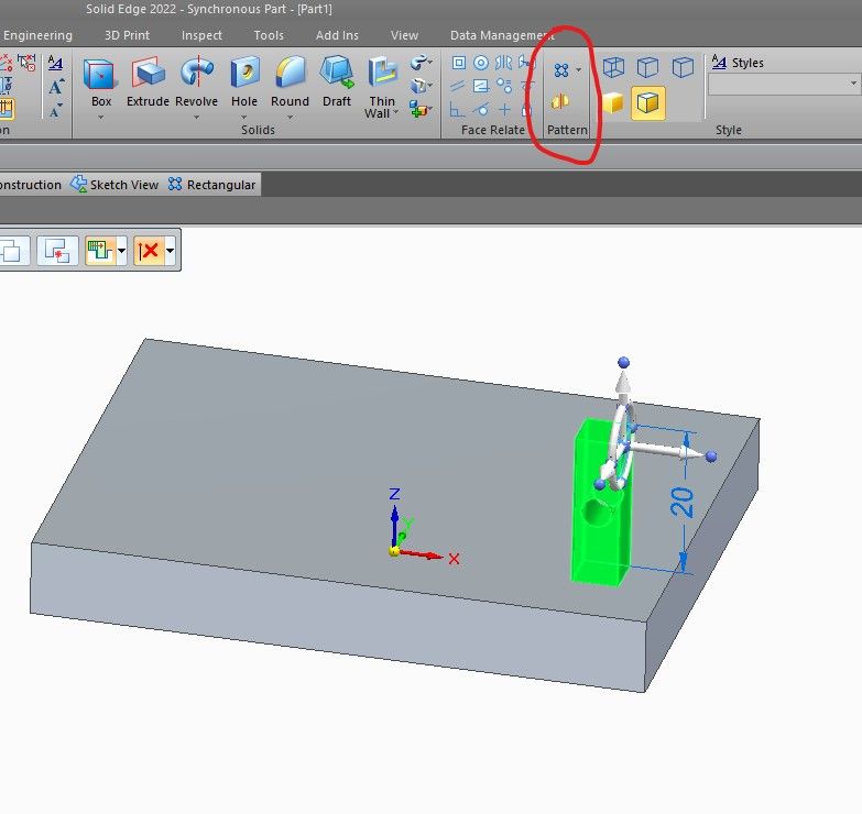

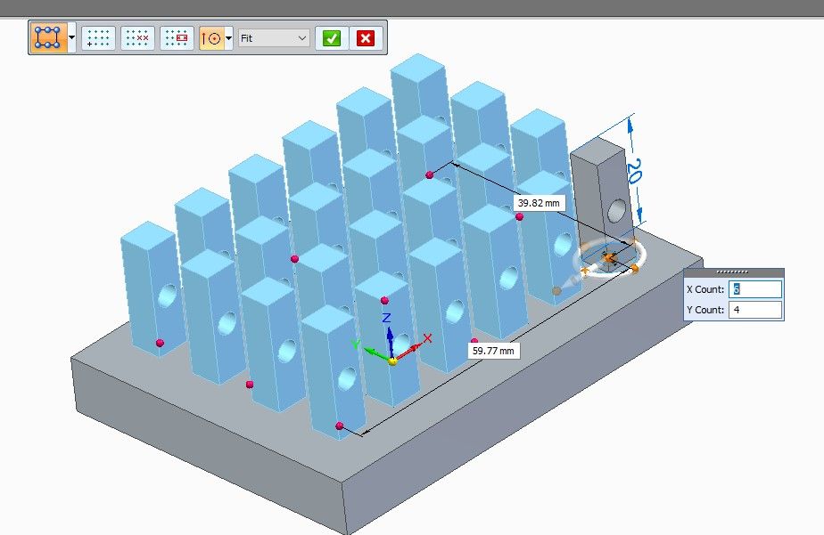

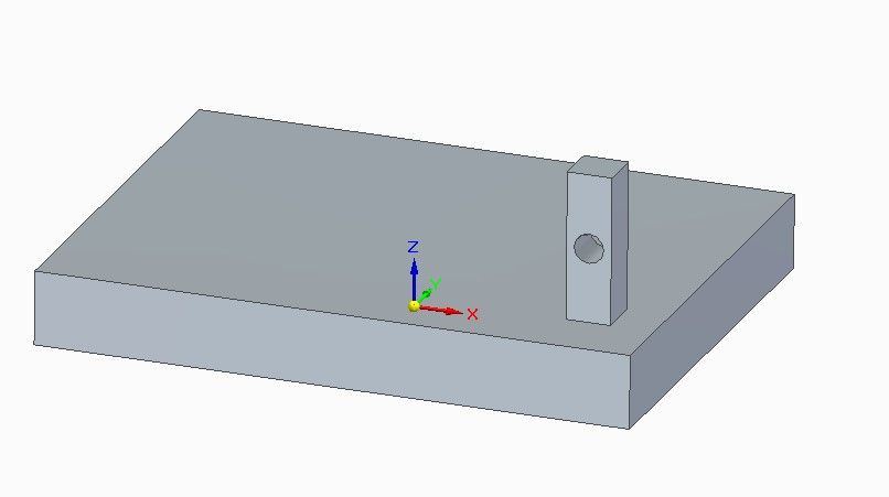

                                  #615148
                                    Can you manage pictures Nigel? WindowKey-Shift-S should open a screenshot tool which can save jpgs.
                                    I guess you have an object like this:
                                    And want to copy the post with a hole in it. First select the feature to be copied:
                                    Note the Pattern tools are now activated. These do various ways of copying features in pattern but the most commonly used are within a rectangle or around a circle. I chose the rectangle option:
                                    When the tool starts, it waits for the operator to move the mouse to select the copy reference point (yellow dots and wheel) and then the area within which to feature will be copied (red dots). I set the dialog box to show I wanted 6 by 4 objects. This is the first button in the tool bar. The other two allow unwanted copies to be suppressed. Clicking on green suppresses it, clicking on red makes it reappear:
                                    Is that the 'copy' part explained? I'm not sure what the other problems are without a screenshot.
                                    I find SE quite fiddly at times, and it took me several attempts to get the pattern tools to work. Logical enough when I finally 'got-it', but not quite how I expected it to work on first contact.
