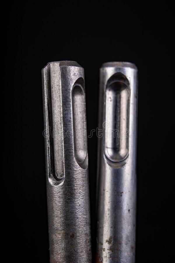

      Ok, a simple question. Well, I could have put "a silly question"! But anyway, I keep seeing, and reading, about SDS drills. But not having one, I don't know what they are, or what they do. I think I understand that they are some sort of hammer drill, in which case what advantage do they offer over my trusty 40+ year old 400W B&D 2-speed mechanical gearbox plus electronic speed control and hammer function?
      I should point out that I have no intention of buying one – my days of drilling stone/concrete/whatever are well and truly over so it's for information only.
      Incidently, said B&D on low speed, if it jams, is quite capable of twisting through 90 degrees with a consequent strain on the arm, and this does make me wonder if in fact now that advancing years are taking their toll, if in fact it could just be getting a mite too powerful for this septuagenarian. Do other people have strength problems like this?

        ega
          @ega
          German abbreviation for something like "push, twist, fixed"

            Well, I don't have an SDS drill but I do have some SDS drill 'bits'.
            SDS Drills are obviously a "hammer" action drill but they also use a particular type of drill shank. It has slots in it, so I'd guess they are a feature of the SDS drill chucks too. I've used SDS bits in my Bosch (heavy duty) drill (in hammer mode) because I needed a longer drill and a certain size. I don't know where I got them from but they worked fine – although I'm sure it's not ideal in theory. I'll guess that the slots are to hold the bit more securely (presumably there's a matching feature in the chuck) given the vibration of the hammering rotation involved. It would stop the drill bit rotating in the chuck as can happen with a plain shank.

              The SDS arrangement for attaching bits to the drill eliminates the heavy conventional chuck – so the hammer action isn't wasted trying to accelerate that additional chunk of metal. That should mean it transfers energy more efficiently into breaking concreate/masonry.
              Also quicker to change bits.
              Some SDS drills have a 'rotation stop' option – these can be used with chisel bits.

                      Over simplifying SDS is basically a specification for a fixed diameter shank with a sliding key drive.
                      The key turns the drill and the hammer unit inside bonks the blunt end of the drill. The drill is free to slide up and down the key for a short distance arranged to be greater than the hammer device stroke so the hammer force is transmitted to the work not the drill innards.
                      The common issue when using a chuck on a hammer action drill is self loosening under vibration. A particular problem with the keyless types used on battery drills. My otherwise excellent Makita 18V drill suffers badly. Best to check the chuck tightness every second or third hole. I'd be unsurprised to discover that extensive use in hammer mode seriously reduces the lifespan of the chuck.

                                            SDS drills have key ways in them so that they can slide in and out whilst being rotated. I think the name was penned by Bosch originally.
                                            The reason why this arrangement is used is that the drill hammer action is different and much more effective than a normal ratchet type of hammer drill using a standard Chuck. The hammer action is almost universally pneumatic, meaning a lump of steel is thrown against the back of the drill (almost) by compressed air using a piston and cylinder. The frequency of strike is low, but the energy is huge.
                                            Ratchet hammer action, by contrast, is accomplished by having the whole spindle, drill bit and chuck move backwards and forwards 40 (ish) times every revolution by a small amount. These are normally good enough, and cheap and simple. But performance and cost is much less than a pneumatic hammer drill.
