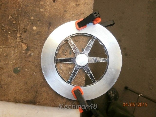

                                    Interesting info guys, I used a piercing saw for a flywheel, 3mm x 150mm aluminium, for one of my models, thought of getting a scroll saw but couldn't justify the expense at the time, reading you comments… still debateable ?… oddly enough was looking at the Chinese models in MMart last week … vat free day offer…?
                                    ​Cutting out flywheel with piercing saw, tedious, & a couple of broken blades along the way, told me… slowly, slowly catchee monkey..
                                    ​George.

                                      George. If you used a piercing saw on the flywheel as shown in the above photo, can I suggest that you don't clamp it down whilst doing it
                                      Roy

                                        Ta! noted for future ref.
                                        Geo.

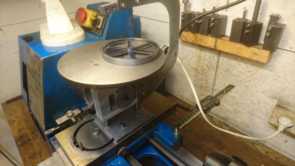

                                            Hello Folks
                                            Soon Neil will recieve my article on building a scroll saw attachment for a small lathe
                                            Scroll Saw attachment
                                            regards
                                            Mogens
                                            Edited By Mogens Kilde on 12/04/2017 21:46:22
